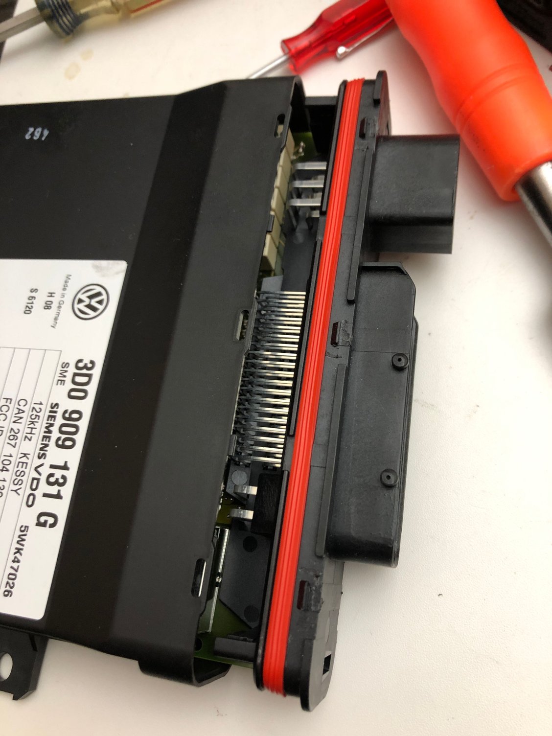

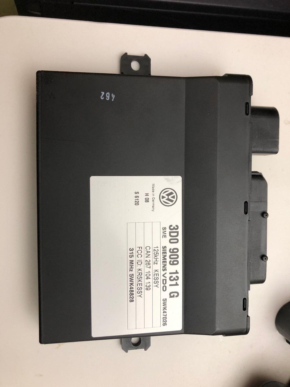

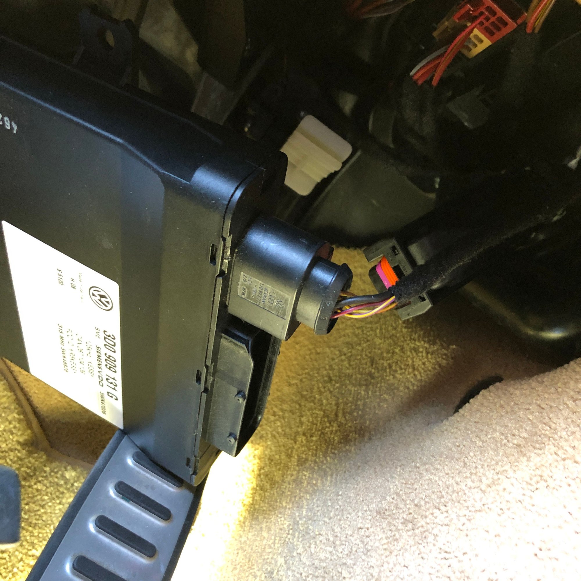

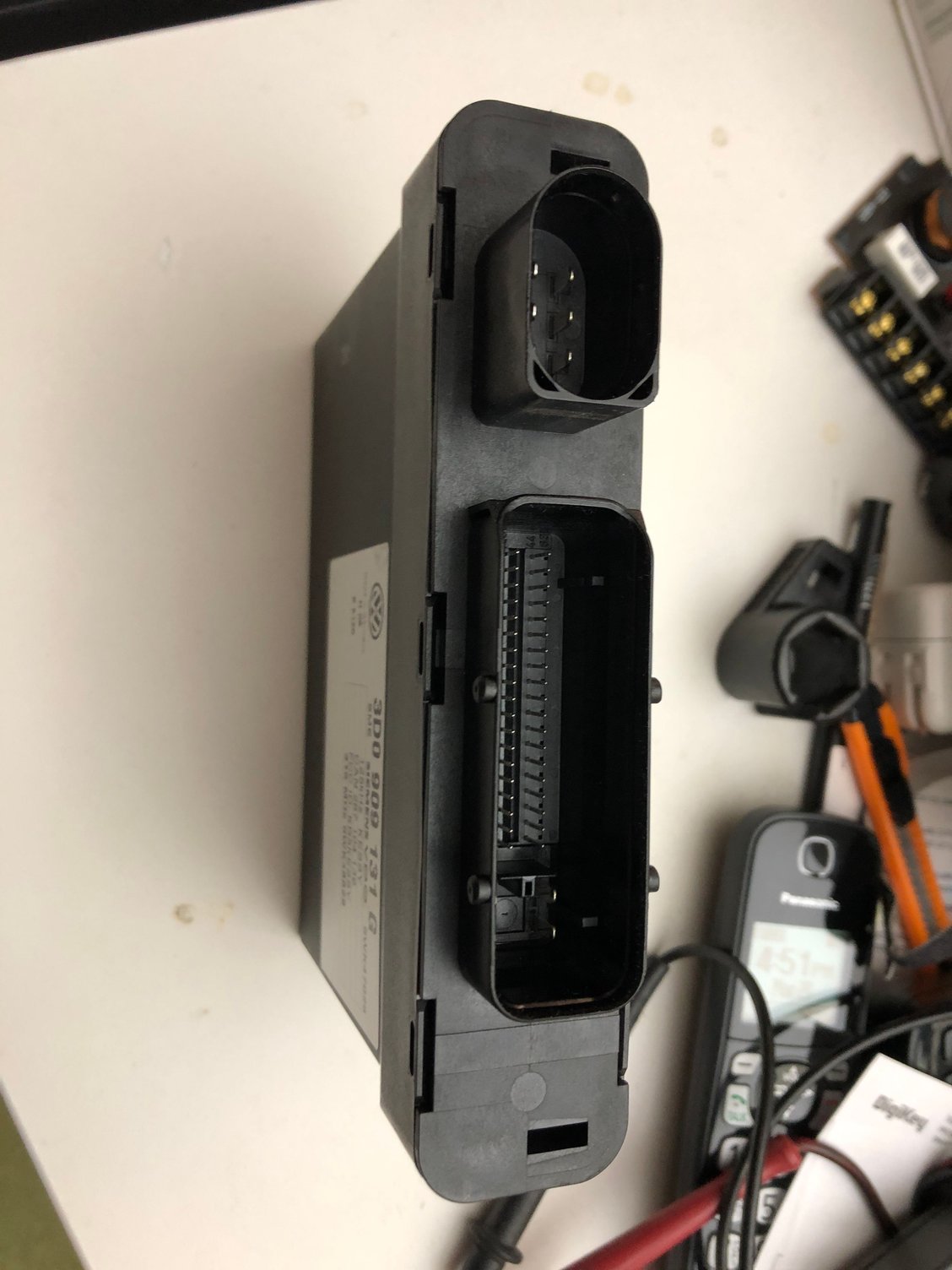

The link has a good picture and description of where the module is and how to get it out, so I'll start from there with it out of the car.
Everyone likes a fun puzzle. I tried not to butcher it while cracking it open.

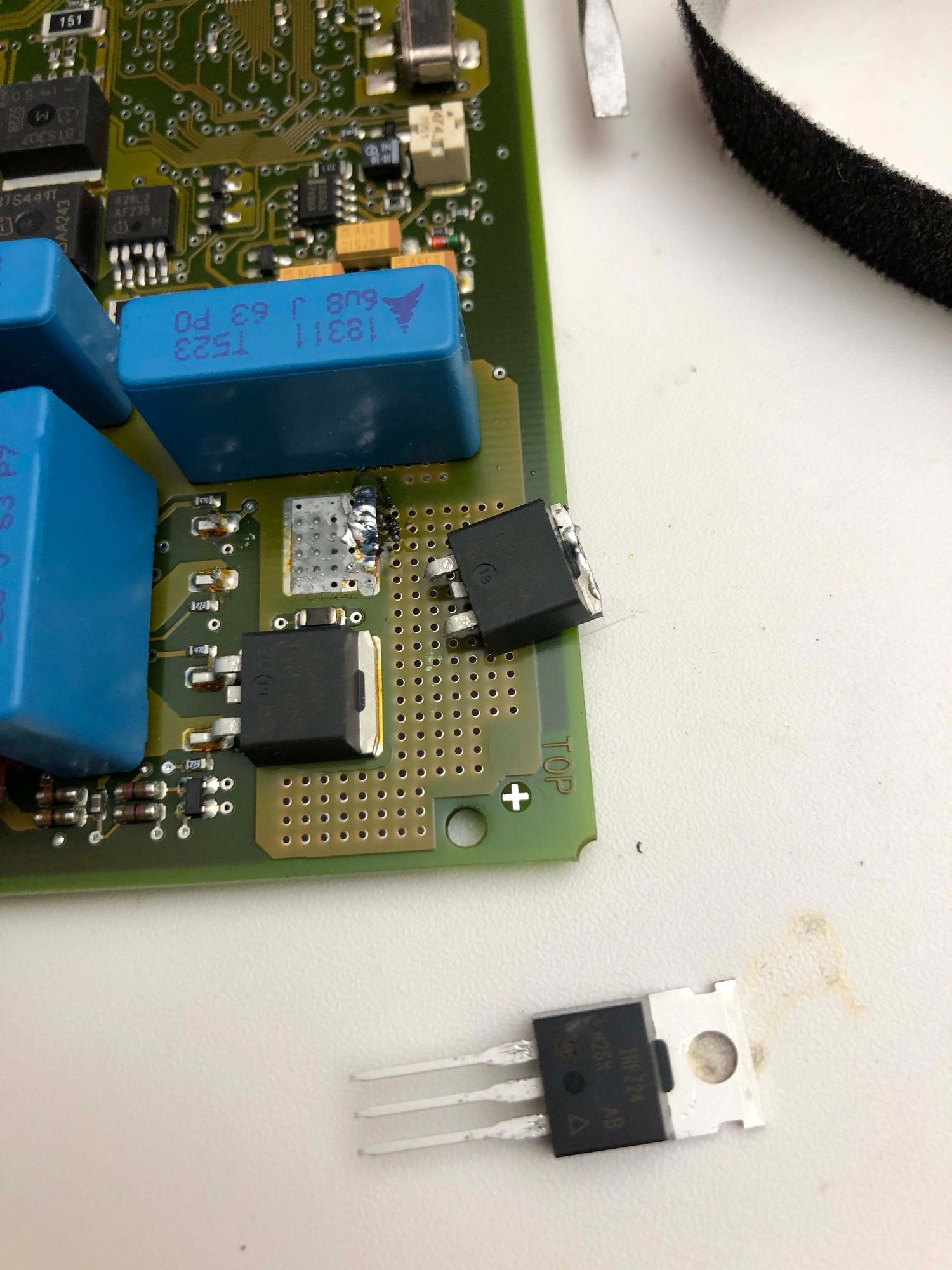

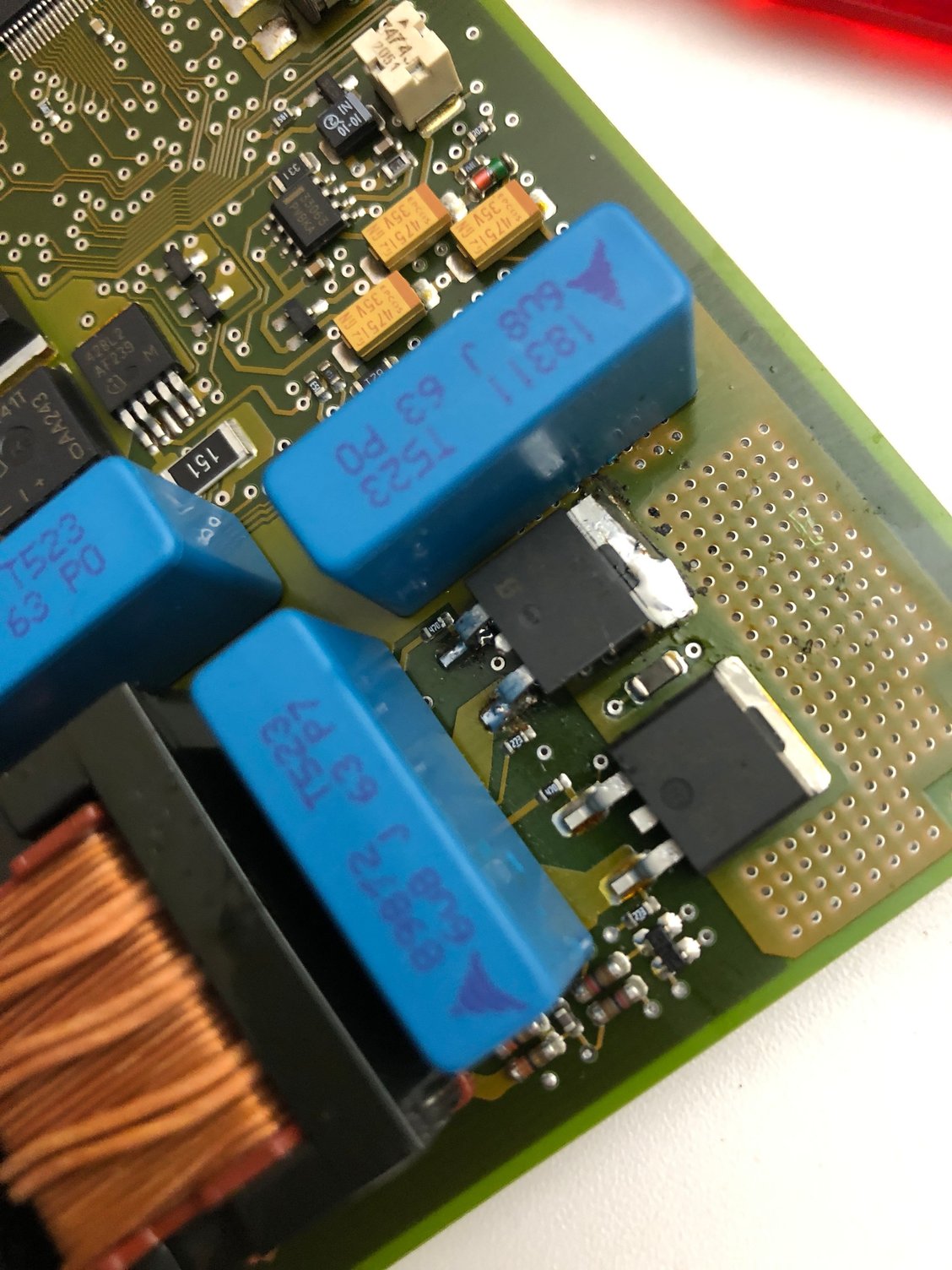

So you can use the diode checker function of your meter to test these, but I like to use just the ohm meter when I have a new part for comparison.
My MOSFET on the right checked out ok. You should read around 3 Megaohms across the two outer legs regardless of your probe polarity.
The one on the left measured around 10k.
You usually can't go by readings when a part is still in the circuit, but due to the symmetry of these circuits, I was hopeful that the 10k would remain across the transistor even with it removed.

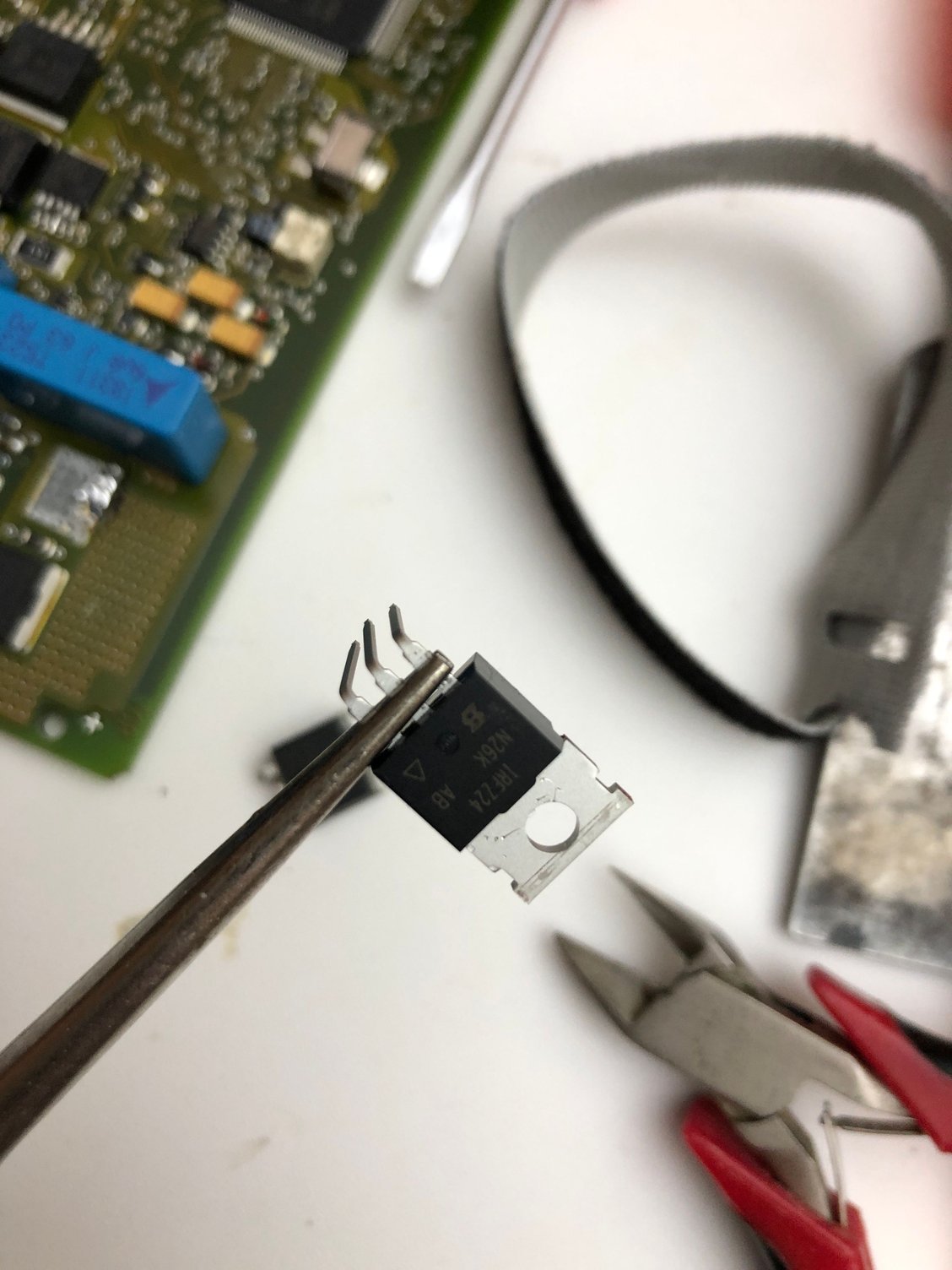

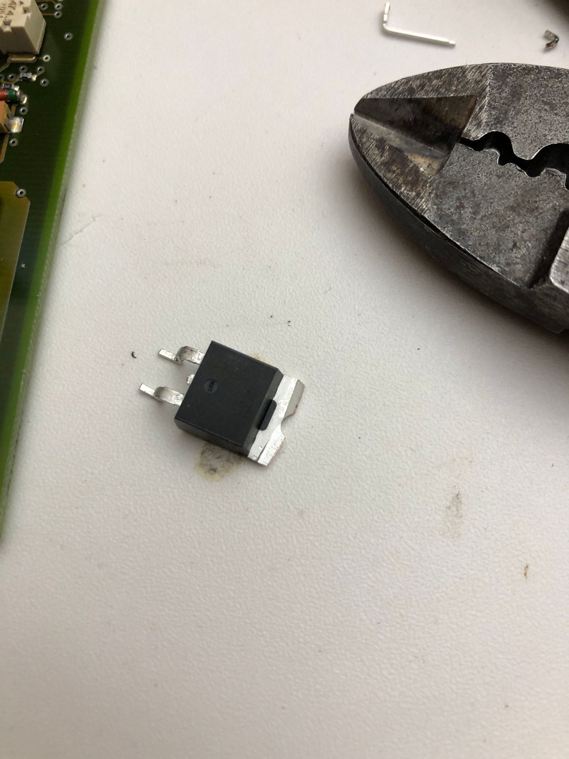

I cut the two legs with small dikes and then used a regular soldering iron to heat up the heat sink (which is also the "drain"). I did this while gently prying it with a tiny screwdriver.
To get good thermal conductivity, you have to add some fresh solder to bridge the gap between the iron and the little bit of solder reachable at the edge.
Once removed, I was thrilled to find the 10k (bad) was still there.
I had to trim the heat sink. I used my large crimp tool cutters.
You also have to bend the legs of course. And trim the middle leg.
It's not exactly trivial to do this properly. I won't go too much into the details, but the correct way to do this would be with solder paste and a heat gun (surface mount rework tool).
But this is tricky since you can melt the stuff in the vicinity.
I tinned the bottom of the heat sink and heated up the pad real good, then positioned the part and tried to get a good connection as flush as I could.
Then (with the remnants of the cut legs removed) made sure I got a good joint on the gate and source.
Cleaned up with some alcohol and all done.

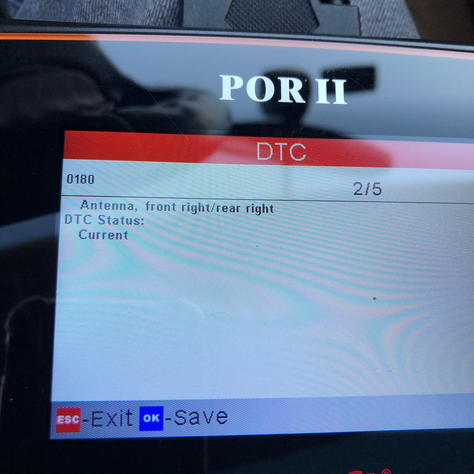

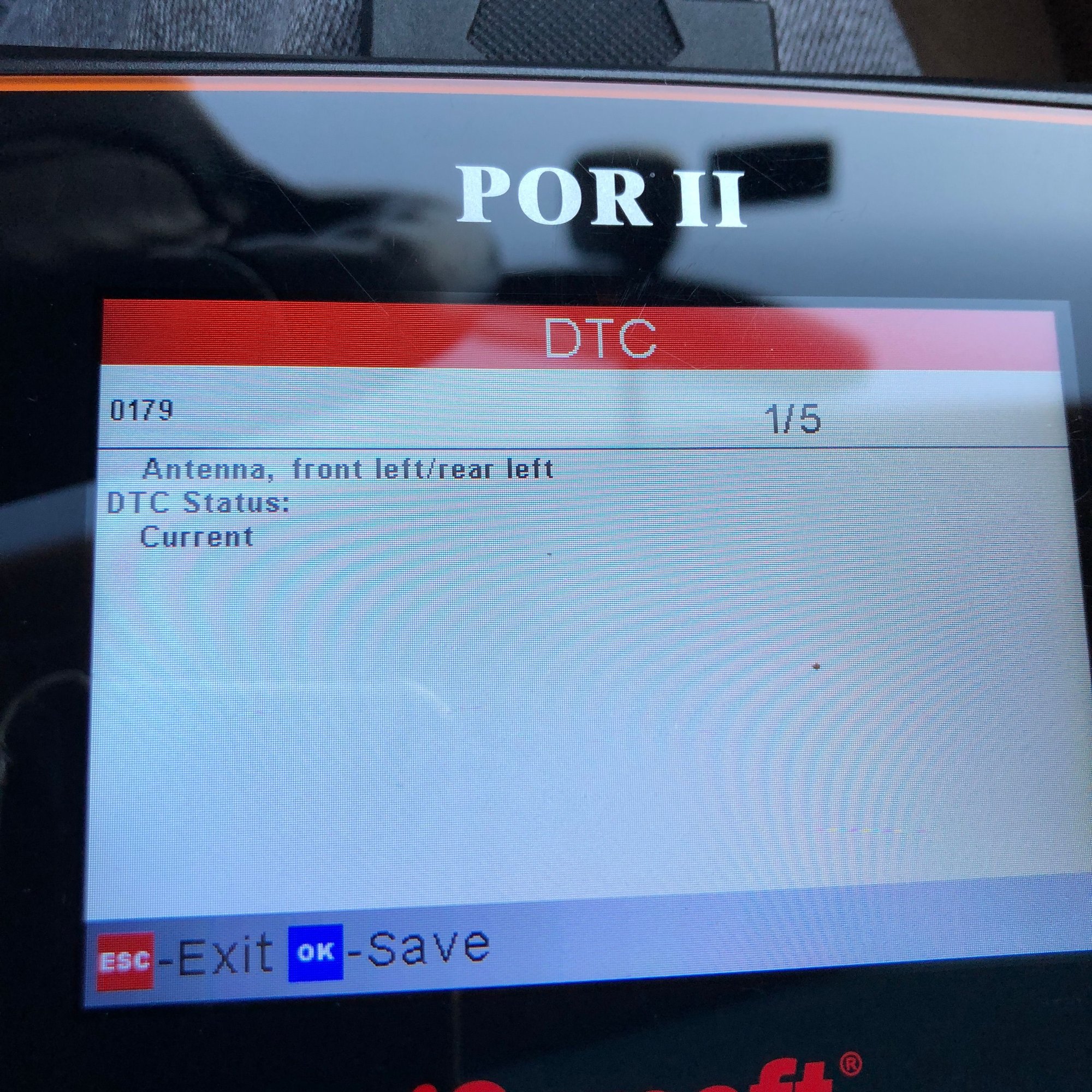

These were the faults I had before attempting to reset. (There are two extra that were due to me disconnecting the module with the power still on so they don't count).
I reset and they did not come back.

That actual package for the fet appears to be a TO-263 D2PAK which would be an IRFZ24SPBF part.
Old Mar 30, 2024 | 05:12 PM
thesteve's Avatar
thesteve
Joined: Mar 2018
Posts: 1,310
Likes: 246
From: Central New Jersey
Good deal. Makes sense. I added that info above.

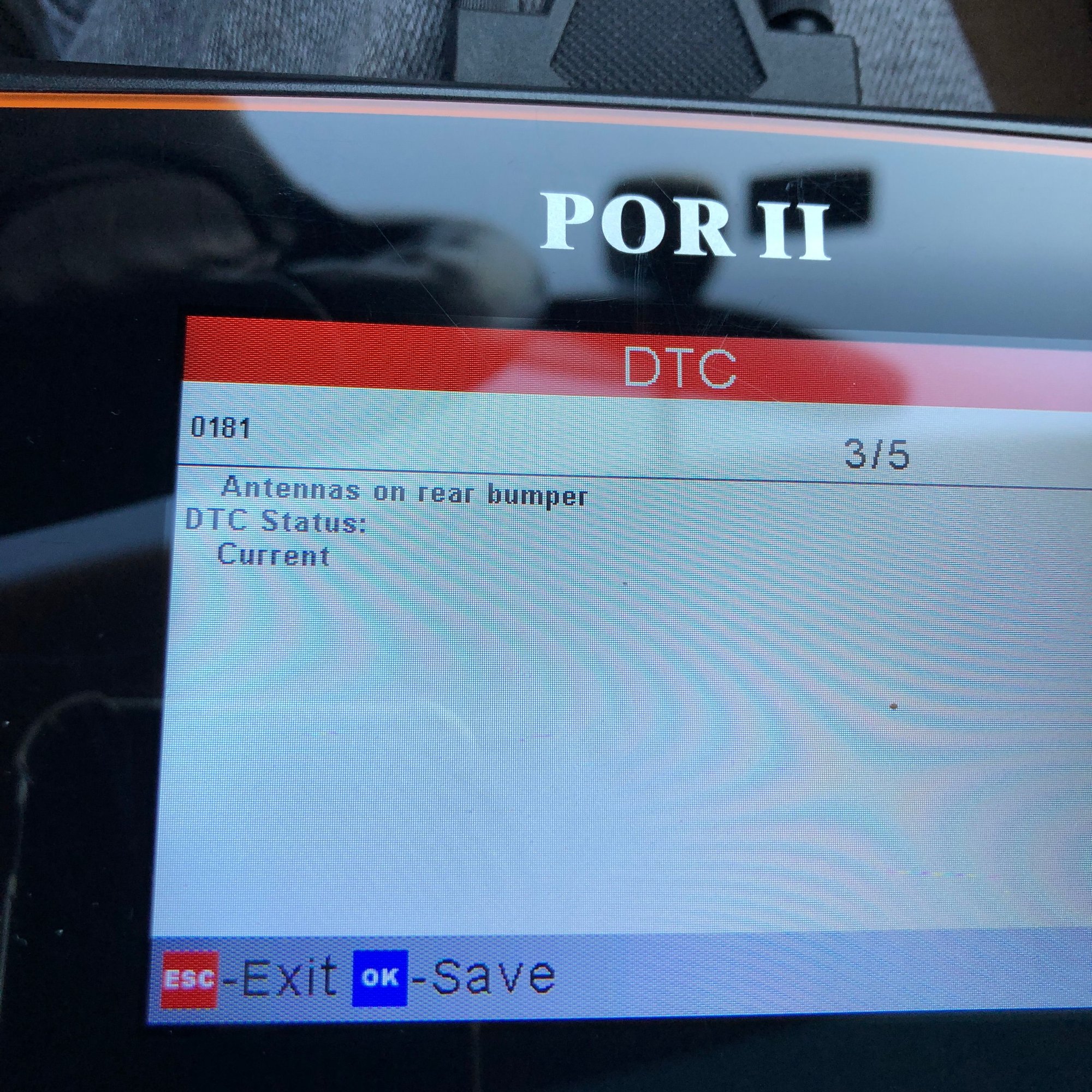

So everything worked for I think it was 2 days. Then it started to fail in two stages.
First it would do the thing where it would insist on re-unlocking every time I tried to lock and walk away.
While it was in this stage, it only showed the rear bumper antennas as faulty.
(I remember years ago when the problem first started, it was only the rear antenna fault that kept coming back initially.)
Within a day or two everything returned to square one, with all of the exterior antennas showing open and no range on the key remote.

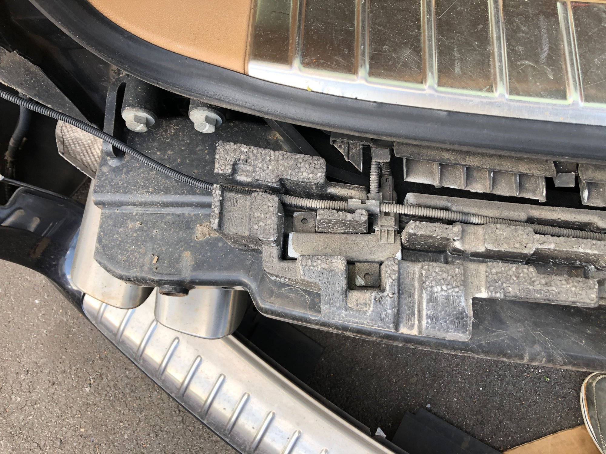

But before replacing the transistors I ordered a used rear bumper antenna from eBay for $12.
After getting the bumper off I measured both of my antennas. The left one (that I suspected) measured 10 ohms and the right one measured 4, the same as the eBay one.
I would have thought that the bad antenna would have measured lower, but my results jived with one other person's experience from a Touareg board.

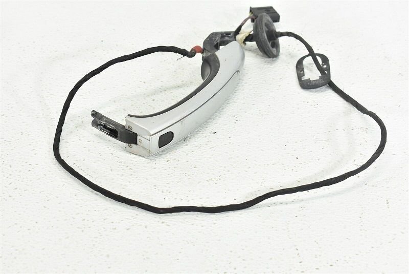

Oh and to make things worse, I never mentioned the thumb buttons to lock on the door handles still don't work.
But it looks like this is a separate issue. I think it may be one of them is shorted.
I ordered one from a junkyard yesterday.
I have a hunch the problem is the left rear, as it's been acting strange lately. Someone else here has the same issue where it sometimes tries to lock itself 3 times in a row instead of just once.
And before the repair, occasionally the same door would remain unlocked after securing the alarm.
Maybe this is a micro-switch issue I've heard of though...(?)
I'll report back if/when I ever fix the lock with your thumb problem. Not a big deal though as long as the MOSFET repair holds and I can use my remote.

Good info, again! My car also has partially working lock buttons on the handles (I think 3/4 or 2/4 work usually). Also, I can’t unlock by placing my hand on the handle. I have to pull it a few times and then it will unlock. Is that an issue with your car as well?

If I recall correctly, I always have to give a first futile pull before the doors unlock, but at least now all four doors will open this way.
I know I'm getting warmer, but still have some problems. The good thing is, no faults have returned and my remote still works.

I'm also getting warmer with my thumb button push to lock issue.

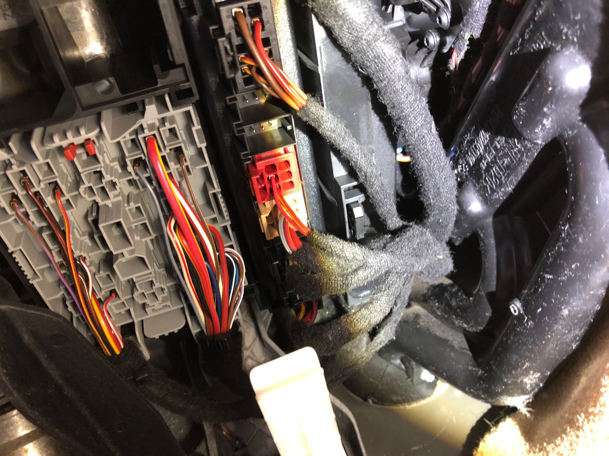

I found a post where a guy explains that there are some splices on the right side of the car, back further, that I may have missed.
These screw up the function of the rear comfort module. I occasionally lose all communication to that module until I reset it. The symptoms sound like my issue.
Here is that link. The English is not so good, but it's great info.
https://rennlist.com/forums/cayenne-...oth-sides.html

The KESSY swaps fixed all my thumb button and keyless entry issues. I can't offer much help here, but if one system is out of whack on the CAN-Comfort then the whole system tends to fault. Look at the wiring diagrams and try and identify an area where all of your issues seems to converge. For me, every fault centered around, or involved, the rear comfort control module. Turns out I had a faulty unit which in turn shut down other items which relied upon the unit. You could have a bad ground that needs cleaning, or a loose splice, but definitely give the diagrams a look.

Mine is kinda weird, as I have similar symptoms but no fault codes. I’m hoping an easy to find bad splice or a dying mosfet is the culprit, but it’s harder to pinpoint without a fault code.

I never had any luck diagnosing with Durametric. I replaced the mosfets based on what I read on the forums. It worked. This time round I also replaced the rear antennas as my rear hatch had stopped working after I refreshed the mosfets. I subscribe to the phylosophy that the more components that are failed the more out of whack the system(s) get. So I try and stay on top of it. Replacing the fets and the antennas has the system working again. Both my rear door handles unlock ok, but don’t lock. That is a persistent 15 year old problem. I’ll work on that next.
