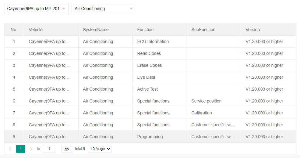

I have a question. I have a 2006 955 and the climate control flaps are clapping on startup for a few minutes. Do you know or do you remember (you don't seem to have a 955 anymore) if this scanner can reset the flaps? I am having problem with this and I believe that a scanner purchase will be way cheaper than a dealer flap reset.

I haven't really looked into this since I no longer own a 955.. but - the iCarScan X431 can actuate the flaps on my '11 958, and as I mentioned - it seems they're sharing the reverse-engineered PIWIS software between various Chinese manufacturers, so I'd expect the Foxwell CAN do it. If you go to Foxwell's website, there is a spreadsheet that tells you what it will do for each model it covers. That can be found at: https://www.foxwelltool.com/ - look for the menu selection "Function List" up near the top of the page.
Here is what it says on "Air Conditioning":
Active test should do it for you. And if it's like the iCarScan - the "Calibration" teaches the system which stepper motor (actuator) is which by running each one.
