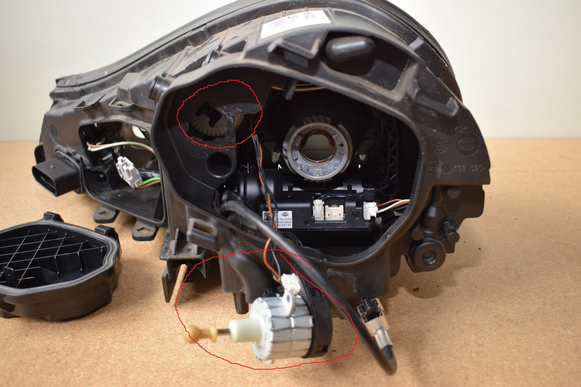

The motor and the hole where it goes are circled in red below. Not sure what the best way to test it - either swap left to right, or check with multimeter whether the motor is getting power. Looks like there are 3 wires going to it, I'm guessing brown is ground and 2 blacks are power, either up or down. Voltage is most likely 12v, but could be 5v or 24v, so if you wanted to give it power to test motor directly I'd start at 5v.

My CTT is an HID 2005 - 955. Your headlight looks like for 957 models.

It is 957 indeed. Should be similar, maybe? IDK, have not had a 955 myself, take a look.

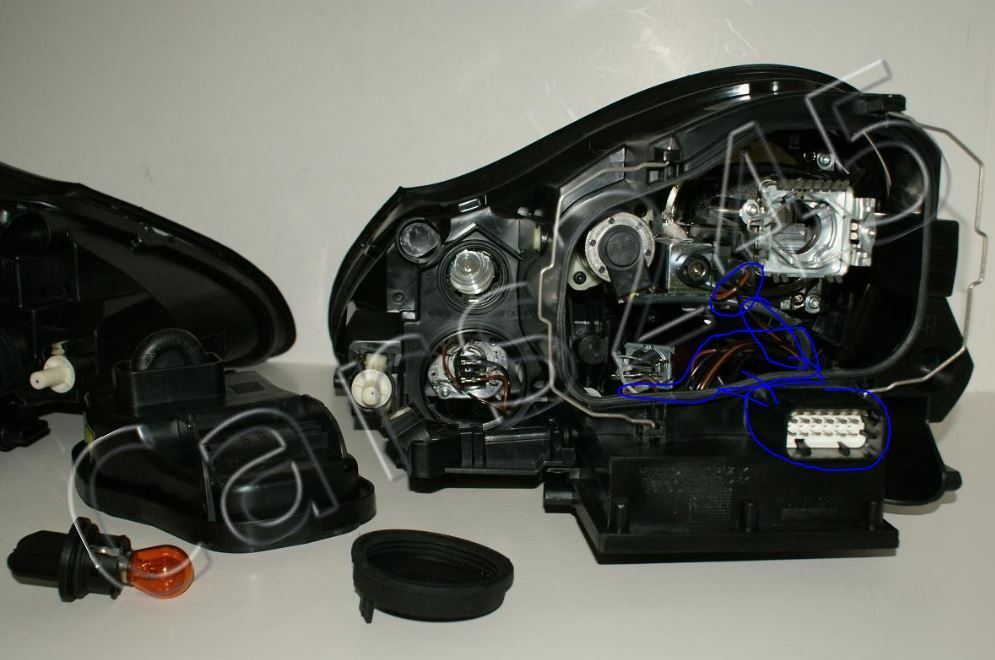

Looks different...
955 looks like this inside...

Different indeed. But, that thing in the top middle looks like the motor you need to test, it's just bigger.
