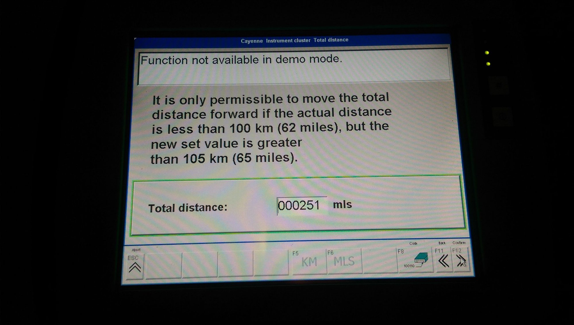

That's not true. And most dealers don't even know how to work their own software. I remember reading either in my PIWIS tech updates or the FSM that the cluster must be between like 15 and 65 miles showing to accept the programming of the new mileage. I'm sure this is to prevent fraud and if you were to order a new cluster it would come ready to be programmed by the dealer. I can look in my PIWIS software later and show you the workflow with some screenshots.

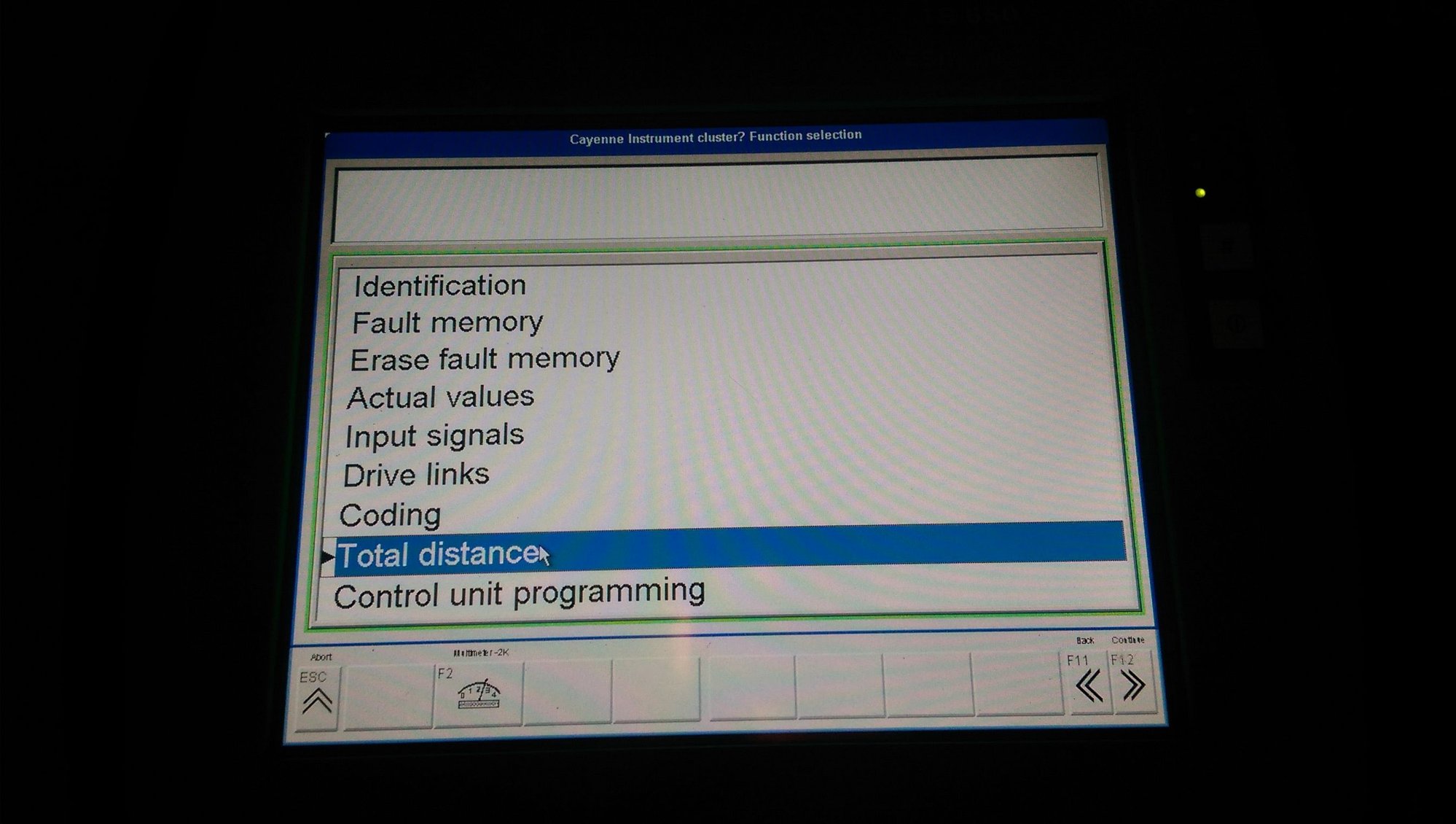

Honestly this is a huge legal issue and a bug that PCNA should be willing to rectify for free. I would reach out before I spent a dime. When I first got my software I thought oh wow, I can just roll my odometer back. No, it doesnt work like that. I'm going to try and find the tech data for you Jeff.
Old Dec 30, 2017 | 10:03 PM
J'sWorld's Avatar
J'sWorld
Joined: May 2014
Posts: 1,768
Likes: 192
This should clear things up.
