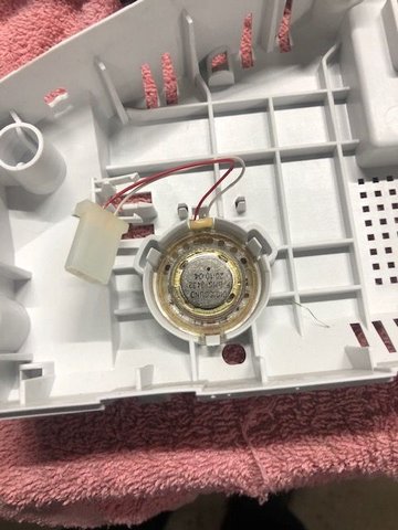

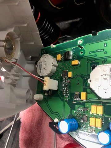

So as a further update. I pulled my cluster to replace the speaker (easy job BTW) and I thought, hmmmm, lets test the battery theory. So I disconnected the negative, waited a few minutes (10-15) while getting coffee. Came back and hooked up negative. Center display says service now and odometer flashes alternately errOr and the mileage. Trip meter is blank. So, apparently my cluster has an issue or they are just made of tissue paper. I ordered an odometer reset tool that can force a mileage into both registers. We will see if this works, if not, I'll have the cluster rebuilt. At least now I know how easy it is to get out.

Wow just wow. I agree that should be on PCNA to fix IMO.
Thanks for the cluster removal info as well! Hopefully knowledge I will not have to use
