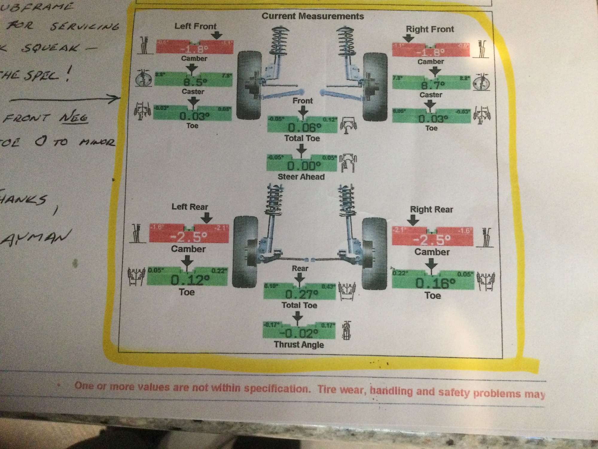

981 GTS with X73 alignment sheet. Only change made to this over 4 years was hair toe out in front. You may not like Falkens the first time out on them. Second time they will be great. BTW, 19 inch wheels/tires are cheaper than 20 inch and help acceleration (gearing) and cornering (lower CG).
