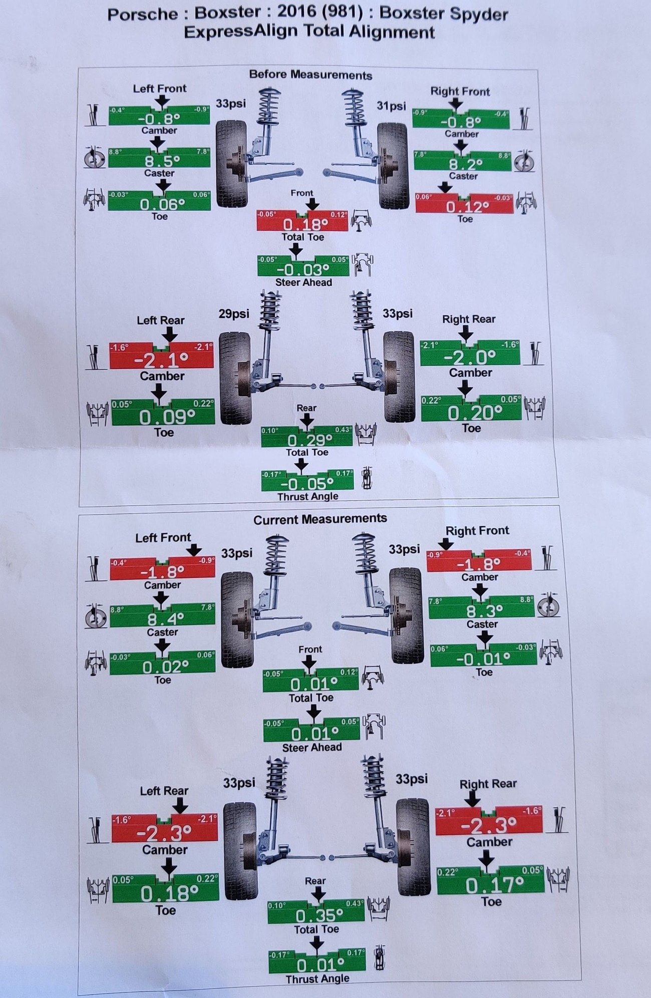

I read every thread I could find on the X73 and alignment on the 981. Best advice I was given was to max out the Rear camber, and make the front 0.5 less. I also found the "Max 1.6 Front and 2.0 Rear" without modification not to be the case. Maybe the Spyder has something different in it's X73 suspension. I'll post back how this alignment feels after my next autocross. On paper it looks good. My configuration below with factory stock suspension, with stock 20's:

Less front camber than you can achieve (within reason) is not normally advisable for autocross. If you can get more, I'd take more. -2.0 for the rear is probably a good place to be though.

Follow-up report.
Alignment seems right. Autocross performance is great and the wear is even on the P4S. After four events car and driver were competitive. Better turn in and ultimate grip. It feels great. I recommend it for the purpose.
