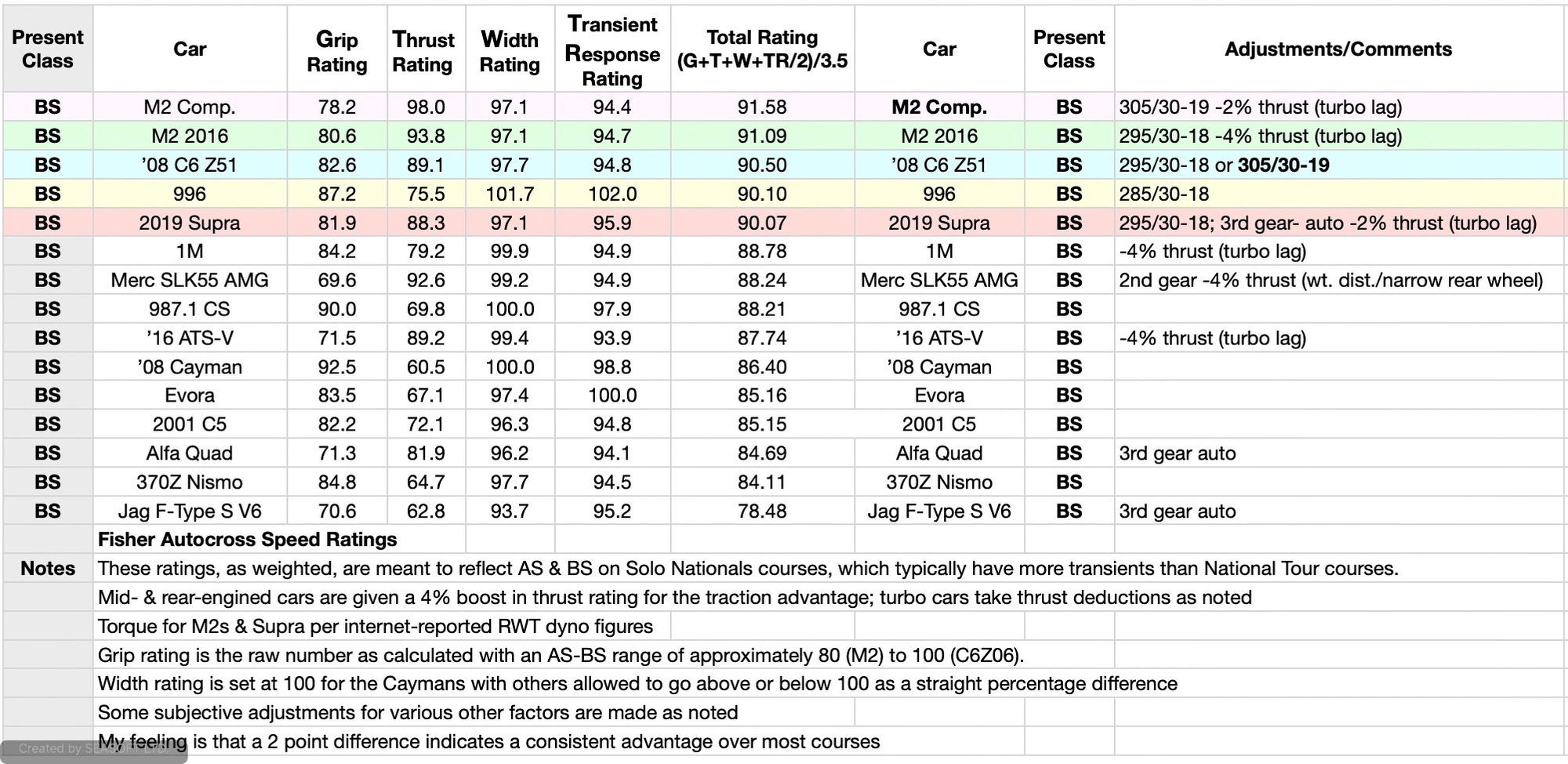

I'm just going to leave this right here...
...and it appears that it may well be that not one of the trophy winners in BS last year at Nats will be back in the class.

How does the 996 have that high of a grip rating? I think it's a good move (as would be 997.1, IMO), but that seems high considering the front tire and camber limitations.

Since the Macan is also in BS, how about adding the model years 2021 and 2022 GTS to the table?

My grip rating is simply weight divided by the sum of the front and rear rim widths. The 996 is by far the lightest of the top 5 in that list but has good rim width with 8s & 10s.
I don't take into account camber capability, nor what tires might actually be fit on the rims or might fit within the space available or might actually be available. That's all way too difficult to figure out for every car. (I do have to choose a rear tire diameter in order to calculate thrust.) I've never found a justifiable way to relate camber capability to cornering capability, for that matter. It's not that I don't think it's a real thing, just that there is no way to generically use it... too much variation from one design to another. Just like Mcpherson struts... we all know they are an undesirable design in a race car, no matter the static camber available, but how much do they really detract from cornering in the real world, 996 vs. Corvette, for instance? Beats me. Too many variables.
The fact that the 996 only has an 8" front rim might seem to justify some sort of special knockdown, except that it has so much less weight on the front that you can make the counter argument that 996 rim widths are more appropriate to the weight distribution than all the other cars when it comes to cornering grip and therefore has an advantage. At one time I actually used a more complicated calculation for grip based on rim size and weight distribution, but it didn't seem to predict anything more accurately so I dropped it.

Once I get some time.
I see that it's over 4400lbs and on 9's & 10's, right? It won't rate well even if we forget about the high CG. Its grip and transient response rating will be very poor. I assume its several inches wider than these others as well. It may be the sportiest of all SUVs, but it's no winning autocrosser.

Is your 997.1 assuming the widest option widths of 8.5" and 11.5" or the most typical 8" and 11"? The reason I poke at that is real world, the Vettes have more grip due to 1) double wishbone front end, giving and 2) more camber adjustability, at least up front. I've yet to be rear grip limited on my 997 but in any slower, >90 deg corners the front is quickly the limit. It should improve some this year going to 255 fronts versus 235 but it'll still retain the light front end traits and thus sweeper & turnaround grip limitations.
As always, the data, number crunches and summary is always appreciated.

Don't forget the '21 Supra is in BS now too. Seems like it should be a similar case to the M2 / M2C where the numbers look impressive on paper, but the delivery and rev range don't translate to a huge gap in the real world. The improved suspension tuning is a far bigger concern, plus there's no way Toyota is "done" with that car. It'll get better every model year, announced changes or not.
My gut rank is OG M2, followed closely and pretty evenly by the Supra / M2C / Z51. I think the Evora is still in the mix on transition heavy courses. I think the rest is filler.
That Z51 scares me. Someone good, prepping a post-refresh car, and doing well with it could do some damage, which IMO would hurt the class. Perception is so important and AXers are sheep. Hope is the 8.5s up front hold it back just enough.
Consider adding the 2023 Nissan Z:
400hp/350lb-ft
9.5F/10R
Rest should be similar to the 370Z Nismo you already have in there, it's the same chassis:
100.4 wheelbase
Similar width
Maybe add 75lb for the turbo plumbing over the 370

It's getting harder to find Porsche data these days, I think because of Porsche tightening restrictions on their order guides.
For the 997.1 I used 8 and 11 and for the 997.2 I have 8.5 and 11 as what I found to be the widest wheel sizes. (I always want to use the widest, not the most common, for any car.) Can you point me to data showing the 8.5/11.5 option? And which years it was available?

Carrera Sport wheels were an option from 2005 on RWD and AWD models.
19x8.5 and 19x11.5, option code XRR.

What would be terrible about the Z51 being competitive? Before now it didn’t have a home to be a good platform and there were so many of them built.
On the new Z, I have a bet with a friend on the weight. It'll be over 3500 lbs. The turbos, piping, intercooler, and the additional weight added to other things for robustness/performance with all the added torque and power will add more than 75 lbs. Gearbox, driveline, brakes, mounts, etc will all need a bit of work.

I've always planned to add the new Z when good data was available. Thanks.
A friend just got a '22 Supra and plans to run it this year in BS. I haven't been able to find a good source of info on the suspension changes. I will review the engine dyno info for it and the '21. I found one source that did a back-to-back, same-day test and saw +38hp over the '19. The torque gain was similar.

Thanks. I will update.
