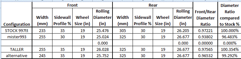

255-325 combo has a smaller rolling diameter difference than the stock 235-305 according to TireRack. Hence I'm looking at 255 front, instead of the safer 245 front.
I'd be worried that the Porsche differential gearing is set up to account for that difference in rolling diameters front to rear.

Don't know if physically possible (or even if desireable) but 255/35-19 F & 325/30-19 R would be almost the same F/R diameter ratio as stock; also don't know if slightly different F/R ratio from stock then would going bigger or smaller be better (less likely to cause drivetrain mechanical failure)? Car would sit 0.25" higher (0.5" tire height increase).

As long as the rolling diameter is the same as stock or very close your will not have problem with abs/traction lights and will not do any damage to your rear diff or final drive

Rolling diameter is whats important because if your diameter is too much of a difference between front and rear it will stress the drive line.
305 on a 12inch wide wheel is a little too small would be better with 315 or 325 but the width of tire is not the issue its the height that is important
