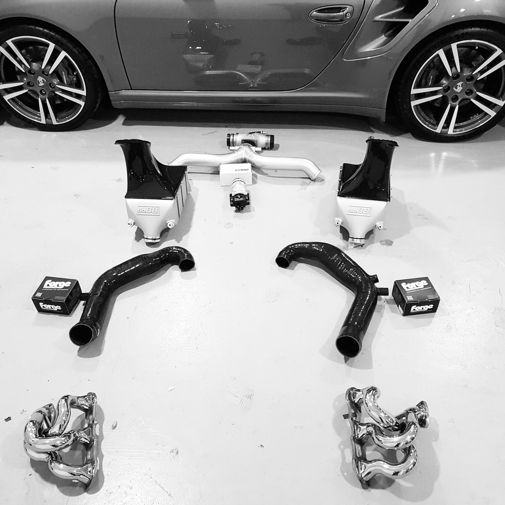

today I have received the following from Emre
1. do88 intercooler, Ypipe and inletpipes kit
2. IPD plenum
3. ESmotor custom headers
4. Aquamist meth kit
5. Cobb 3 bar MAP sensors
6. Forge DVs
7. DSC PASM module
I will be doing the build at home in the coming days and will be updating the thread accordingly

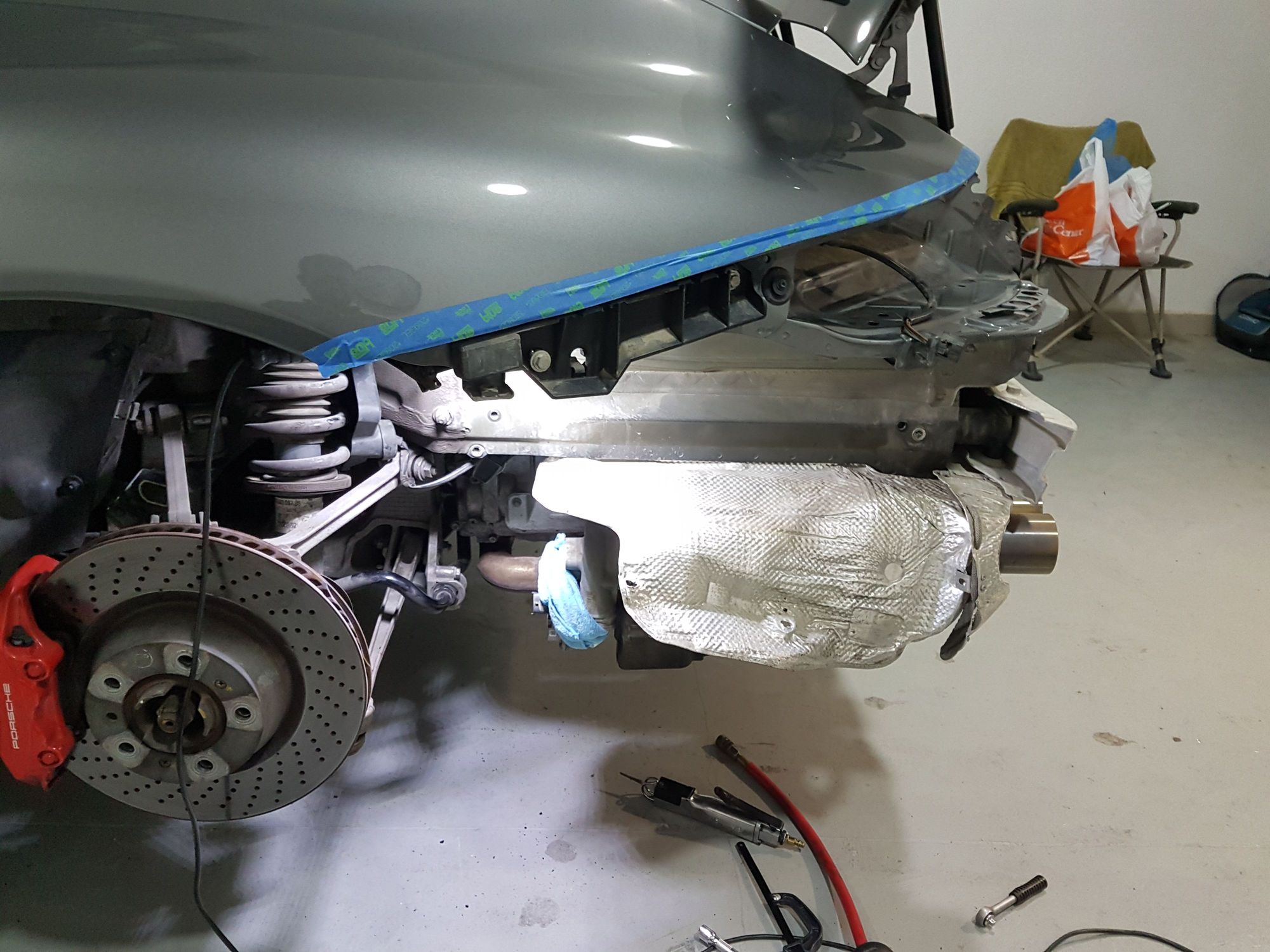

Progress update#1

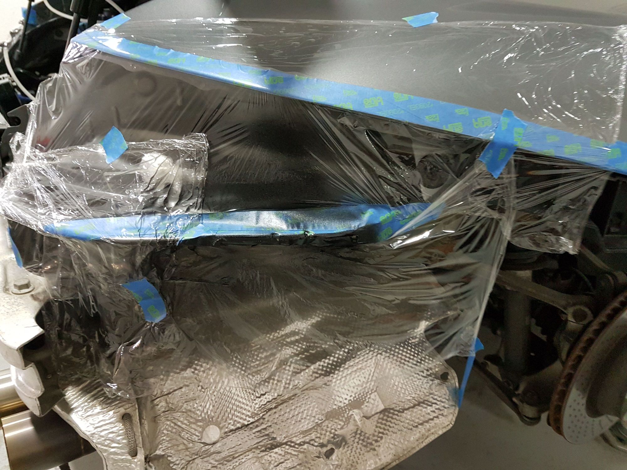

Ok

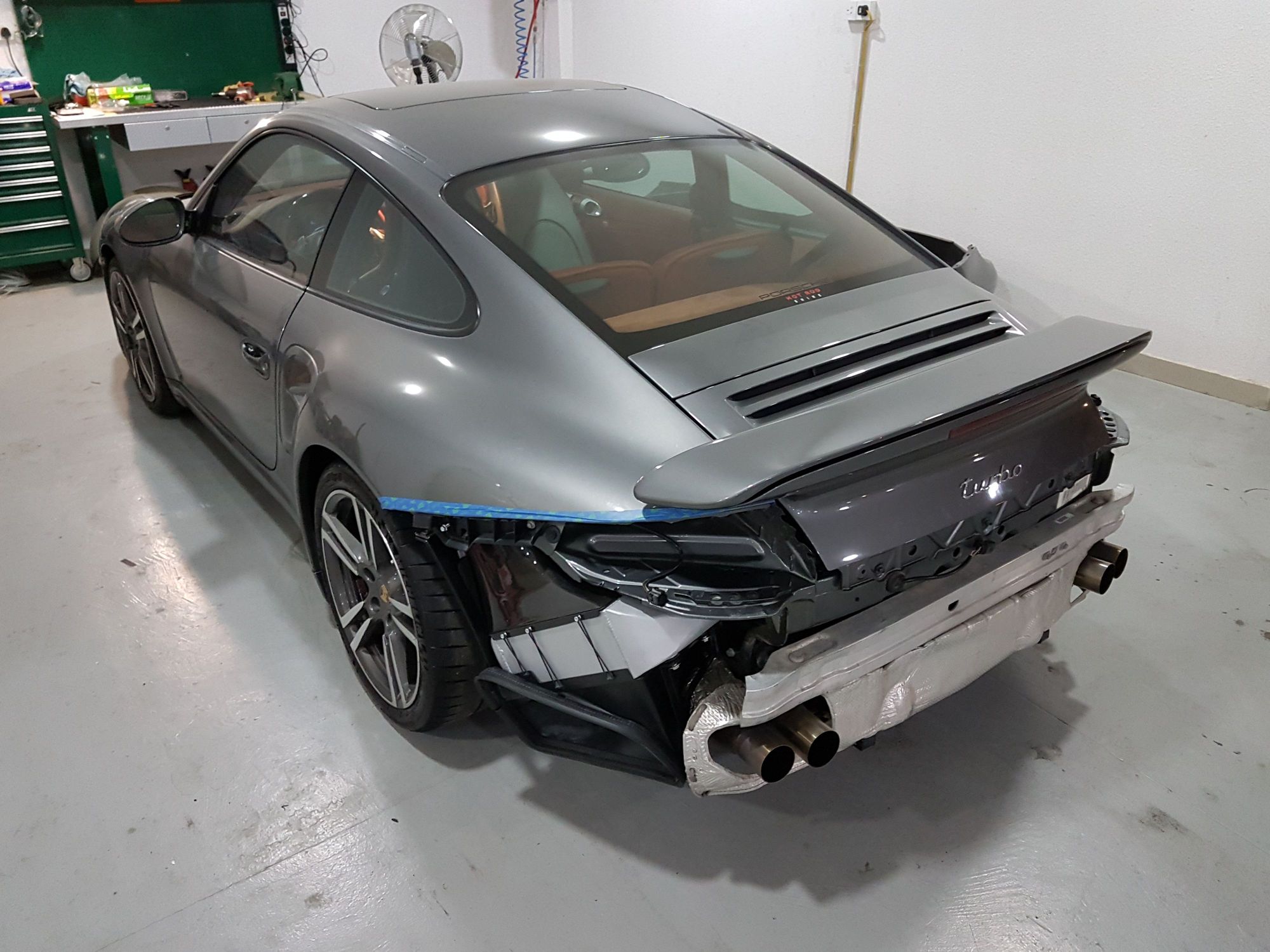

so today I was just warming up .
I'll post few pictures and observations . later on I will update and format properly .

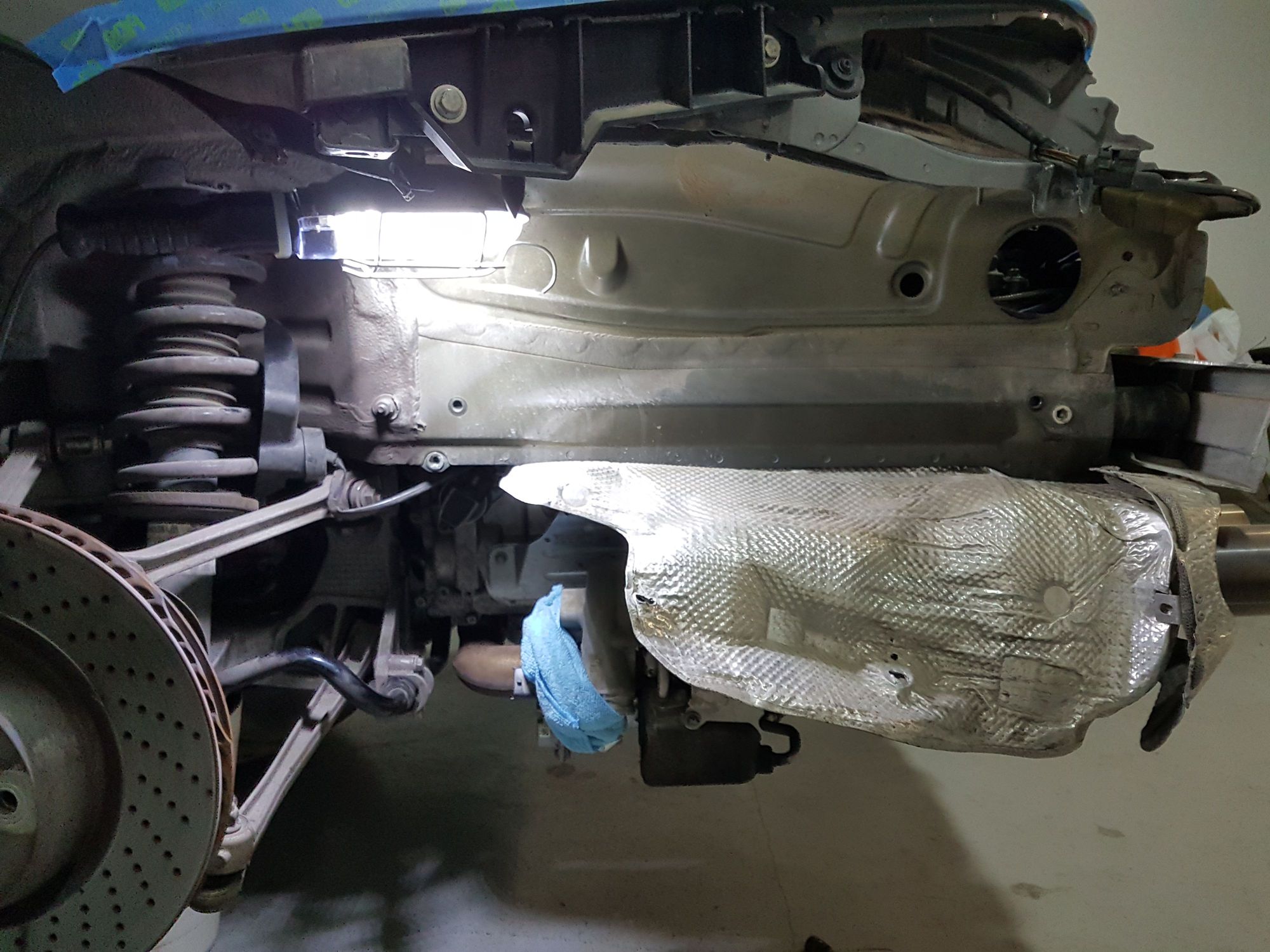

what's done:
1. removed bumper
2. removed airbox
3. removed Ypipe
4. removed throttle body
5. removed plenum
6. removed passenger side exhaust headers

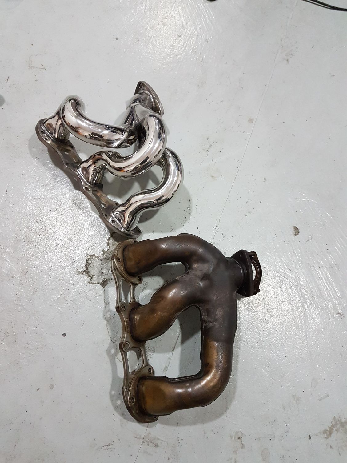

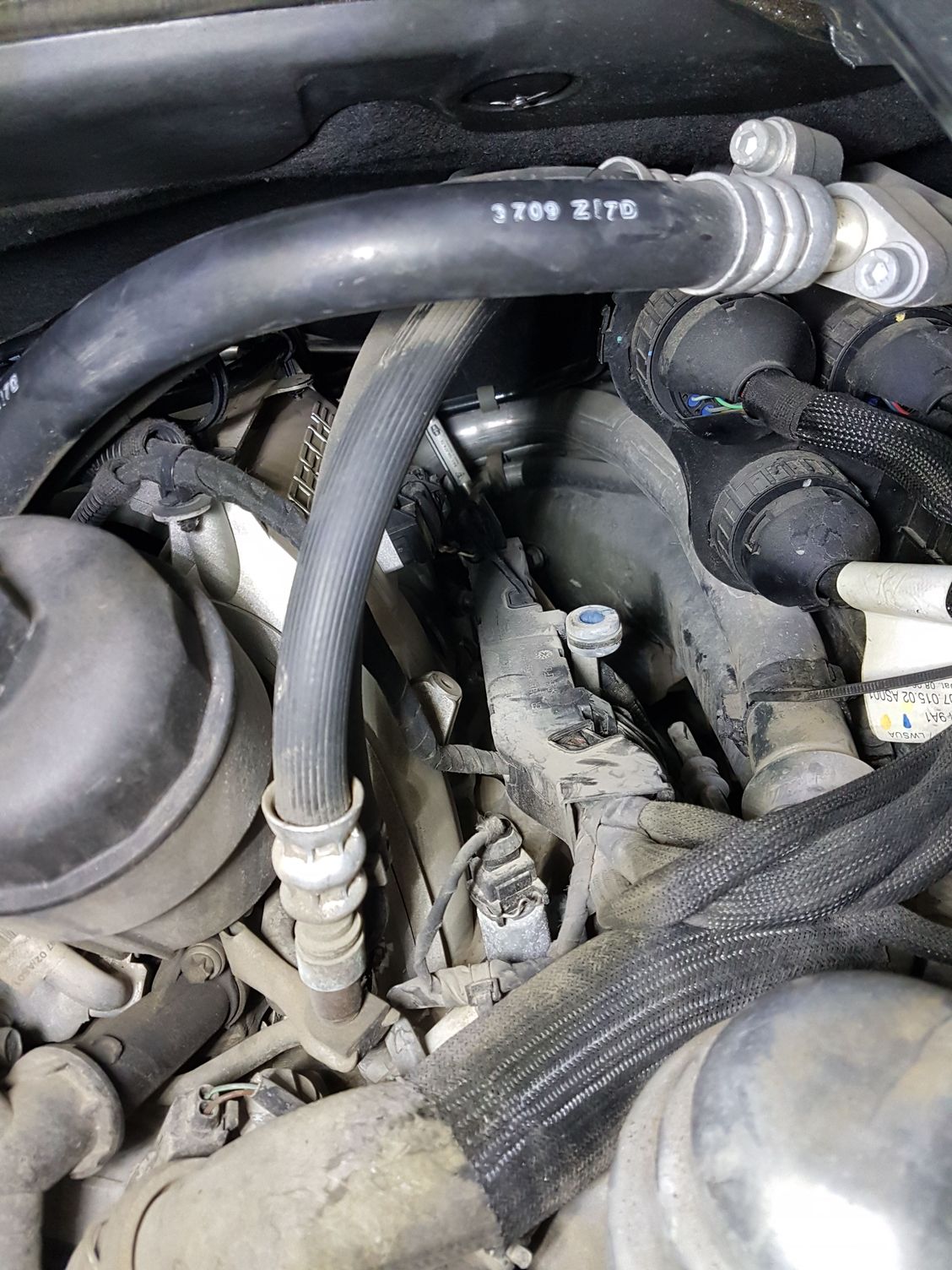

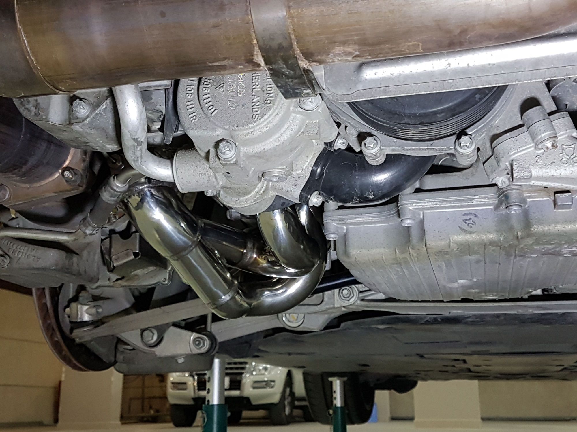

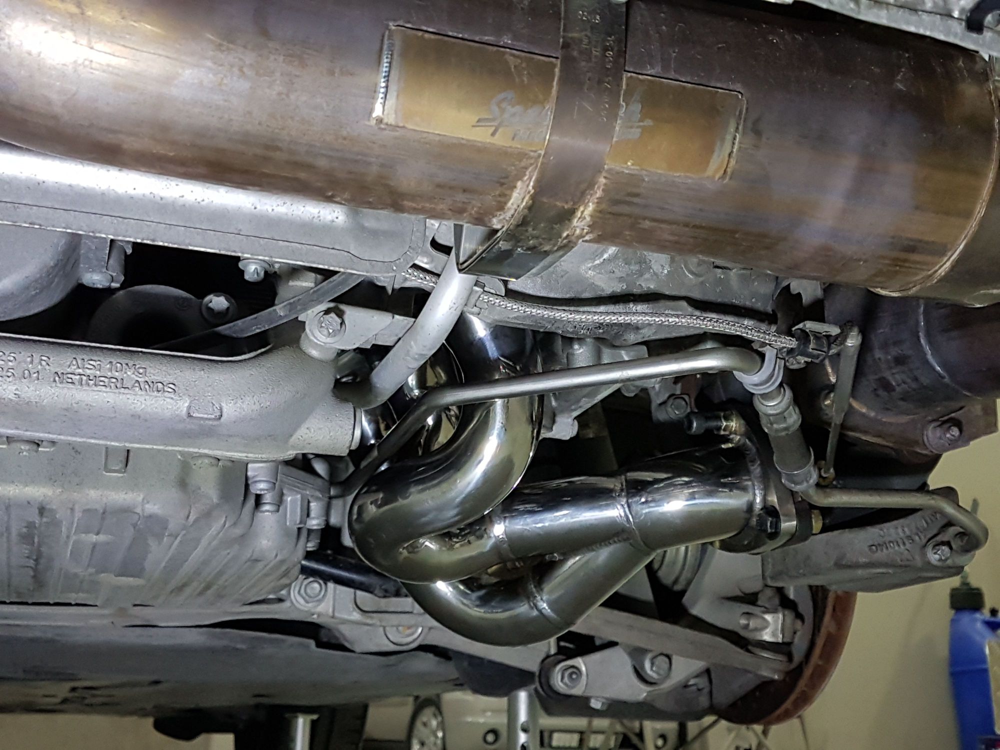

7. installed passenger side headers: this side is the easy side due to the shape of the exhaust turbo flange. one extra step I had to do is open the bolts of the oil line from the oil pan and turbo and the mounting . allow me to flex the oil line in order to rotate the OEM exhaust headers to be removed . then installed the new headers easily. they are exact fit
ESMOTOR PASSENGER side header
Plenum out
DVs unplugged
Breather unpluged
TB cleaning
IPD plenum silicone hose
WOW I didn't expect this difference in size!
I hope they sound better! I didn't hear any 997.2TT headers in person
Inverted torx for headers bolts
Flanges are 12mm nuts
Inverted torx bolts
Better results than wd40 lool
Driver side headers
Passenger side headers

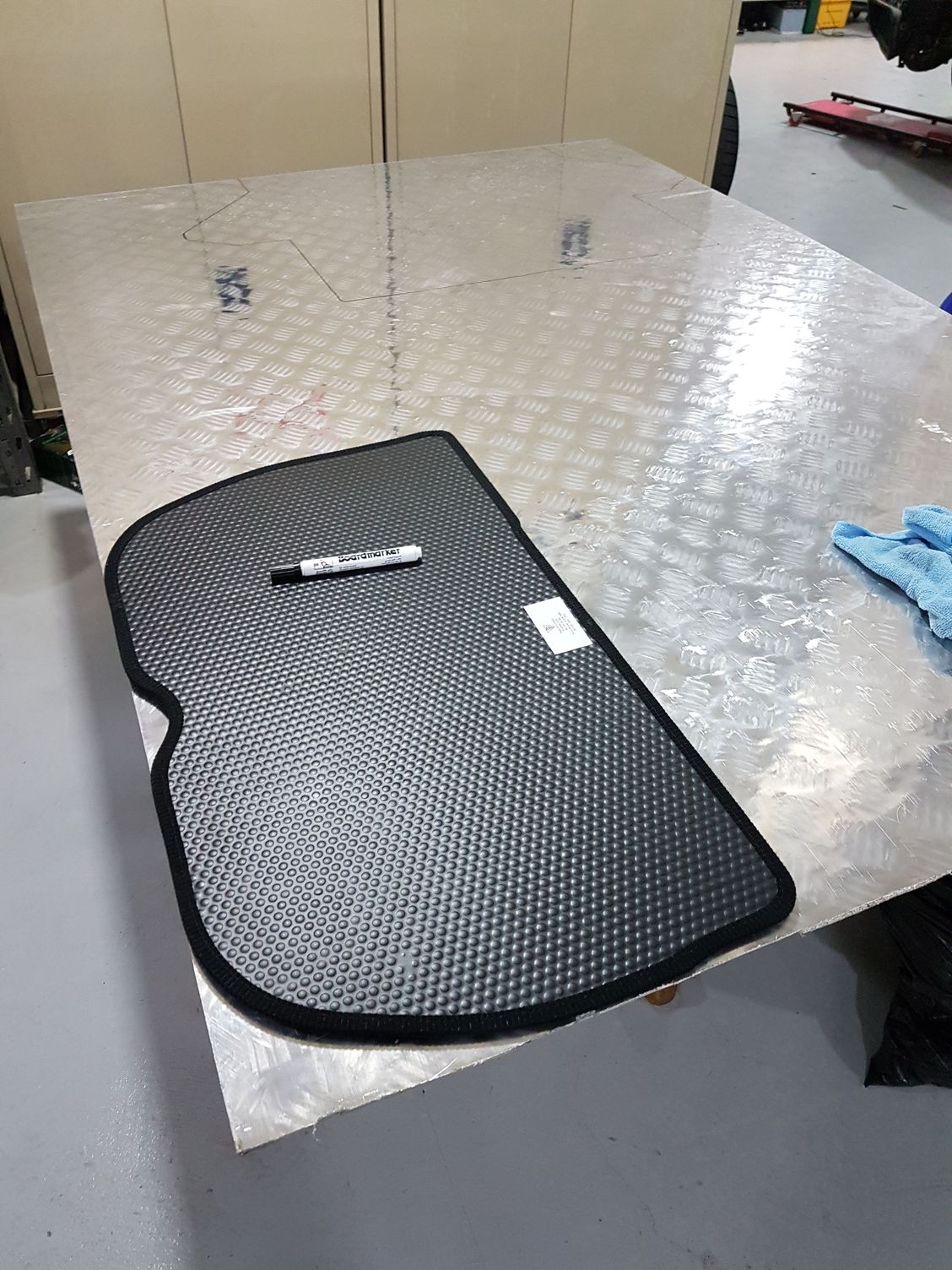

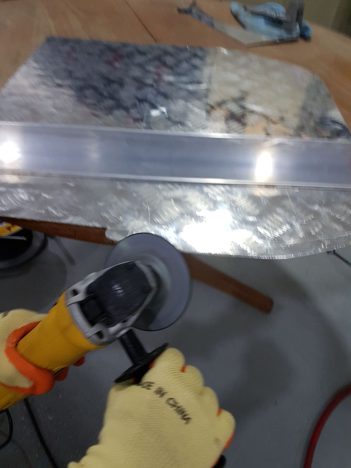

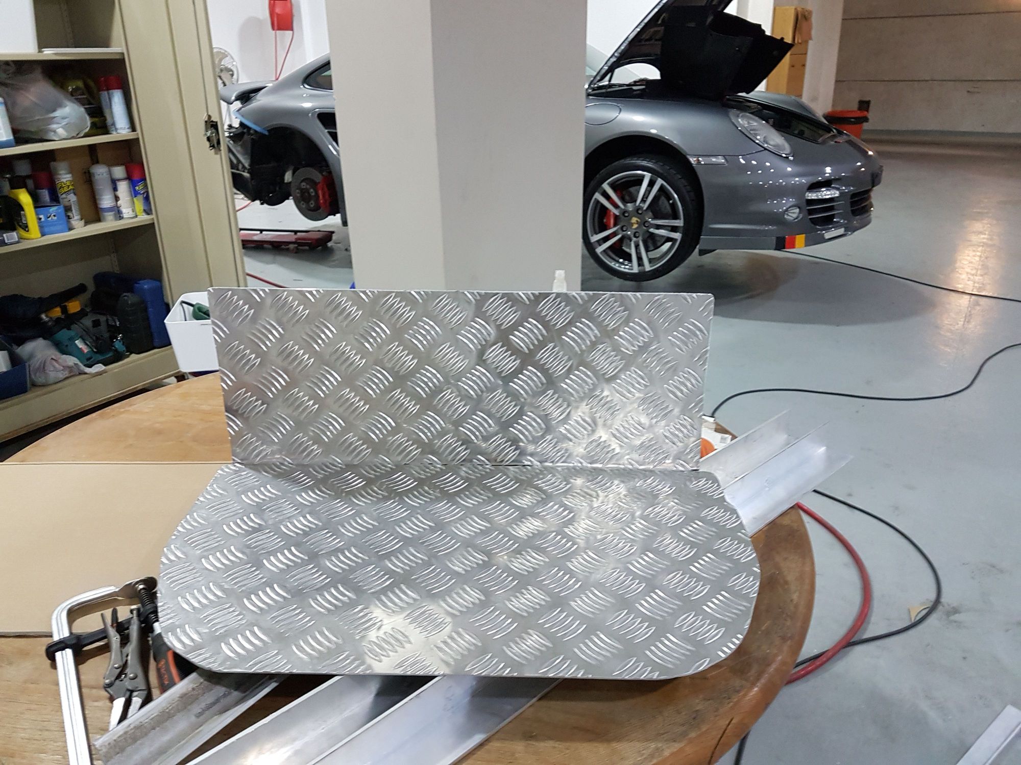

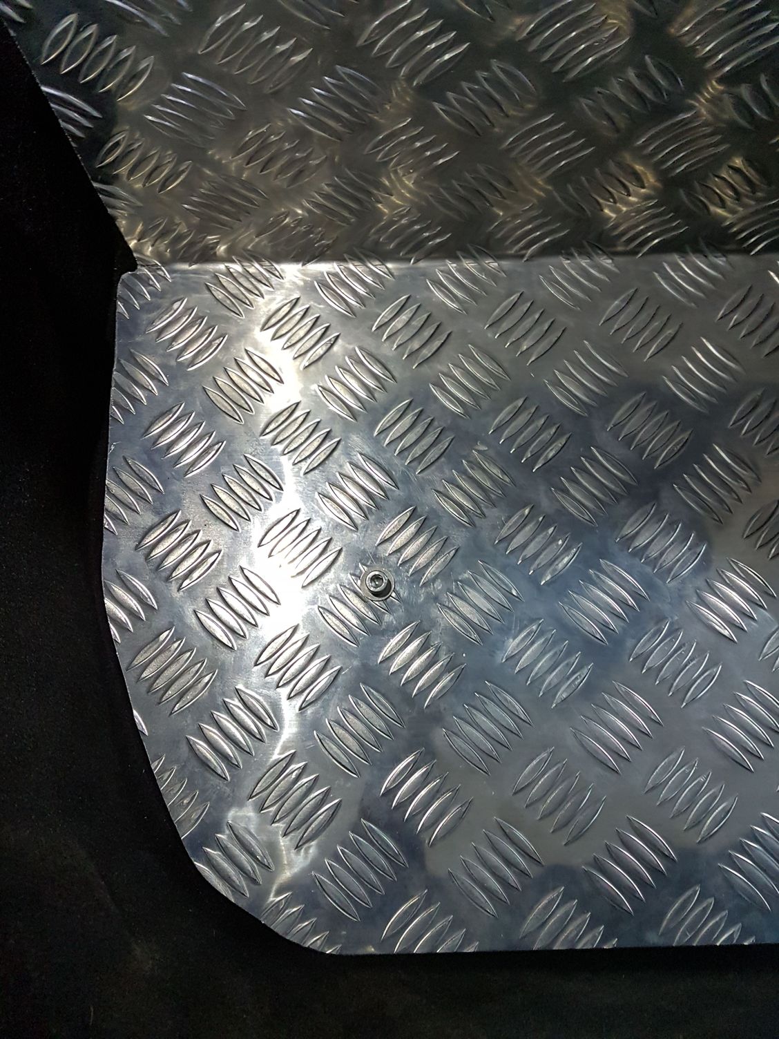

Ok

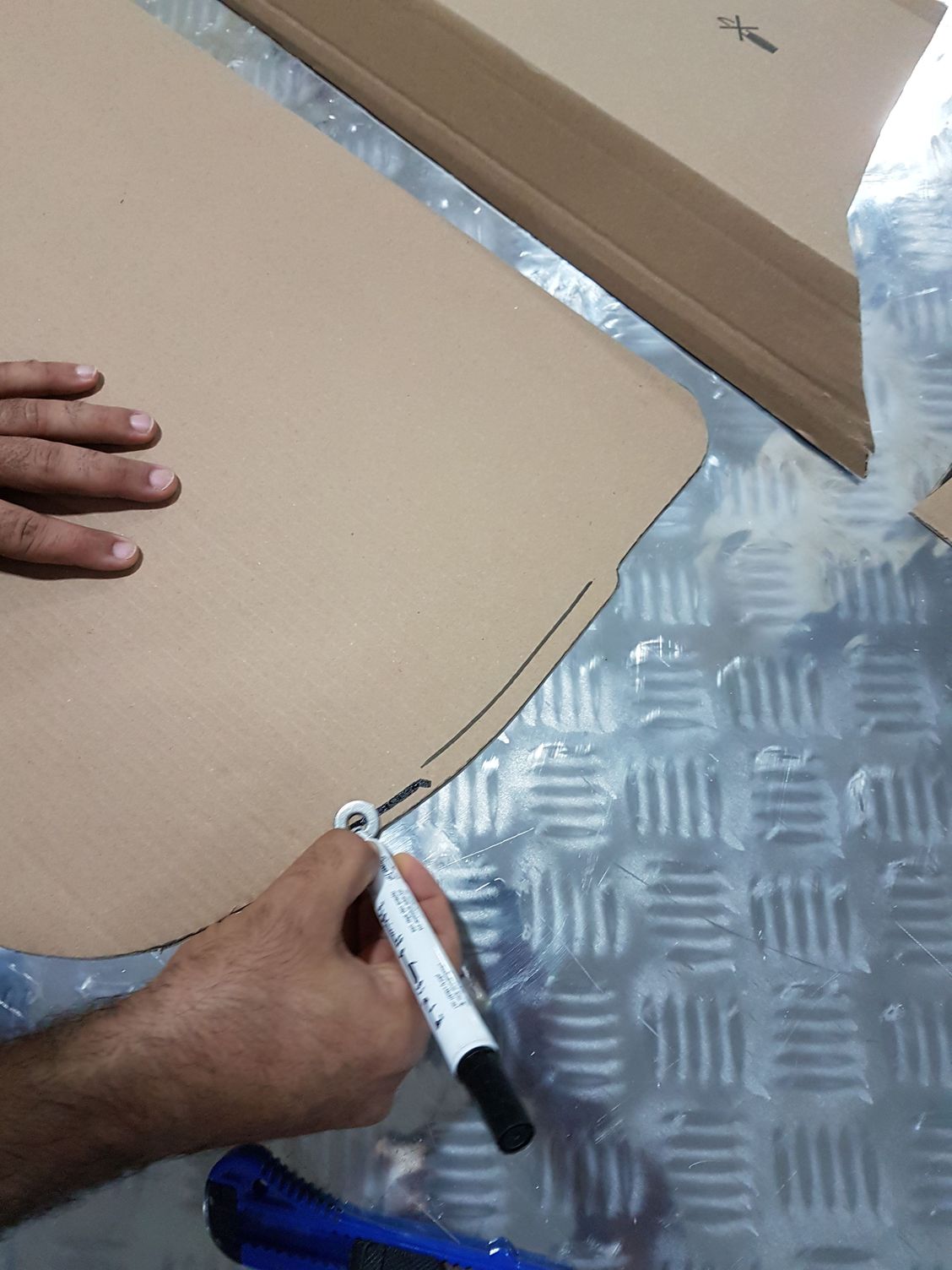

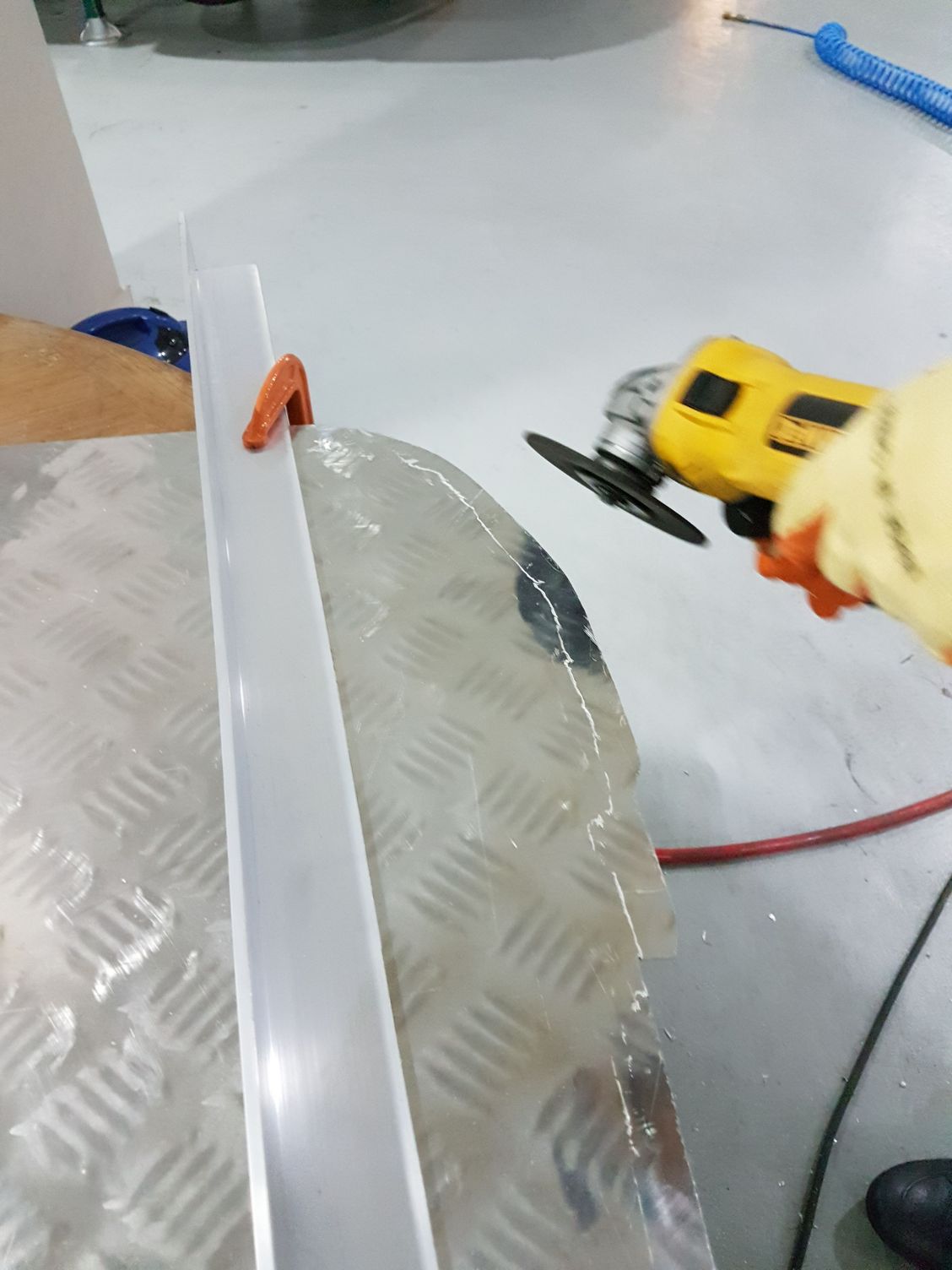

so today I didn't touch anything that's performance related loool

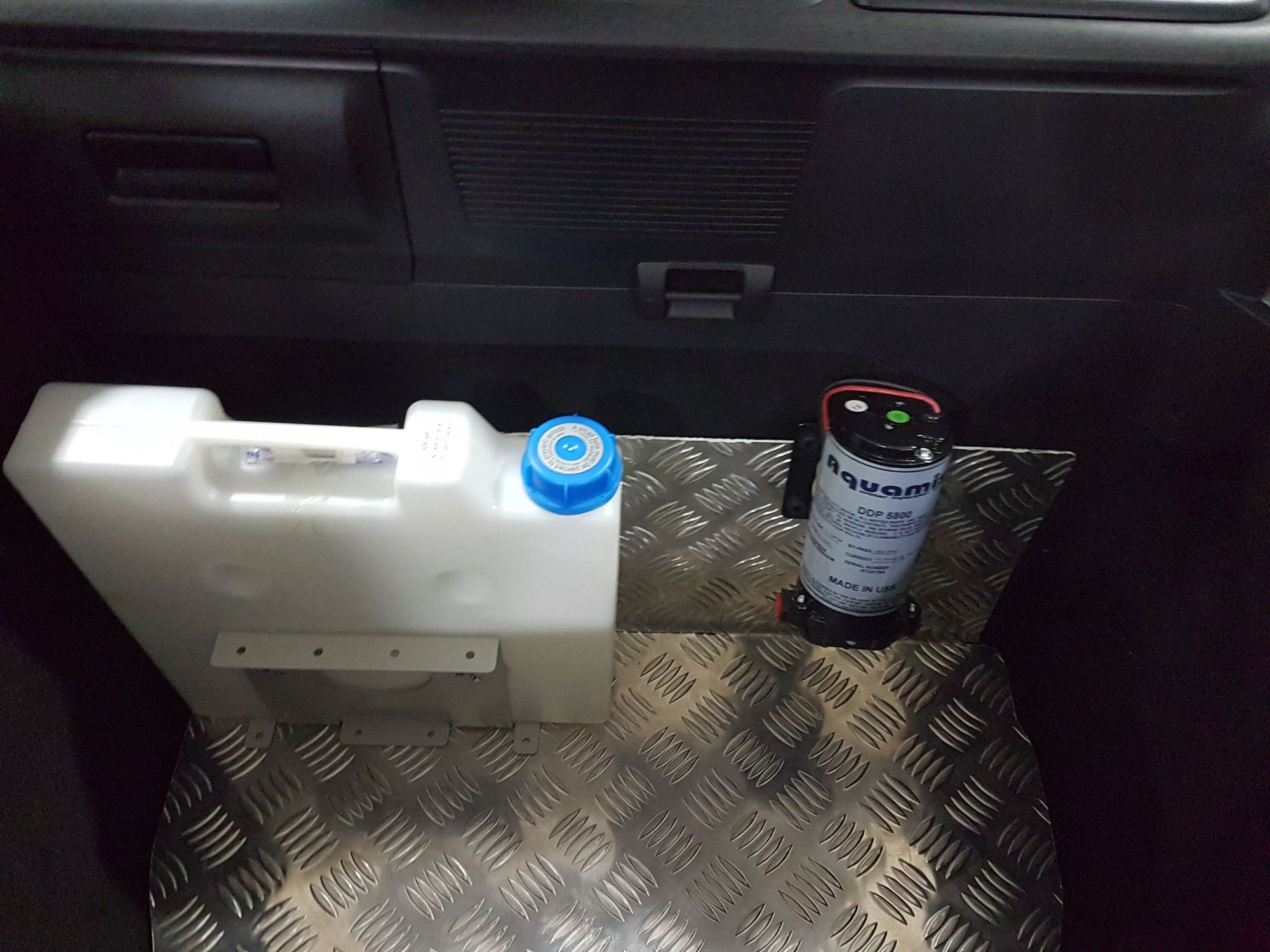

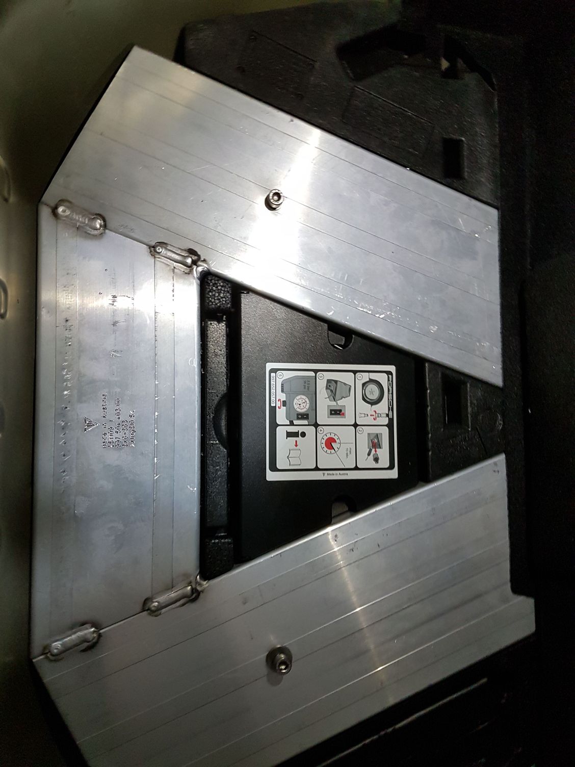

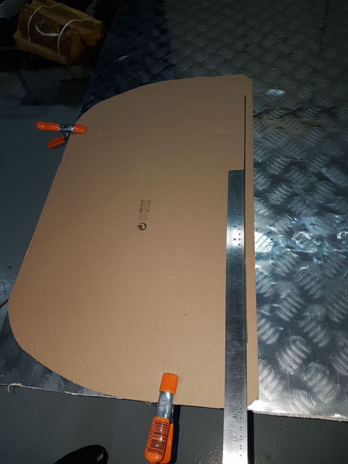

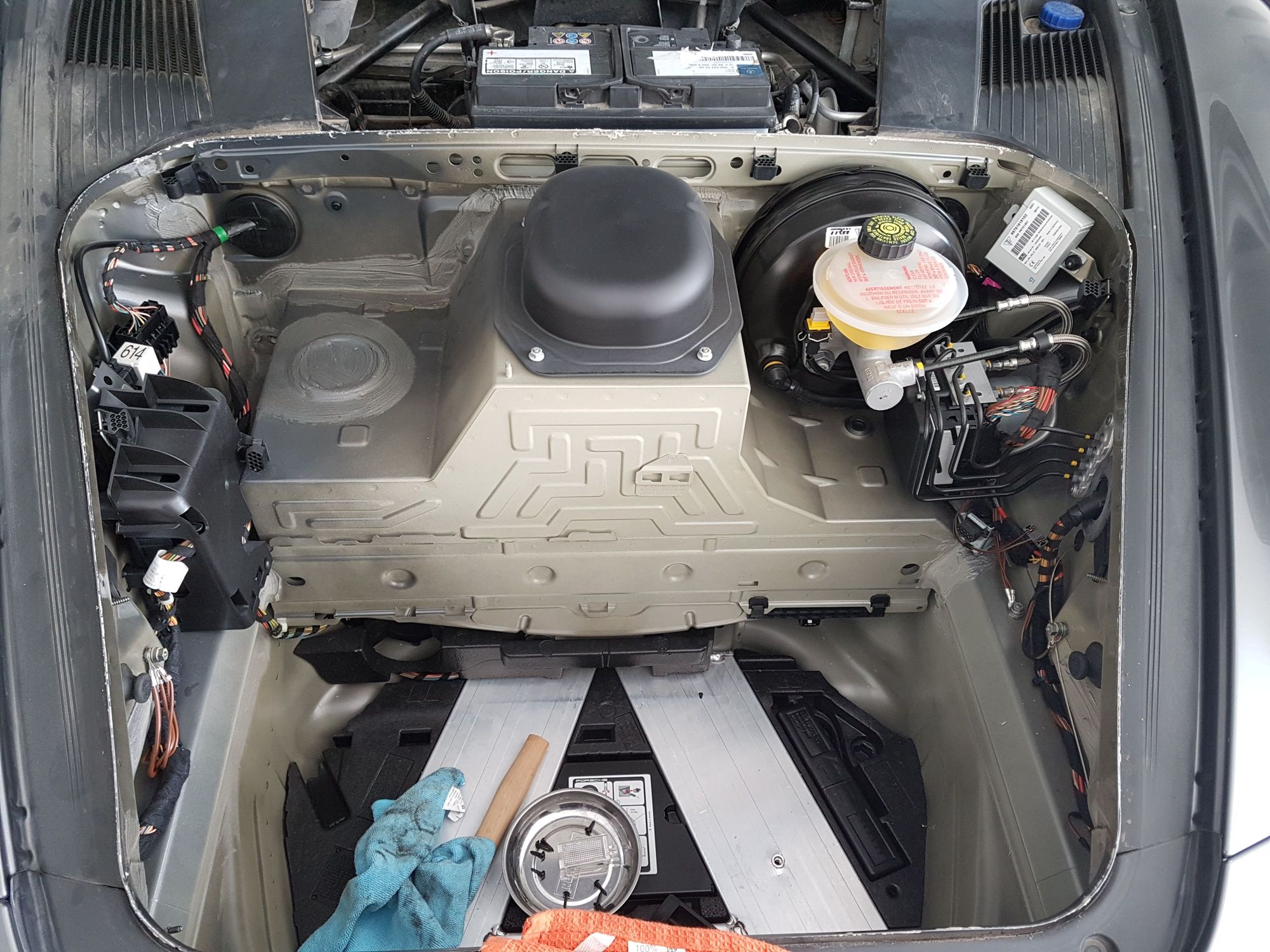

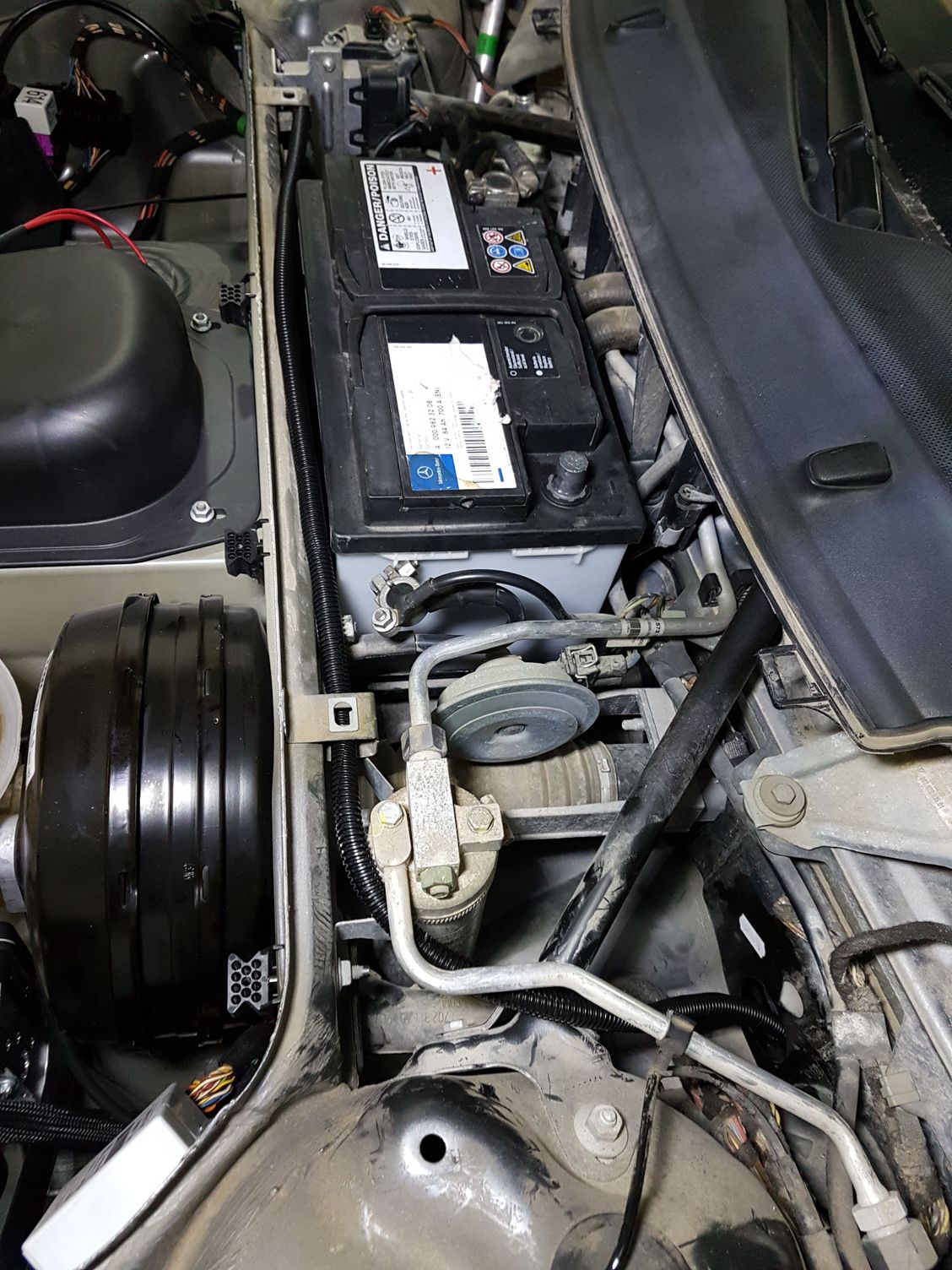

i was thinking of a way to mount the methanol tank, pump and few extra power port and voltage meter to monitor the battery . plus a power socket for whatever need.... and a port to plug the battery maintainer .
so I came up with this:
A frunk aluminium mat!!
Test fitting
I'm very pleased with the results
It is also removable

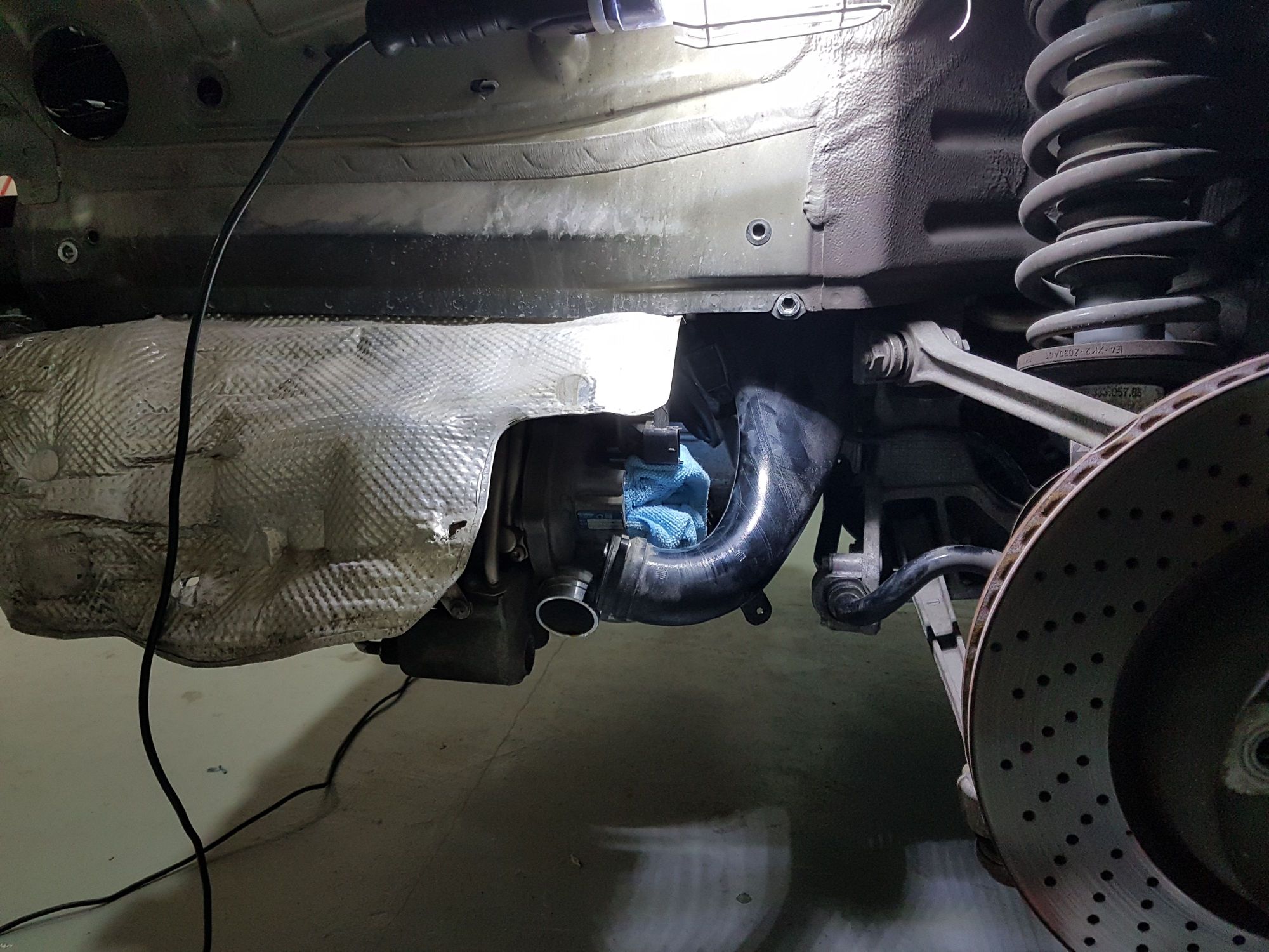

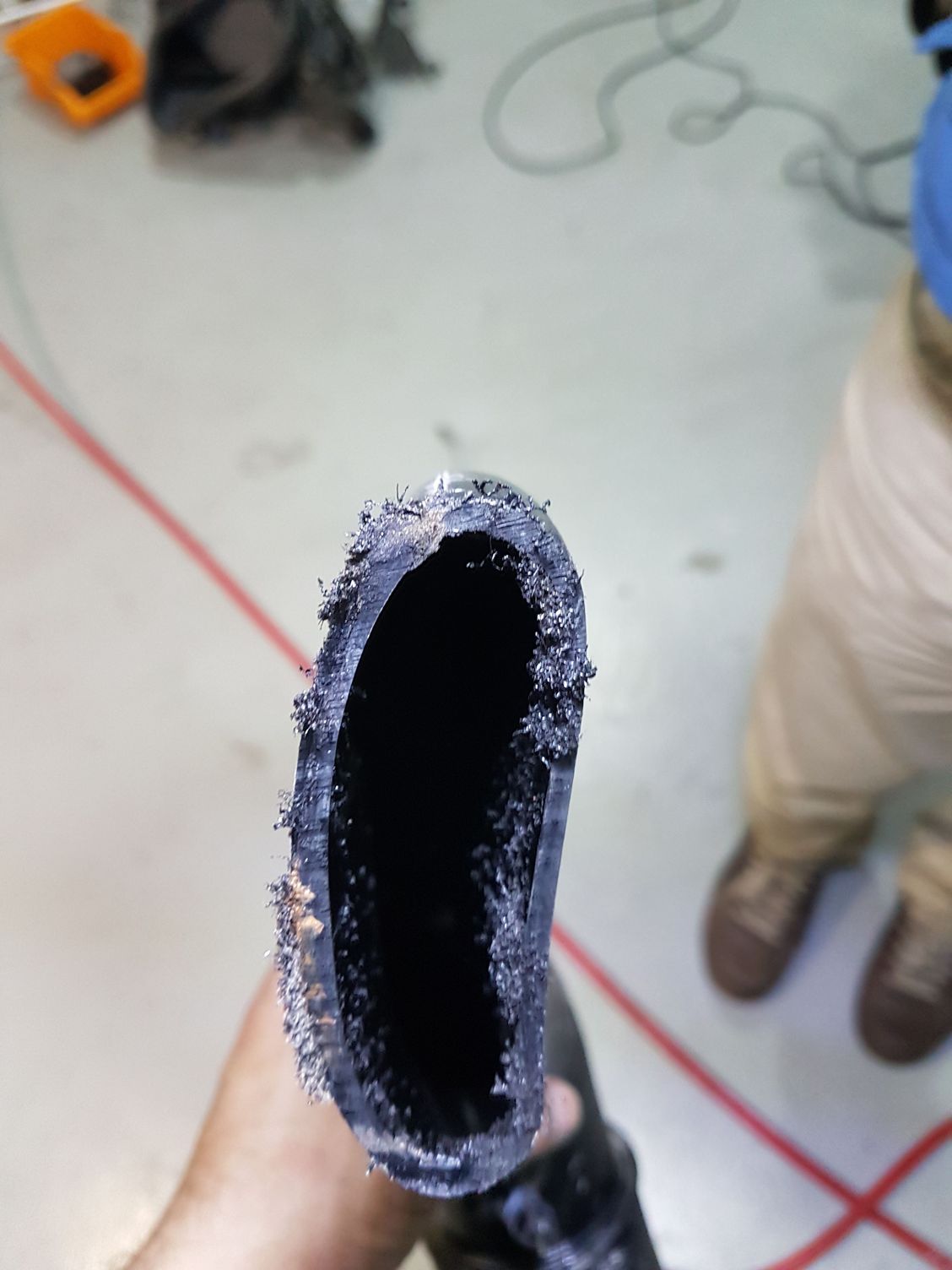

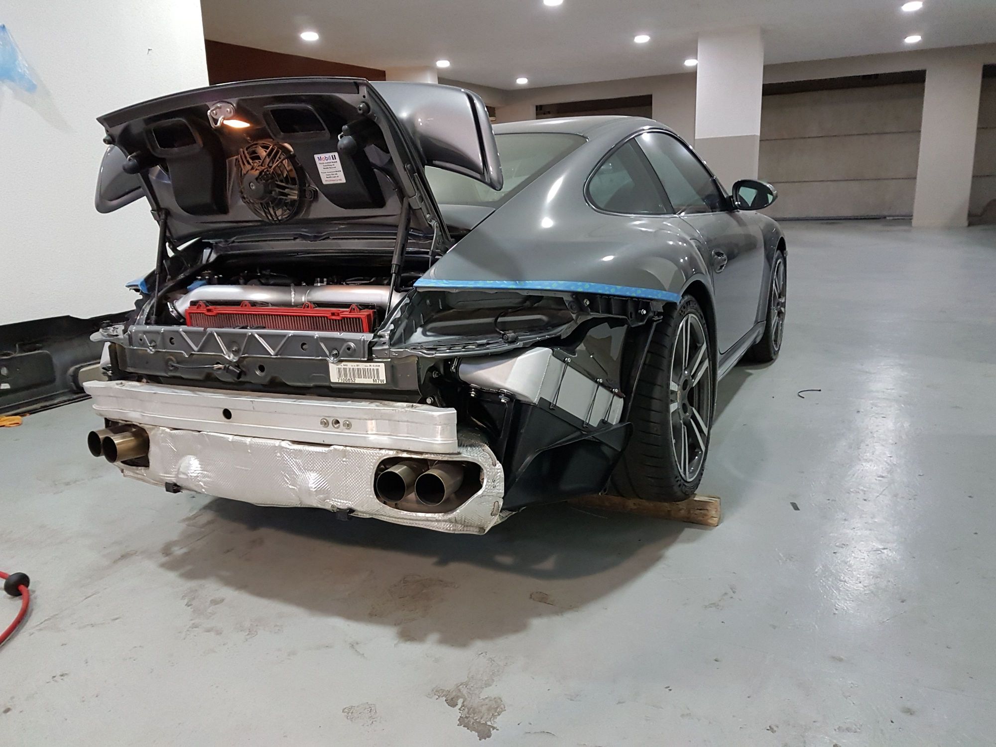

Progress report #3 19Nov2016
I didn't have much time available to me.
so what I did today:

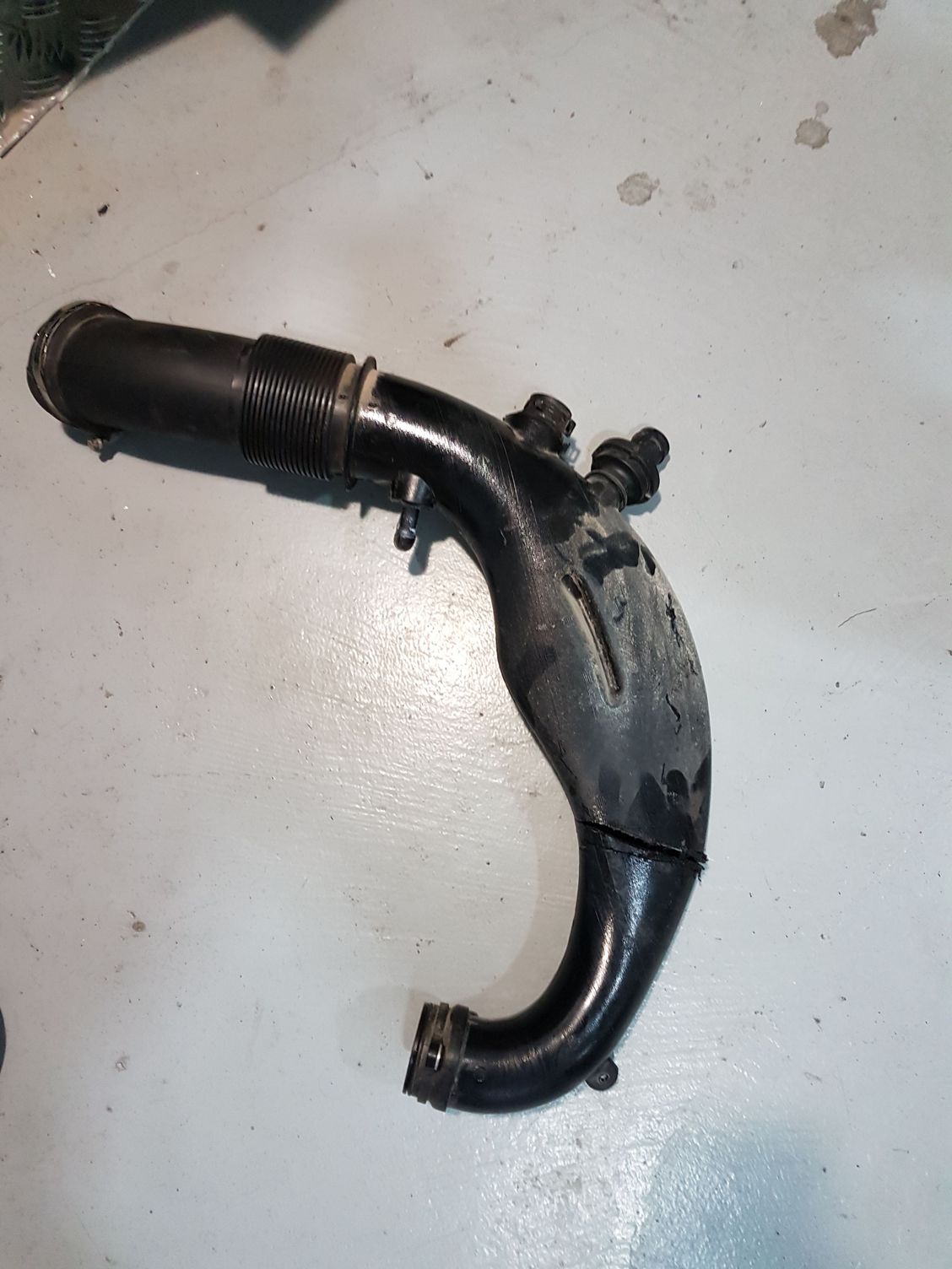

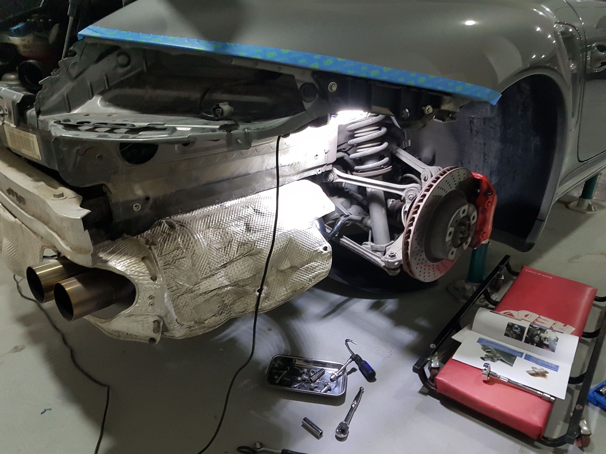

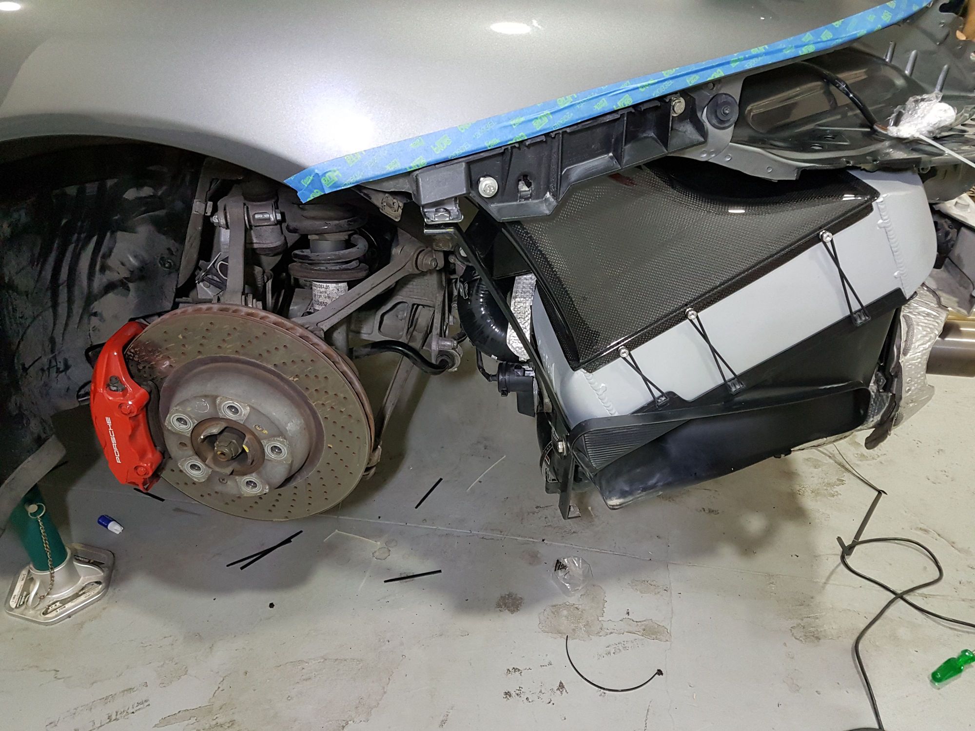

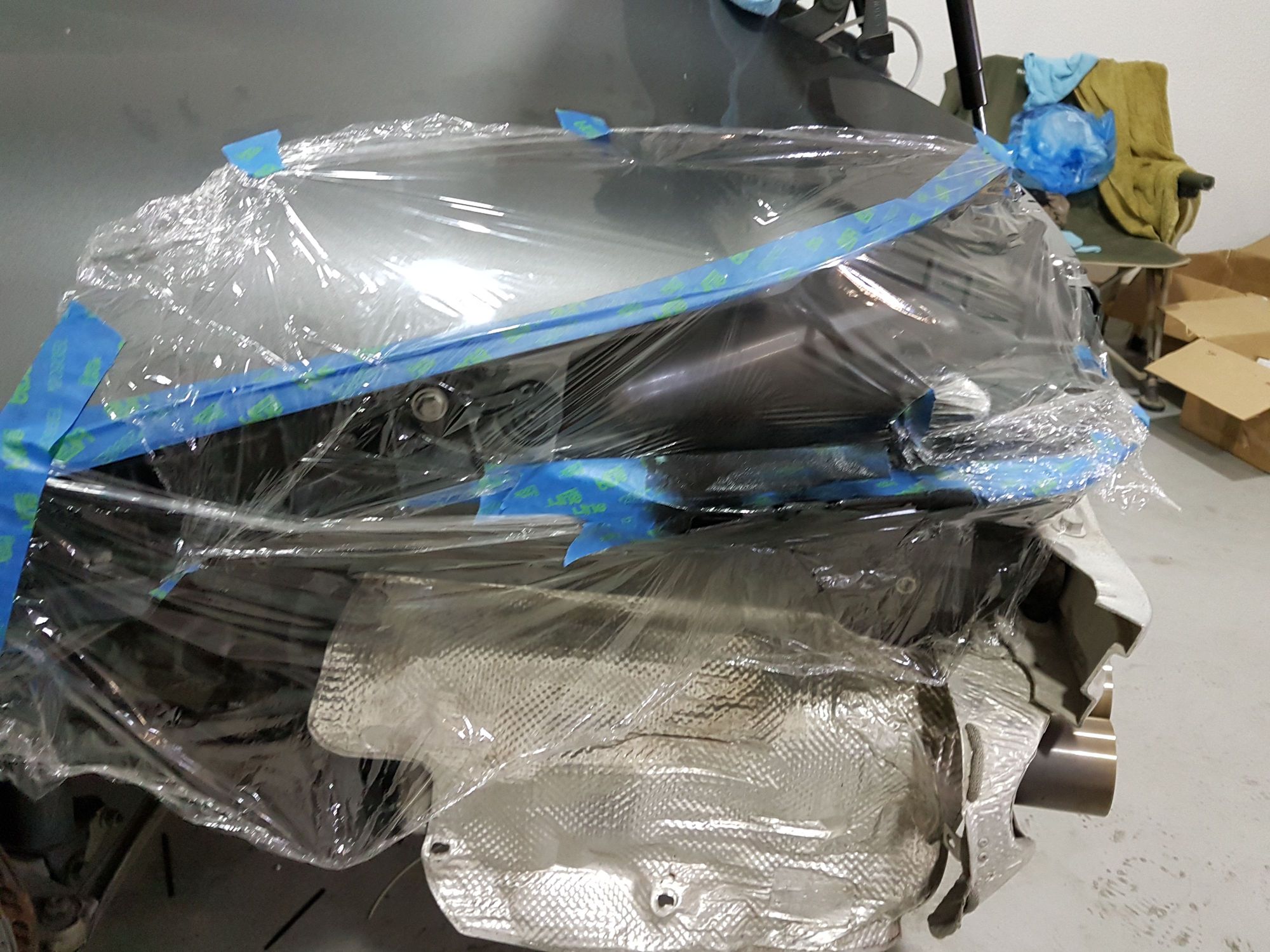

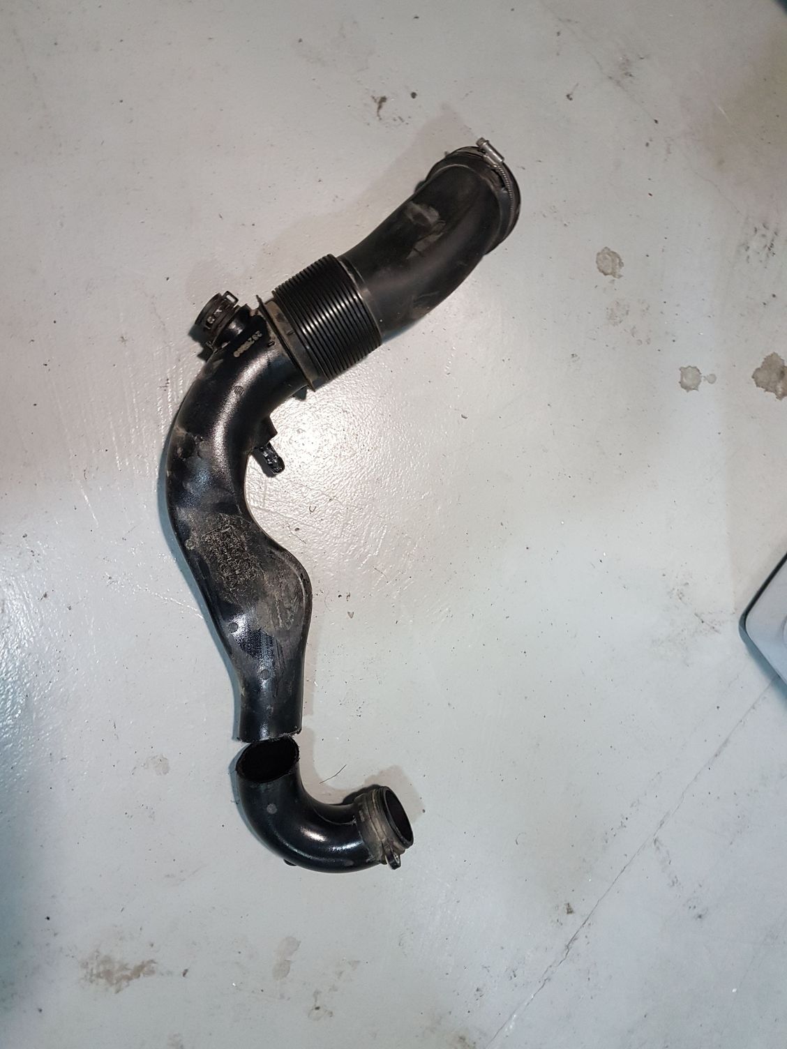

took out the intercoolers
and
cut and removed the turbo inlet pipes.
Damn that's tiny!!

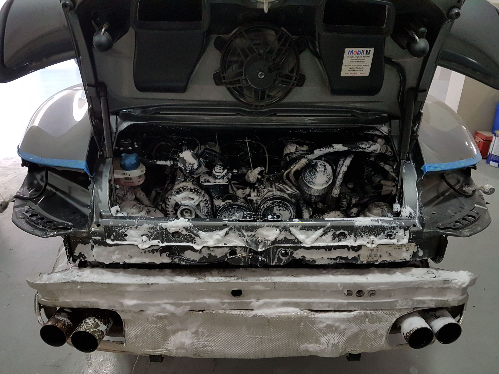

1. I've foamed and cleaned the engine

What's the foam you used? Do you rinse it off or just spray on ?
Old 11-21-2016, 08:34 PM
3llooi
3llooi's Avatar
Join Date: Nov 2016
Posts: 69
Received 2 Likes on 2 Posts
Rinsed off.

Awesome updates, keep them coming. Horrible how flat and restrictive those ducts are!

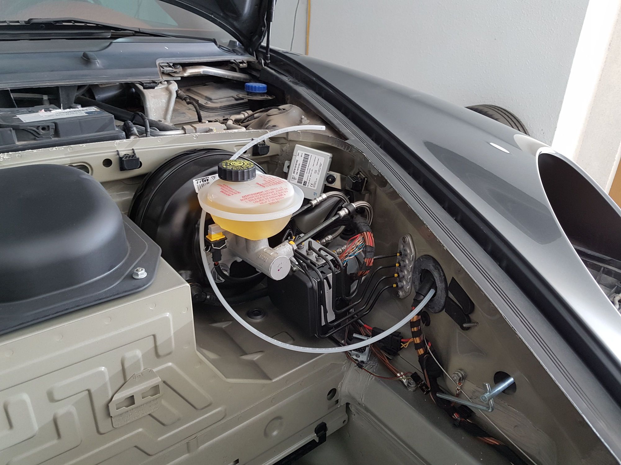

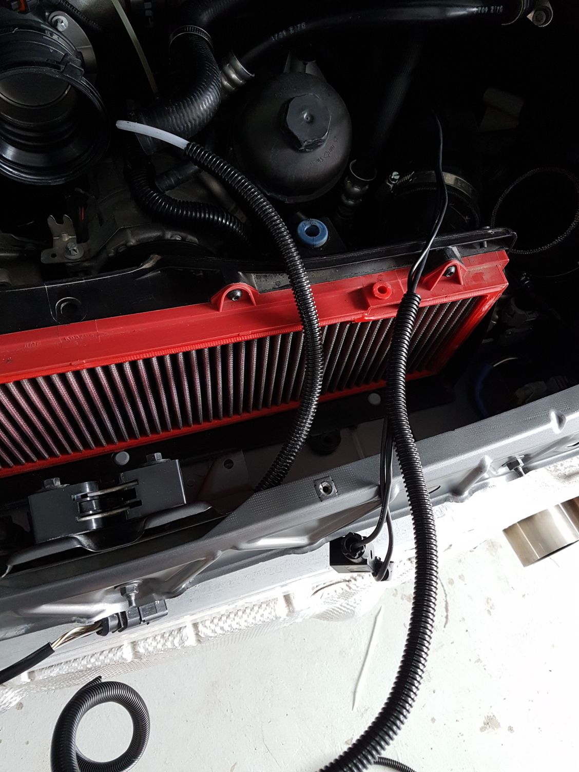

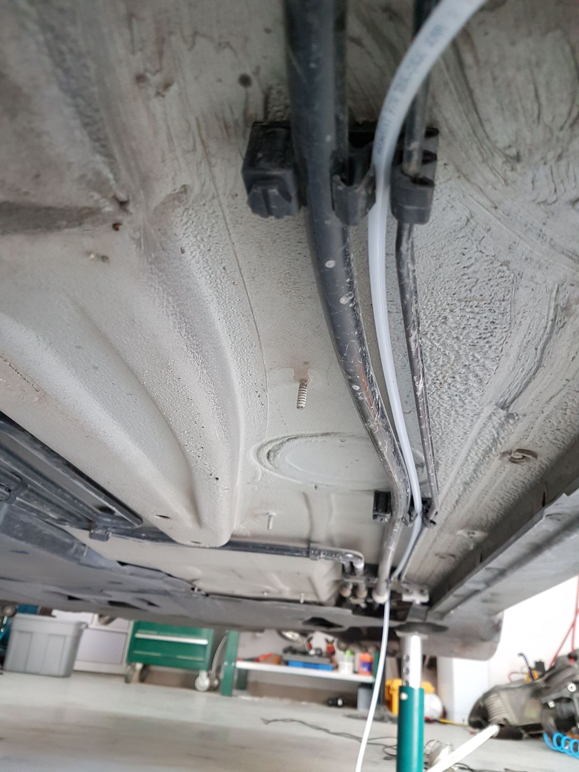

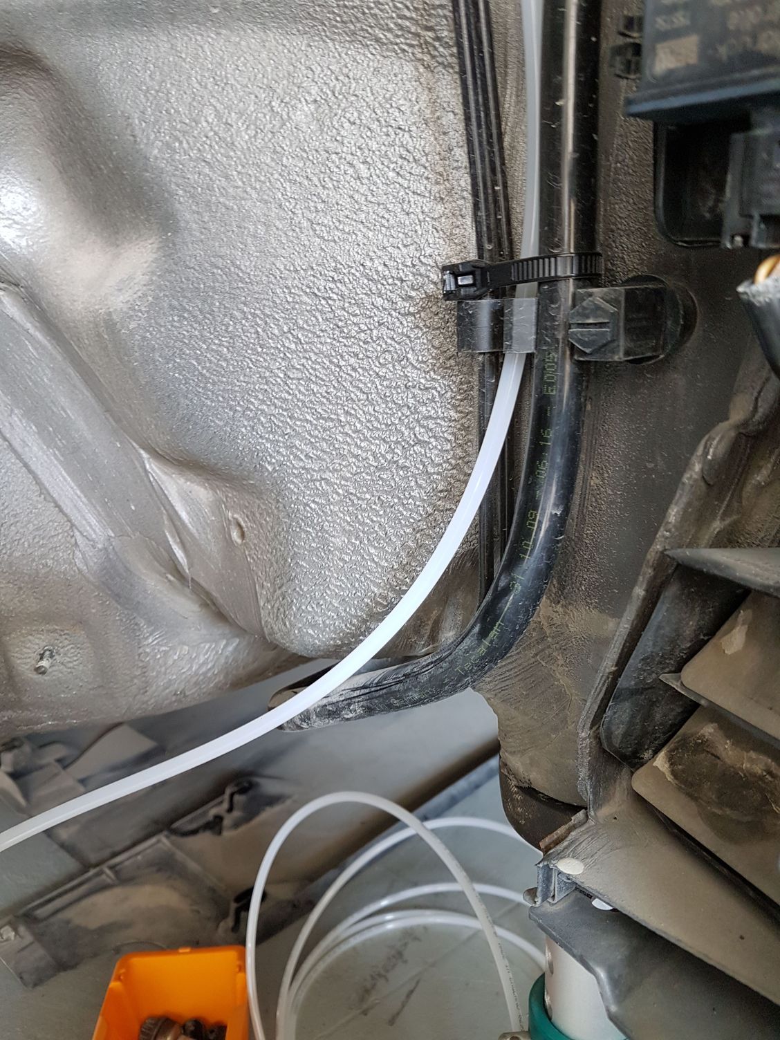

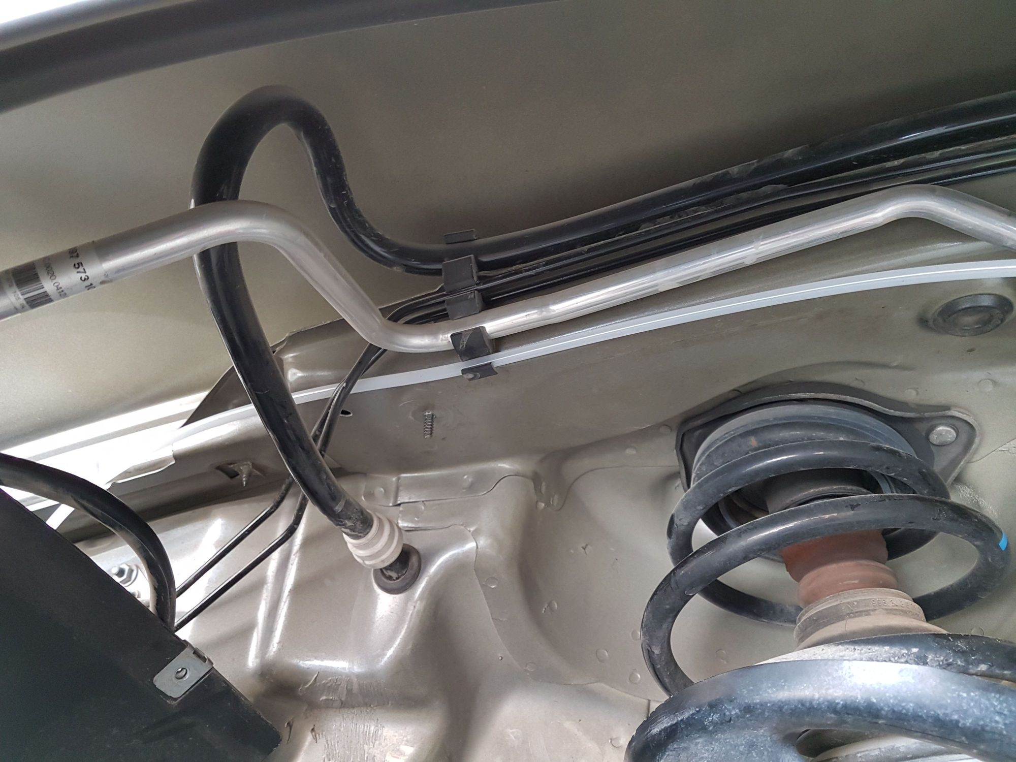

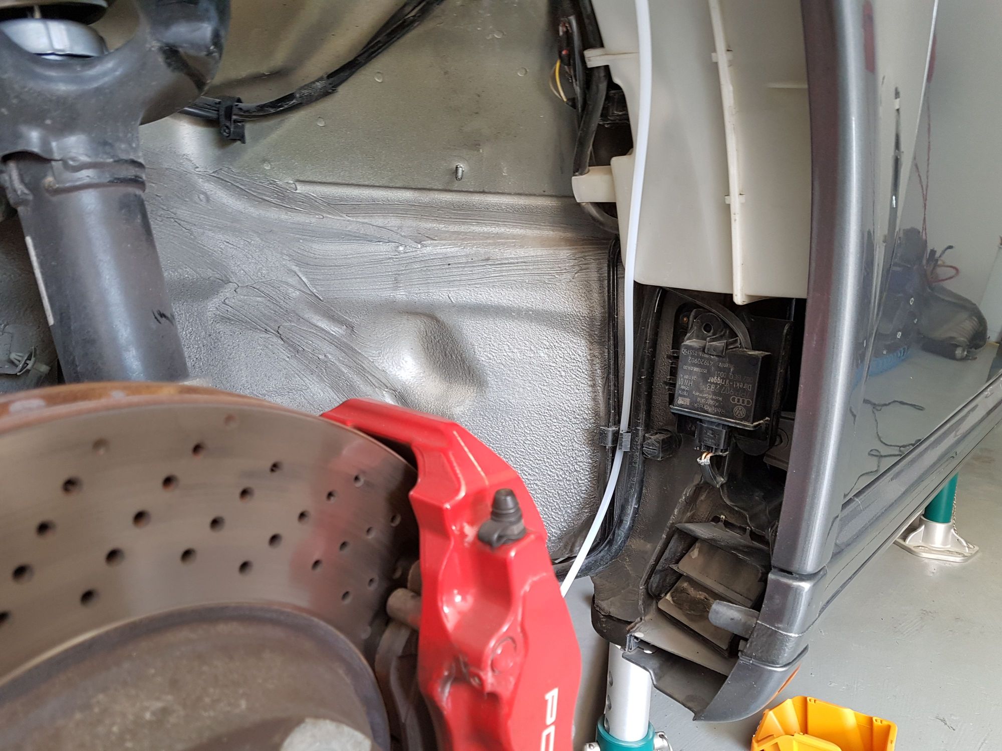

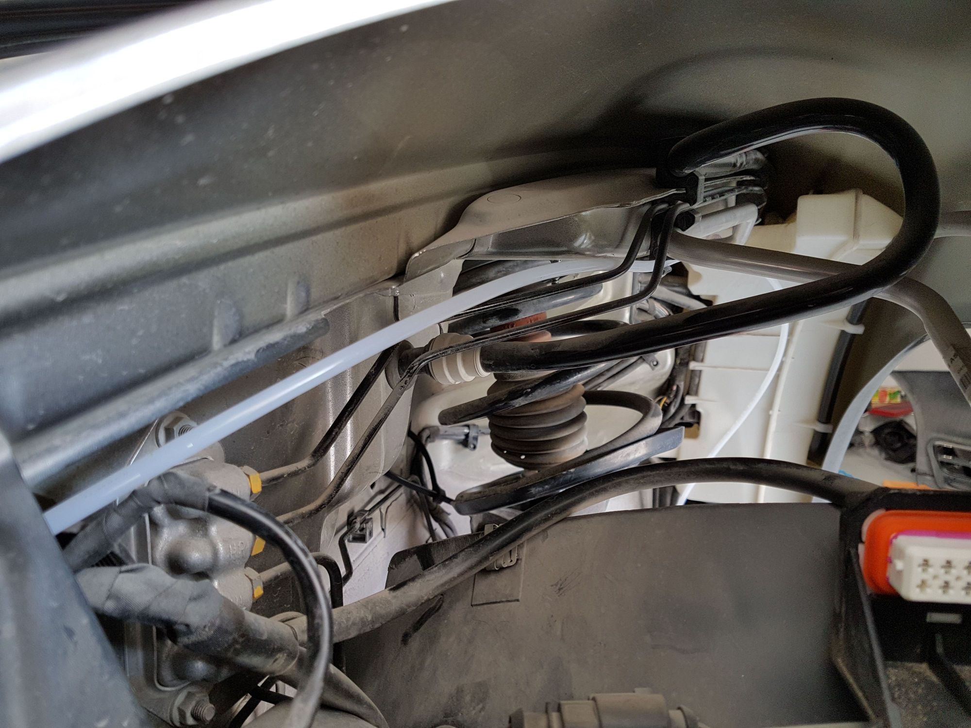

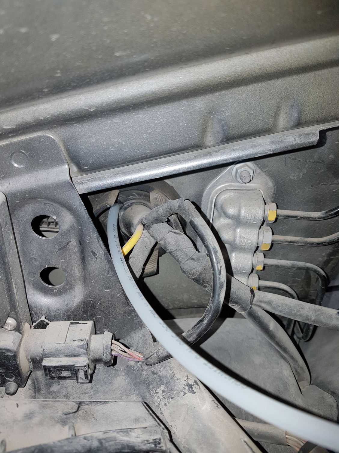

1. ran the methanol 6mm nylon hose fron trunk to engine bay

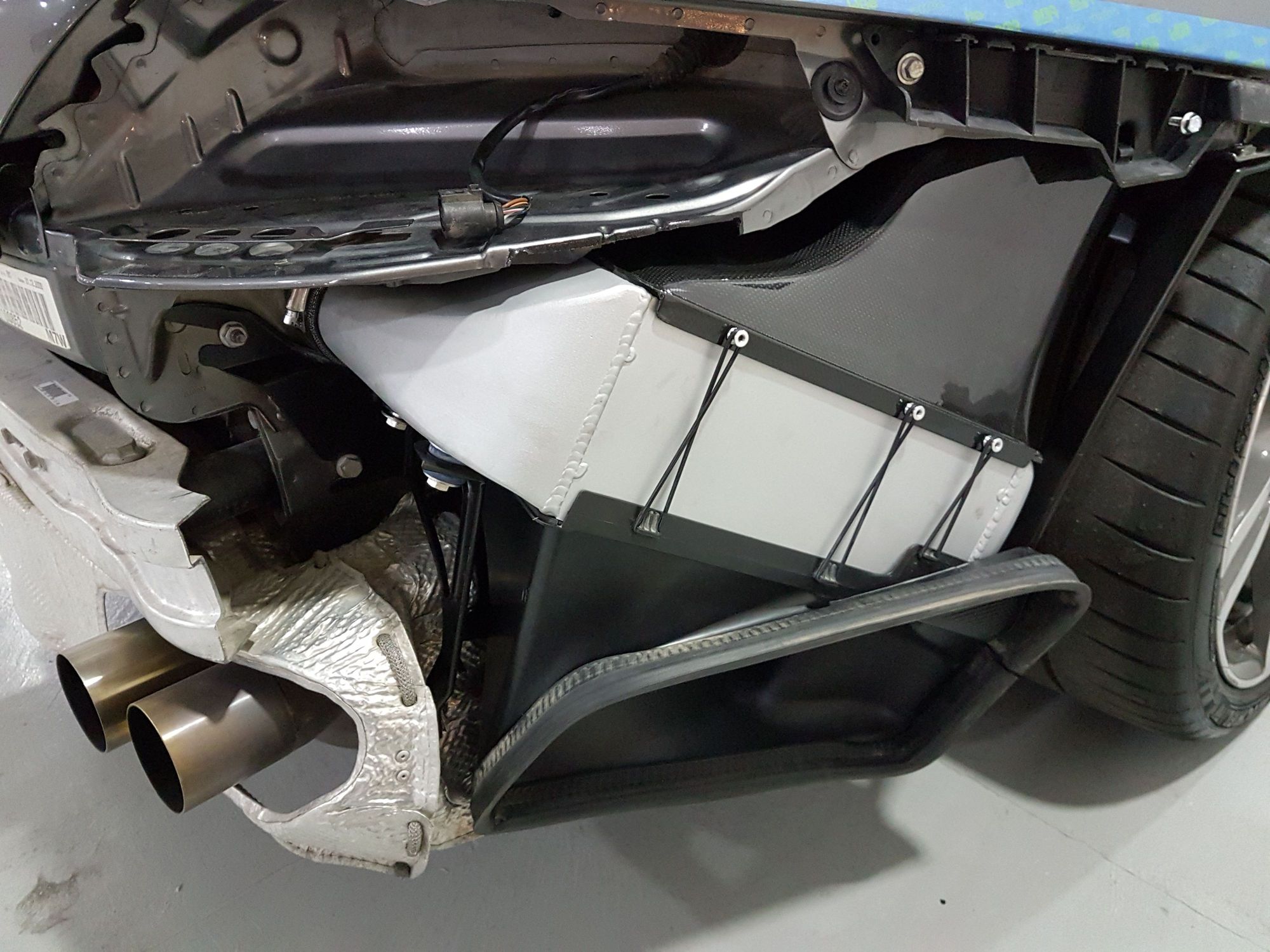

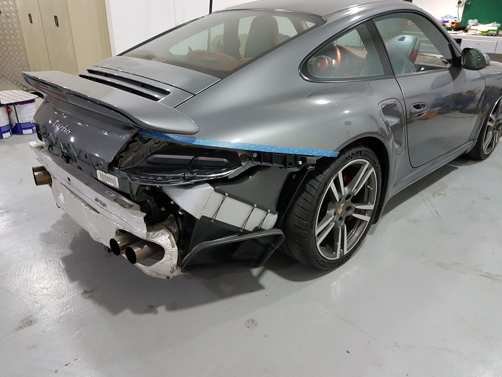

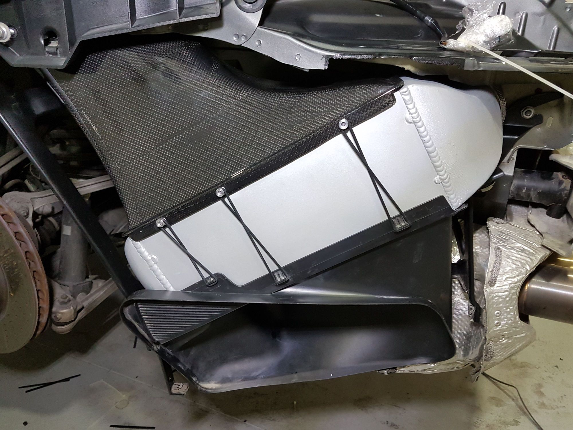

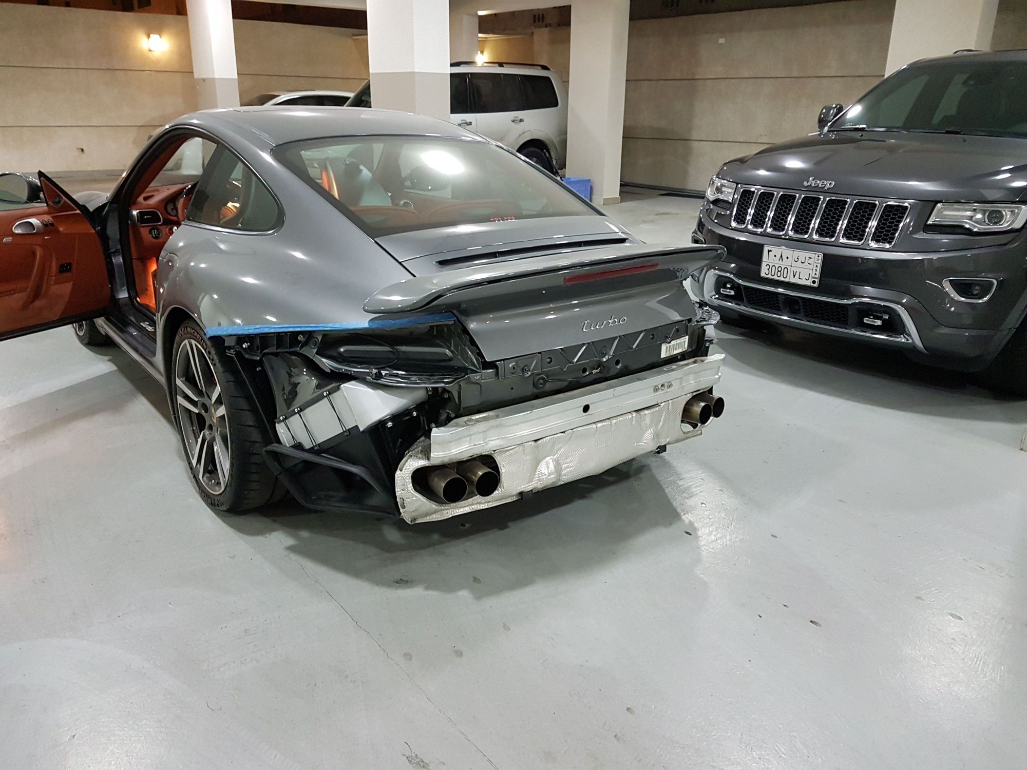

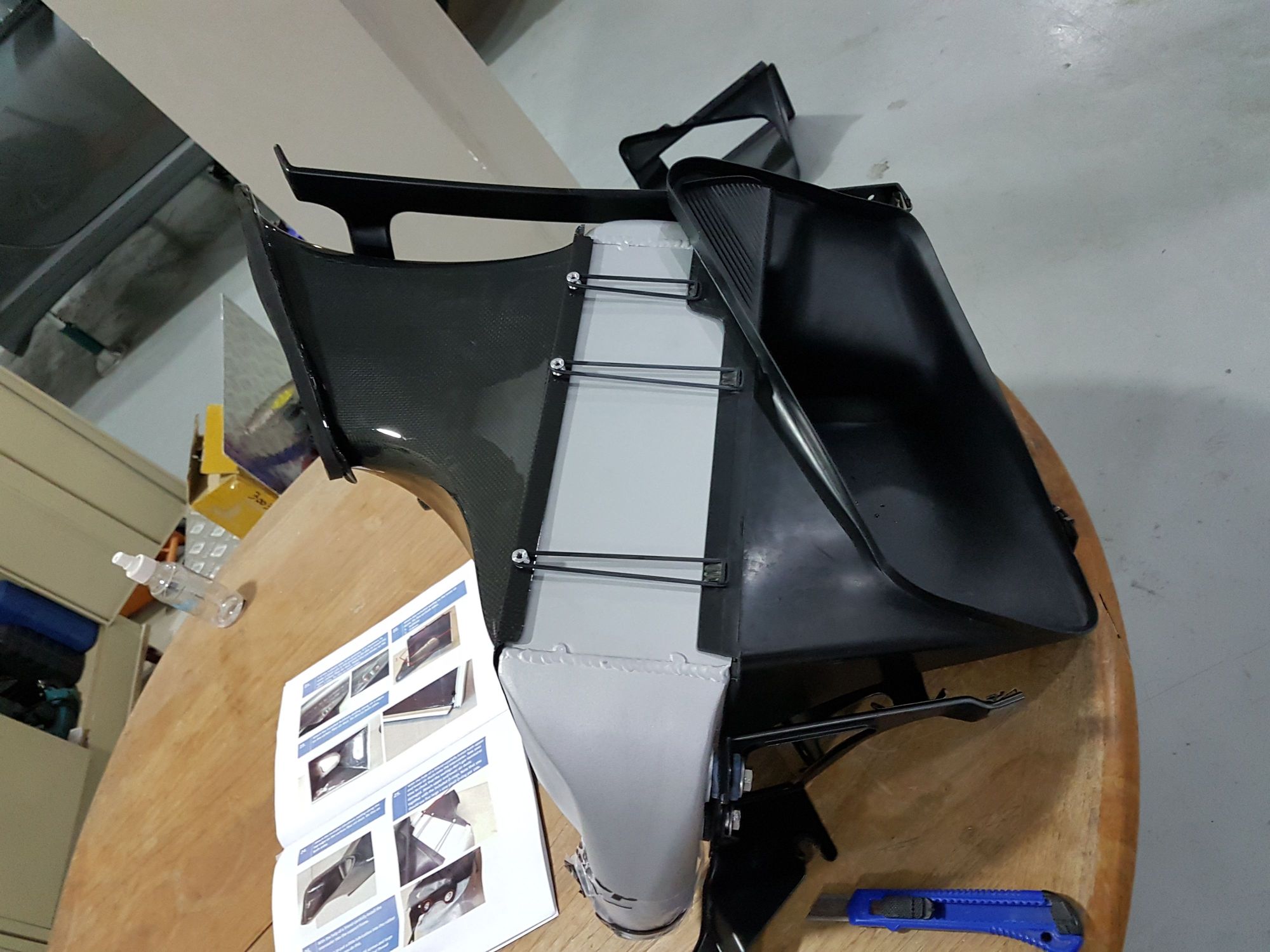

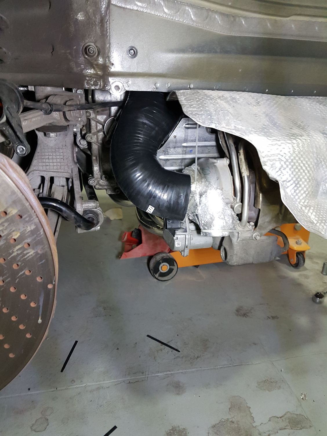

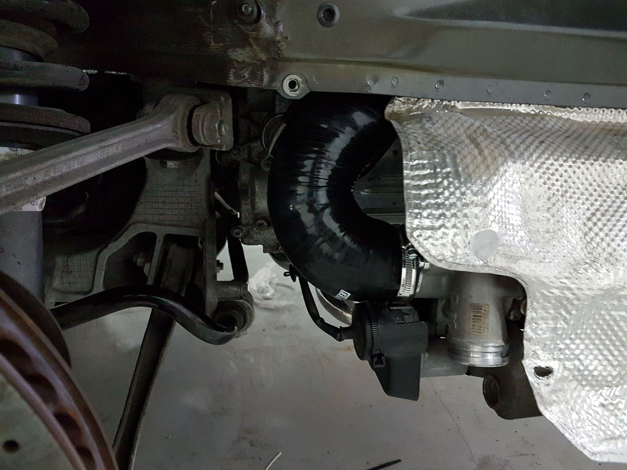

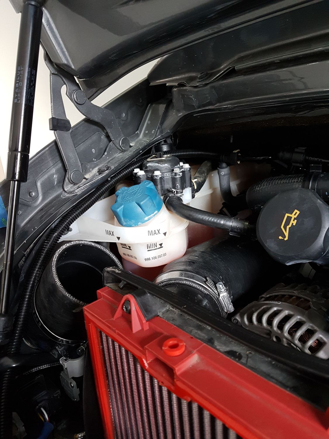

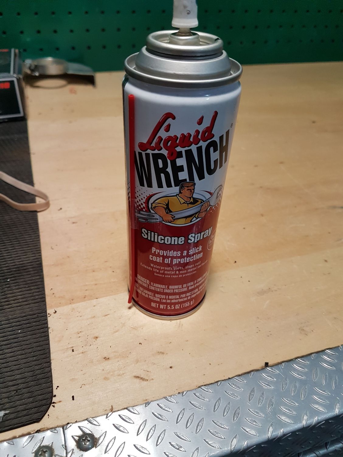

2. I made the cut on the pieces lower to the tail lights to fit the larger intercoolers, and gave them a small spray of bed liner in a can
3. fitted the do88 turbo inlet pipes! they were a pain in the back to fit. the only way I was able to do it is to lower the engine around 2 inches by unbolting the rear engine mounts AND spray the hoses with lots of silicone spray lube .

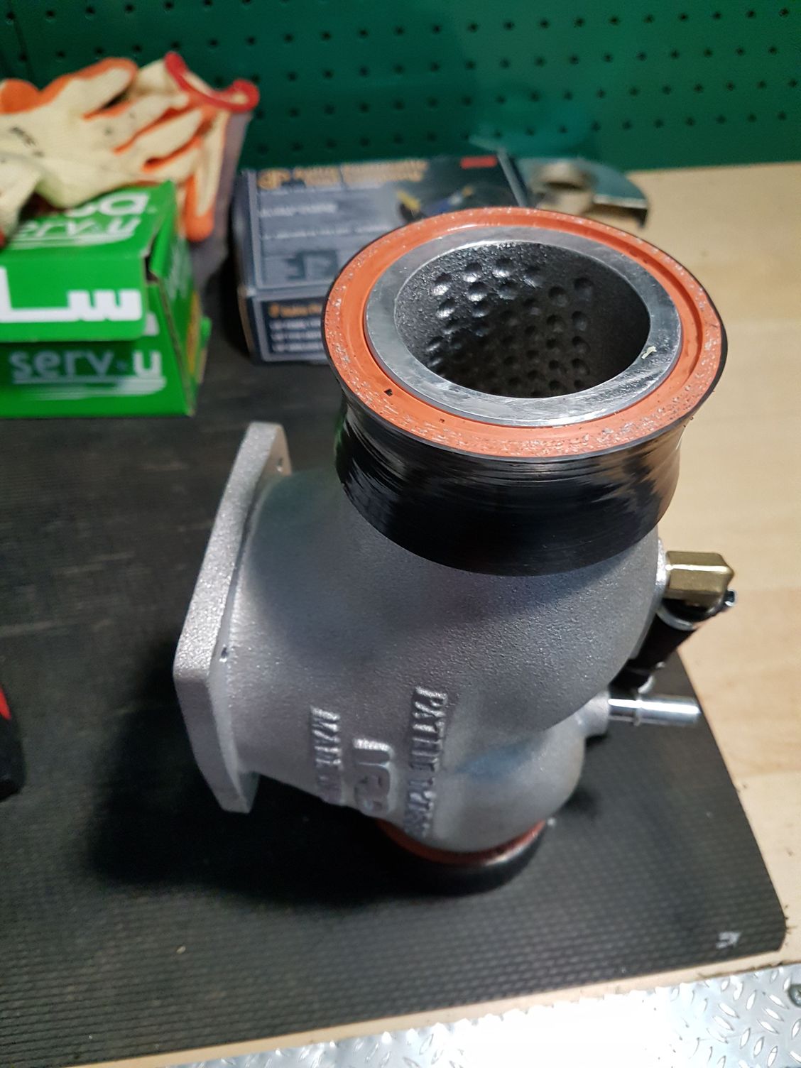

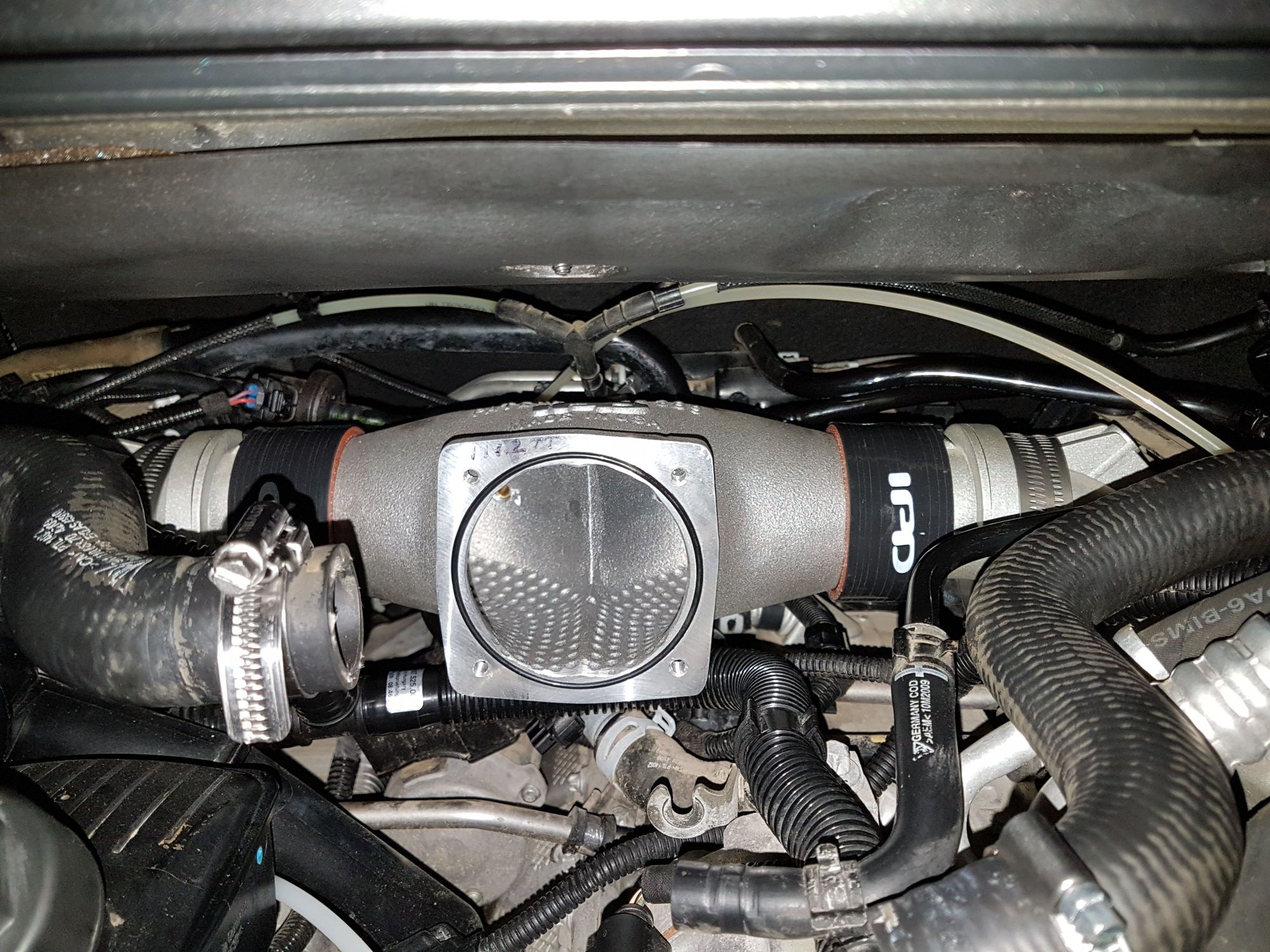

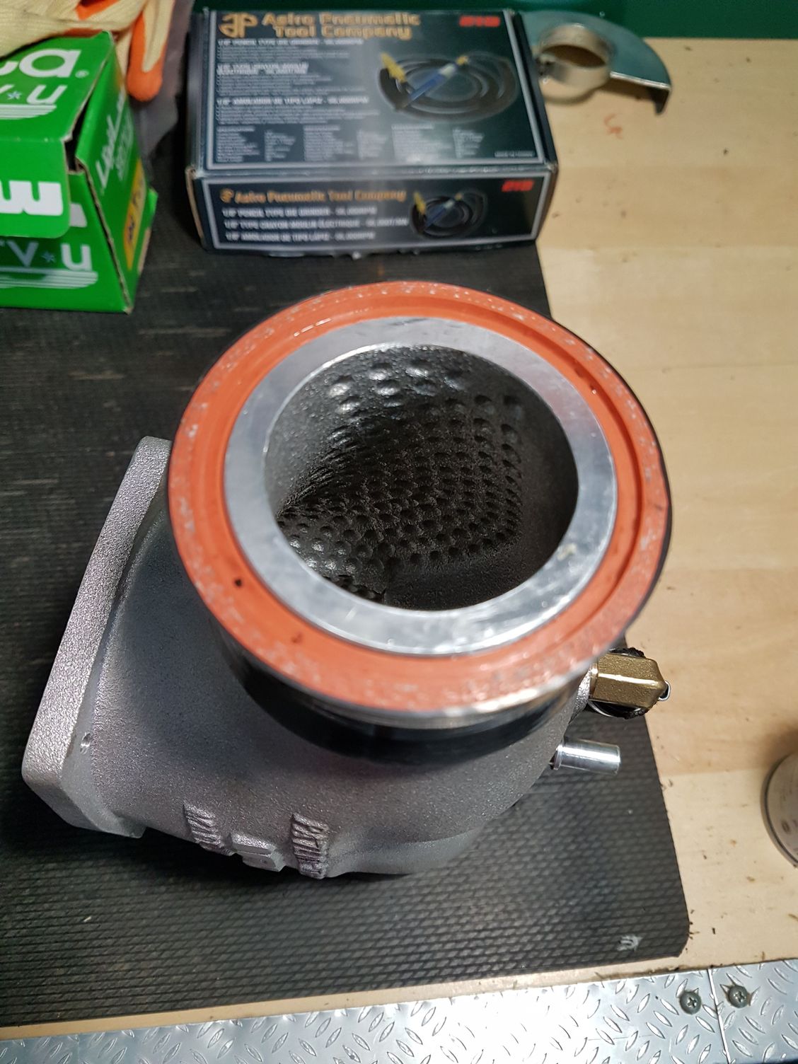

4. I've tried to fit the IPD plenum and failed ! got tired. if anyone has a DIY of fitting the plenum please shoot it.

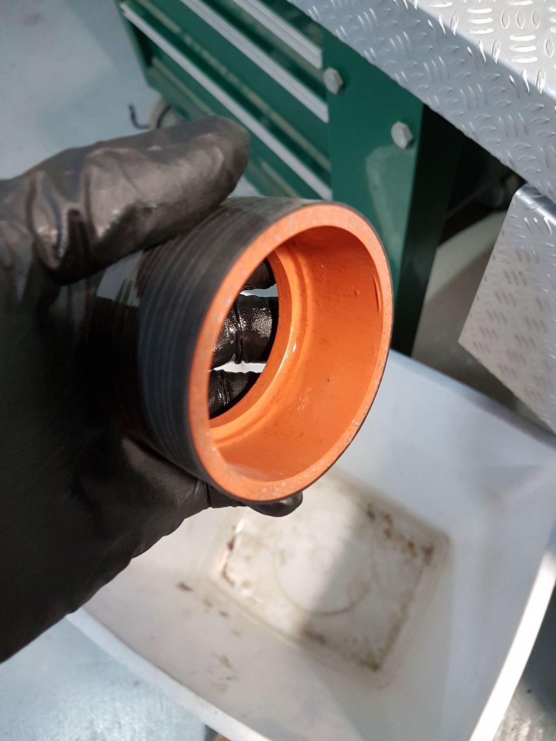

1. fixed IPD plenum, I didn't see a peoper DIY for installing it... but I've figured a way that was super easy... just lube the silicone hoses and push them all the way on the plenum... then position it on the intake manifolds and slide them over... that's it!

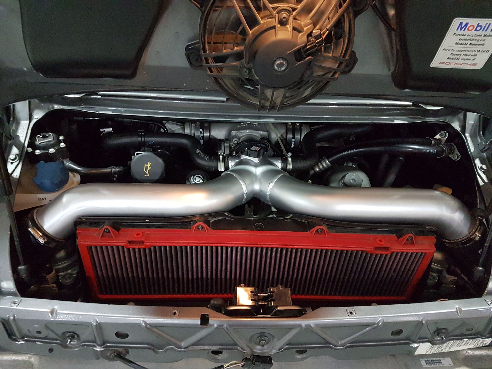

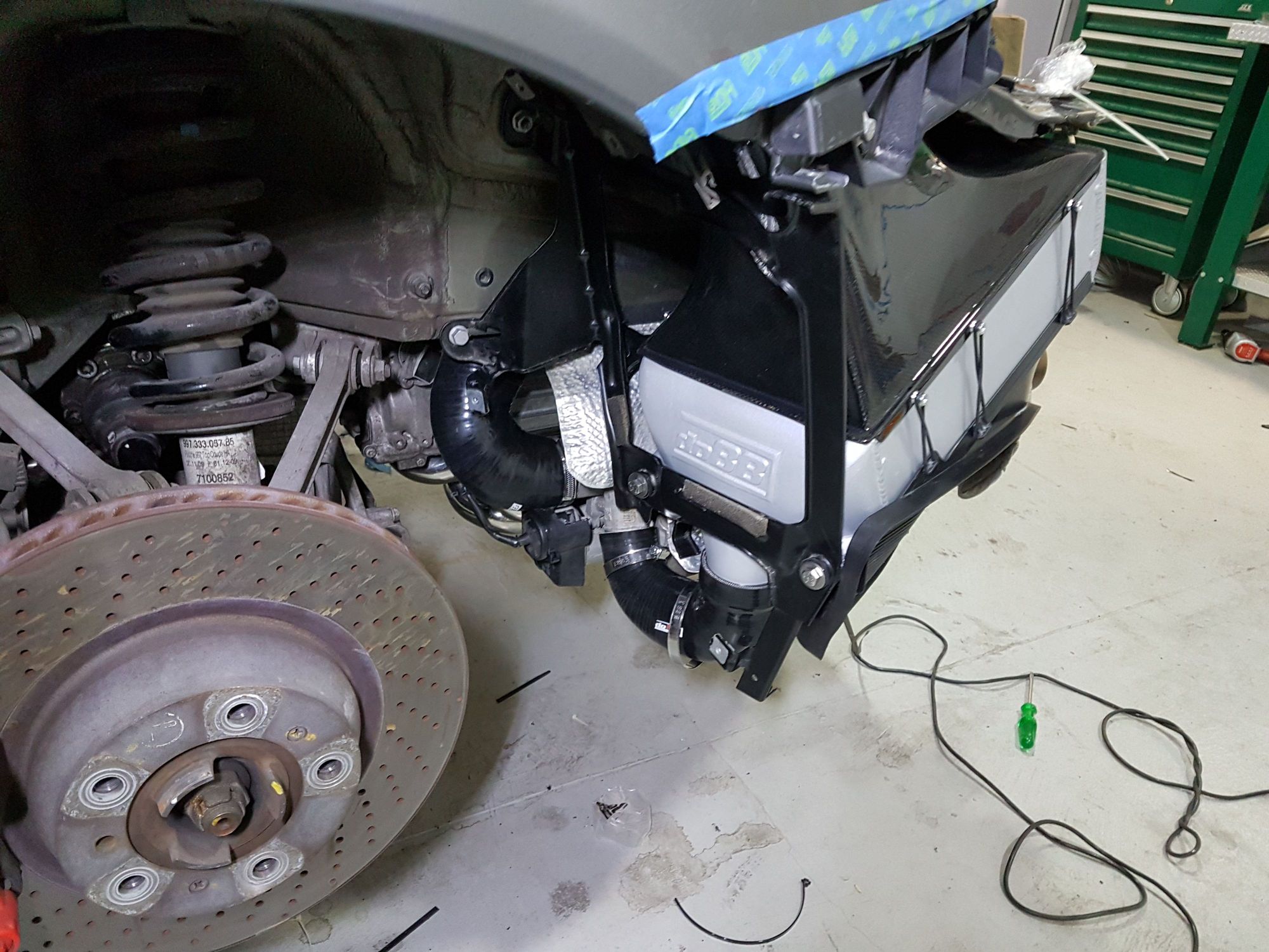

2. installed do88 intercoolers, straight forward, just followed the provided instructions .
3. installed the Throttle body, do88 Ypipe and the rest of the silicone hoses from turbo to inter cooler and from intercooler to Ypipe.

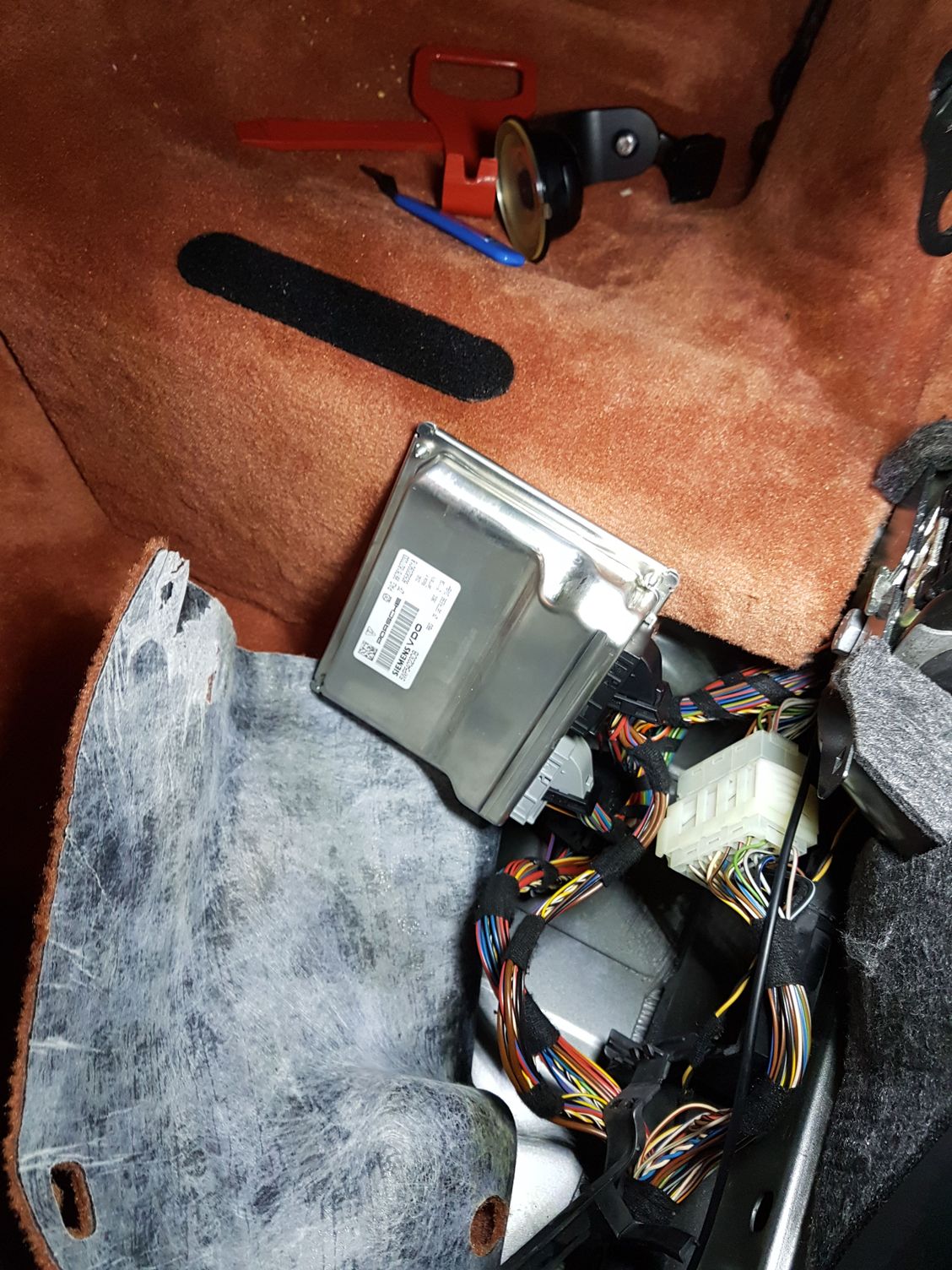

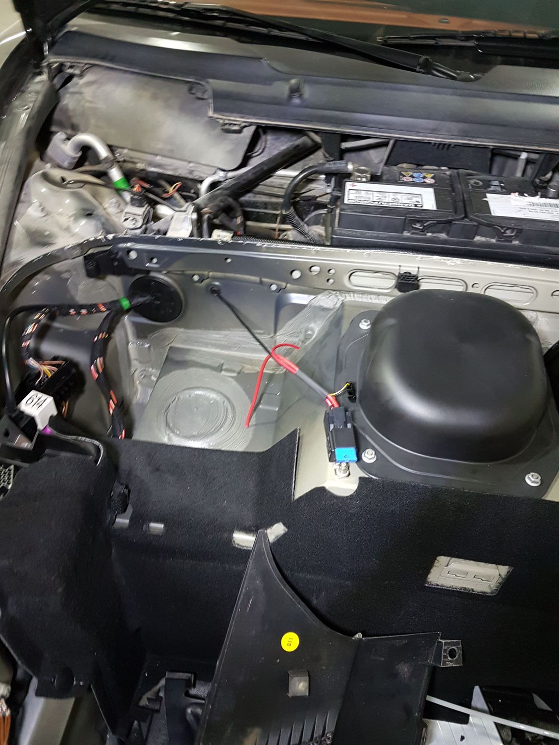

Progress report number 7, 29 Nov 2016
hey all!
I was quite busy with work lately so I didn't put much progress .
but I'm pleased . I've done the following today:

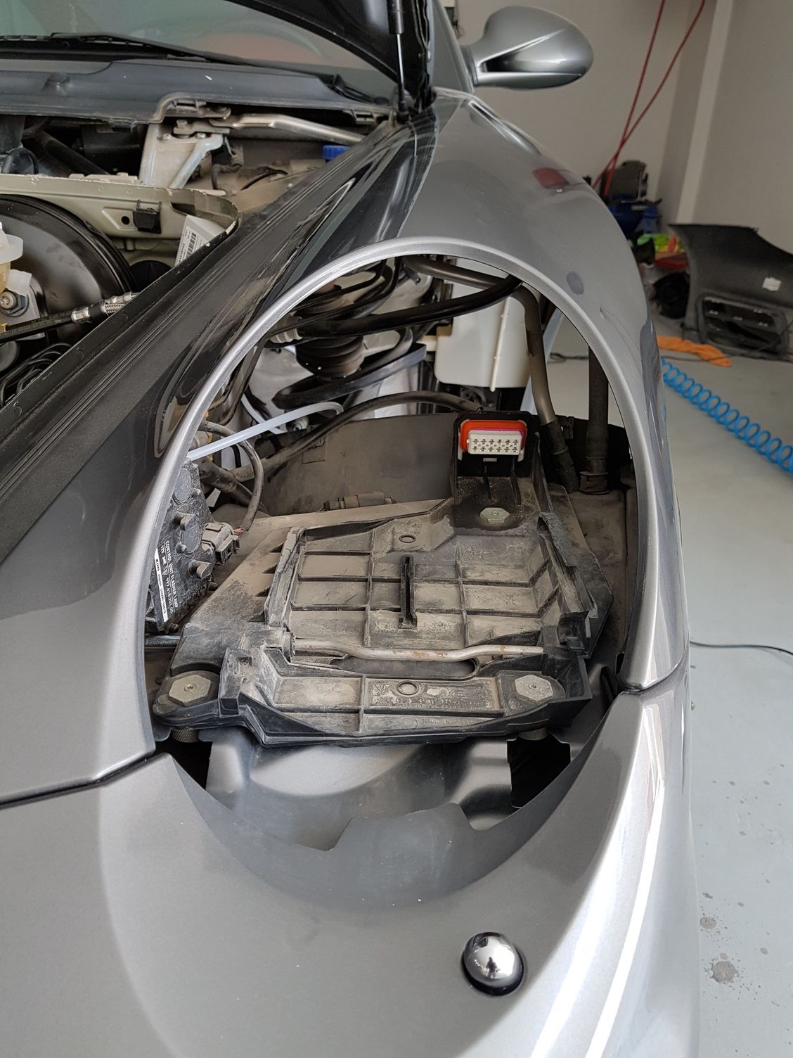

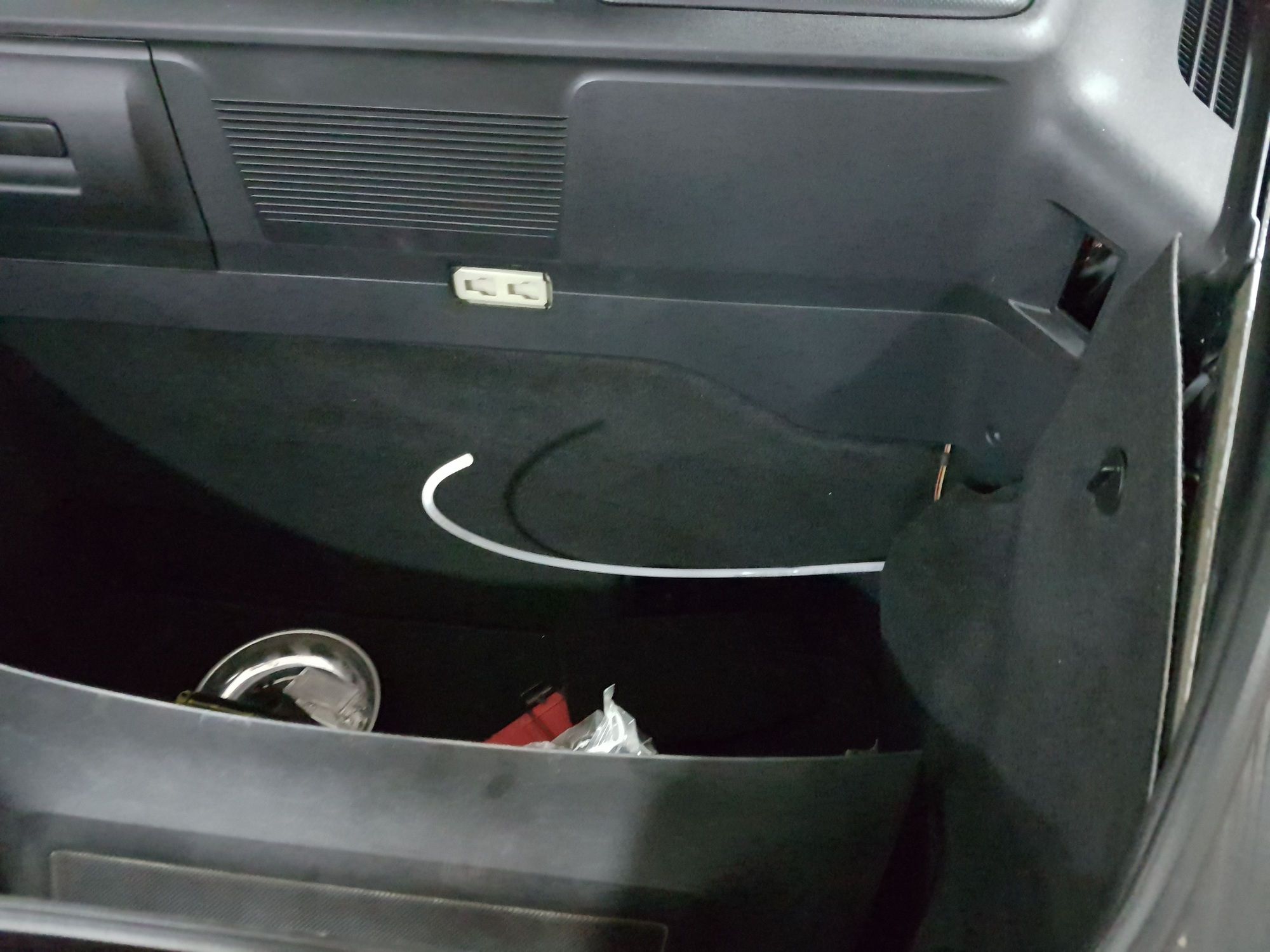

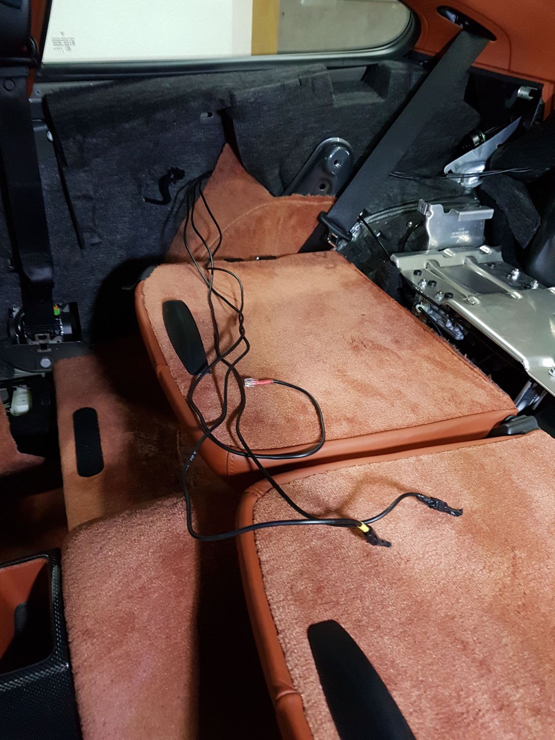

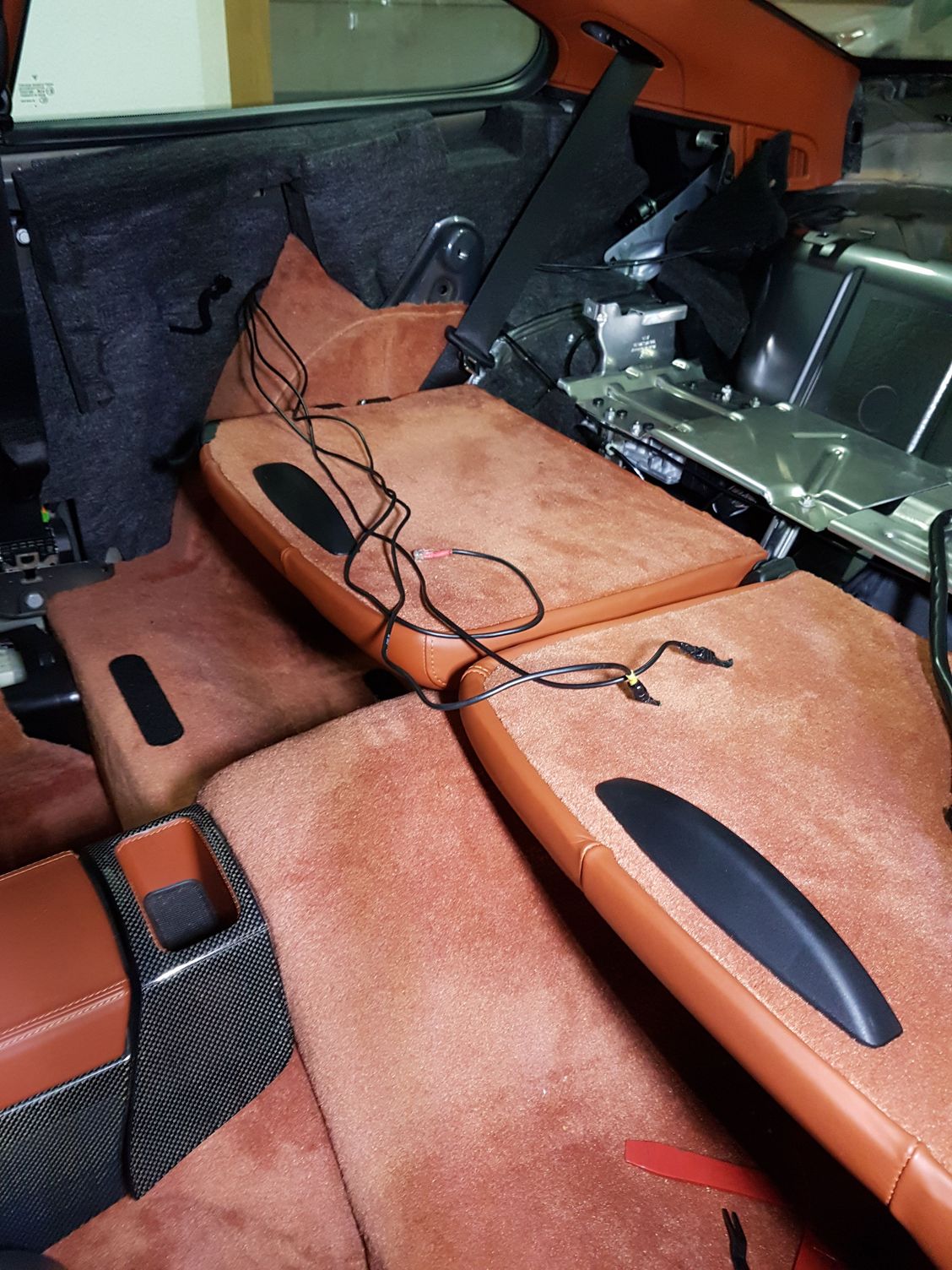

1. I've stripped the interior at the back plus the two B/C pillars panels. removed also the carpet on the driver side to prepare to take out the PDK TCU.

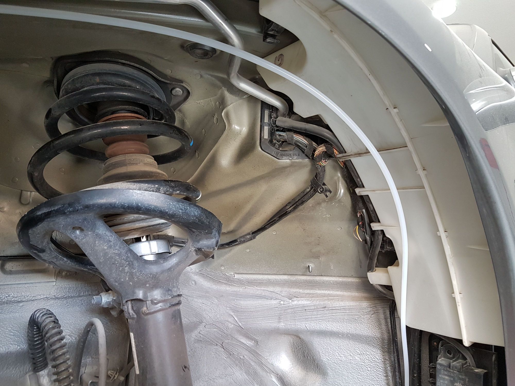

2. ran the FAV wire and flow sensing wire from the engine bay inside to the cabin
3. ran the pump control wire from the trunk at the front to the back seat area. the HFS4 controler will be mounted behind the rear passenger side speaker. it's a tip I've got from friends to be able to access it when needed by only removing the speaker.
4. started thinking about the position and arrangements of pump and tank at the trunk.
