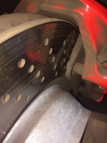

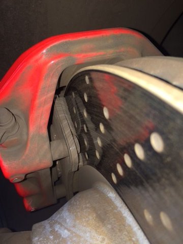

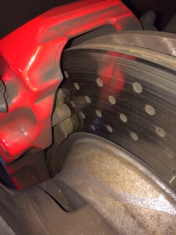

Reviving this thread, searched and searched. I'm almost positive I need rear brakes. Looks like the front are OK. However I need guidance on pads and rotors.
1. Do I need rotors? Recommendations? Sebro?
2. What pads should I use for spirited driving?
3. I've tried doing a brake flush before on previous cars, found it to be a PITA. Anyone have recommendations on newer tools that make it easy? Think I had a motive bleeder
rear passenger
rear driver
front driver
front passenger
thanks

measure rotors with micrometers. compare to minimum thickness on rotor.
For non track work, stock seems to be the choice.
Motive makes bleeding brakes a non issue. You can use the traditional method for one or two cycles on each caliper, just to be sure you have all the air out.
I know my rotors will need to be replaced, so I'm driving the car till the brake pad light comes on.

thanks, i'm surprised my light hasn't come on because my rears look toast. I'll have to give the motive another shot.
So stock rotor and pads?
have you checked to see if your previous owner shorted the sensor? They look low for sure, but not end of the world.
Stock pads I think are the best for the street, despite being dusty. You could try out the sebros, I haven't seen any objectively bad reviews

Stock rotors needed. The rears are ultra thin. I love my hawks ceramic. Just glad they are finally going to have the fronts this year.
