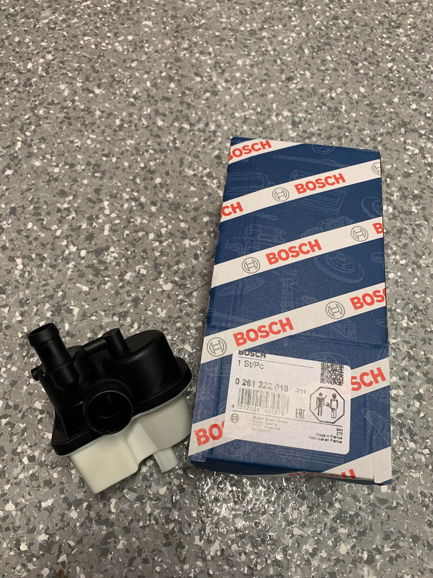

I might have finally fixed the P0455 Tank system - major leak CEL that would trigger frequently.
1) I went to a dealer that told me it was the vent line located in the engine bay - so I paid them for the diagnosis, bought the part and replaced myself.
not it.
2) I went to an independent shop that smoke tested the car and did not find a leak, but replaced the fuel level sensor.
nope. (still get a code for the fuel level sensor. someone suggested they may not have calibrated it - *sigh*)
Did a bunch of digging and found some posts on the cayenne forum that suggested that it could be the fuel vapor detection pump. The bosch part is $60 on amazon The leak diagnosis pump is inside the charcoal canister located in the frunk. It's a bit of a fiddly fix, but it is possible without too much trouble. I replaced the pump and I'm 200 miles and no CEL. It usually would come back after a few miles of driving.
the pump is inside the canister
even though I could hear the pump turn on and off when controlling from the durametric, it was most likely cracked or performing poorly.

Looks like they were trying to replace the leak detection pump - same as me. The info you posted helped me get into the carbon canister. Replacing the pump has fixed my CEL / P0455 error code.

@andrewgt3 I've had the same P4055 CEL since I bought the car three years ago. The previous owner disclosed it and noted that the dealers he worked with weren't able to resolve it.
I was never able to let the tank go below 1/4 without the light coming on, and couldn't fill it all the way without the pump stopping -- so my realistic range was like 130-150 miles. I tried a new gas cap and nozzle adapter, and brought it to a reputable indy who basically wanted to rip out the whole fuel system lol.
Anyway, saw this post and for $60 decided why the F not. "Fiddly" is the perfect word to describe the installation. I got hung up on a few things like reattaching spring clamps onto the charcoal cannister and removing one of the screws on the side of the pump, but it was totally DIY-able. 200 miles later, no CEL and I was able to fill the tank without any issue!
THANK YOU so much for taking the time to share this fix! You've saved me $$$ and given me more time to enjoy driving instead of thinking about that damn CEL
