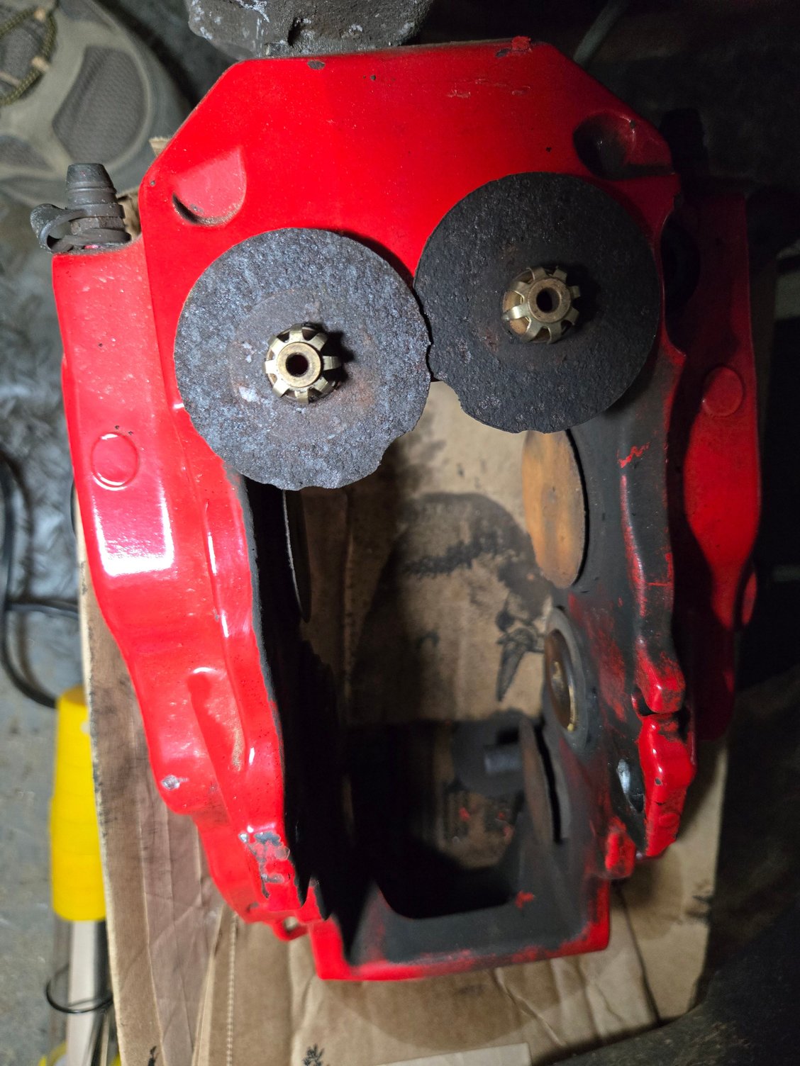

Default I have a seized caliper bridge pin !
 New pin
New pin
Nut off 13mm
Nut off 13mm
Pin stuck
Pin stuck

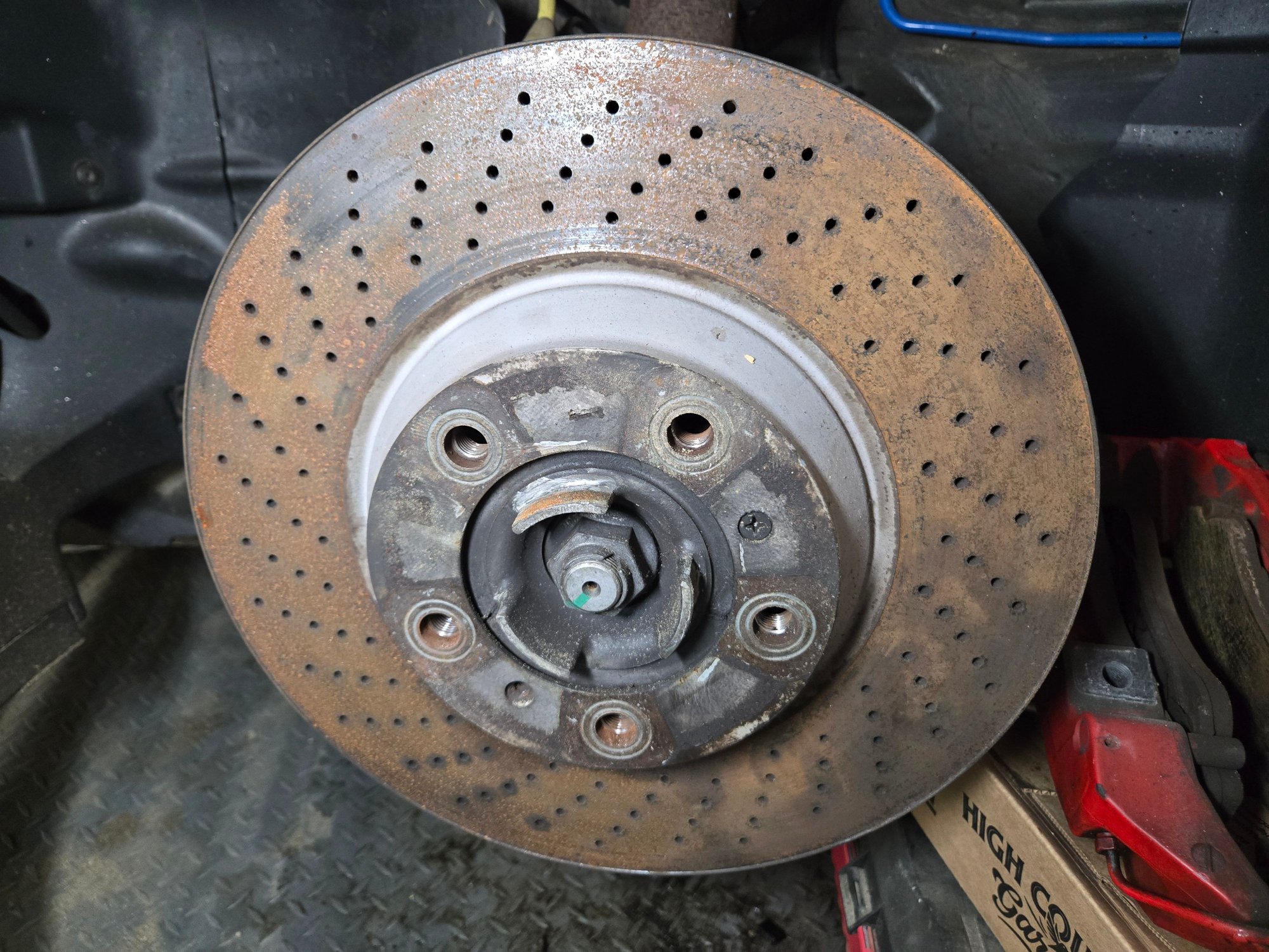

380 mm ?
350mm front rotor; 34mm wide.
6 piston
6 piston
Pagid, but digits are blurred.
Old T55 caliper bolt is perfect for hammering pin out. But first, pushed pads into pistons to free their grip on pin.
28mm pad dampers.
28mm pad dampers.

I would clean house with those brakes and have them rebuilt based on how they look and give the system a full fluid flush. Your life depends on brakes.
For street use I run Cayenne rotors up front (dimpled and slotted). Stay away from cross drilled-they tend to crack. I run Hawk pads with virtually zero dust. Rear rotors are OEM because I haven't found a good alternative and they are just along for the ride.
