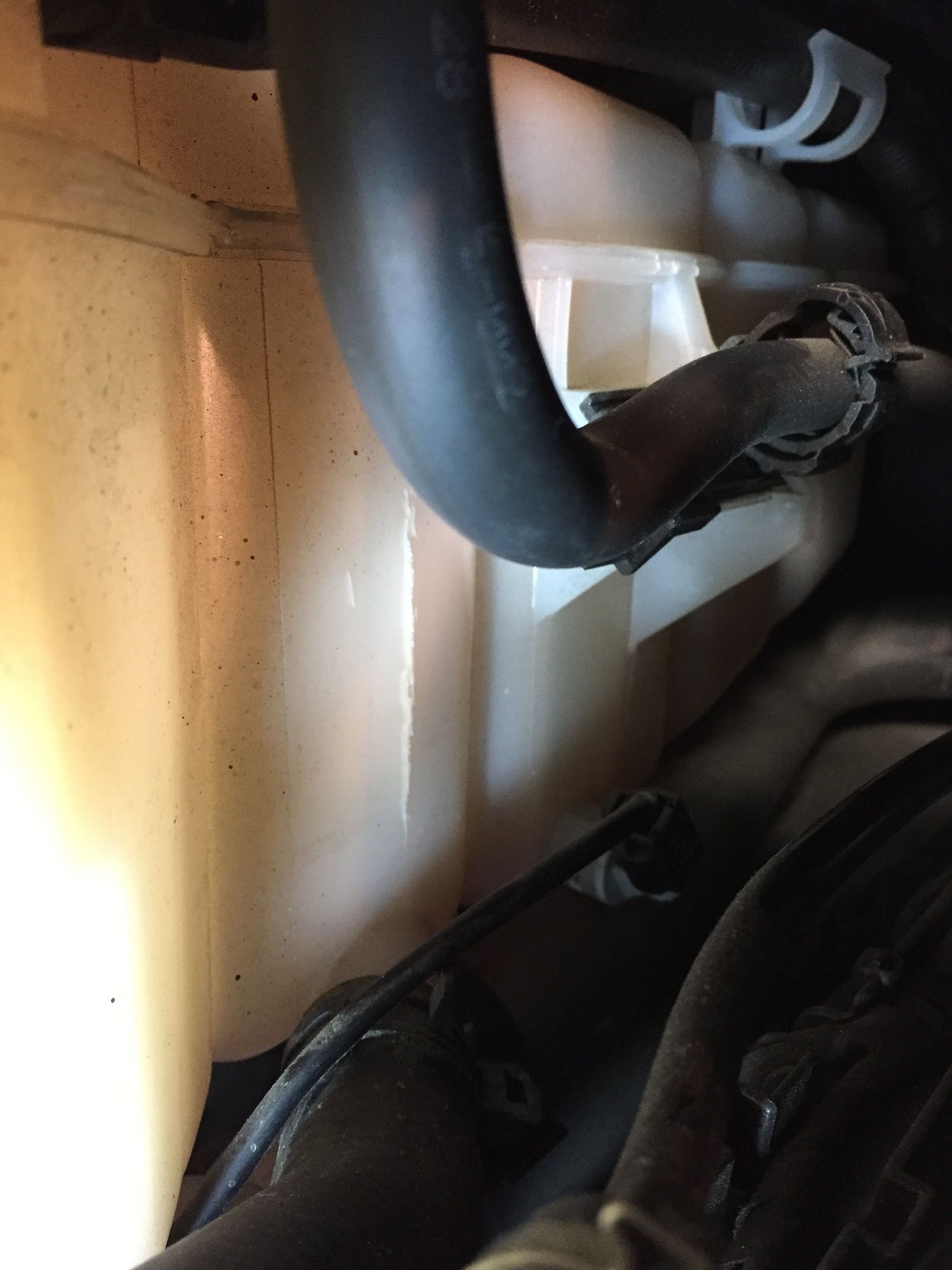

Mine looked like this when my indy gave the car back.
Patience Para82.
Stick your cell phone on video and get a shot of your suspected leaky tank.

That vertical crack is exactly where mine is although mine isn't leaking yet. I wonder if on reinstalling a new one if a thin aluminum shield in that area would help. The tank would still pressurize the same but perhaps heat from the outside would be reduced
Same crack without leakage for me also. Replaced as preventative. Not a fun job but doable with patience. Would go much faster second time around. Hope that day never comes.

Did the tank replacement today. Already had car up on jacks for water pump and thermostat replacement, as well as air filter housing removed. That saved me half an hr or so. I ended up dropping the engine about 2" or so - maybe a bit more. That helped make more room. I also have a cable-style clamp removal/installation tool which makes the task of reaching all of those unreachable clamps possible.
Edit: added pics. Looks like the failure location on the tank is very consistent.

I have been having a coolant smell around my '06 C4S for a while. I found this thread yesterday and went out to check out my coolant tank. I found it to have the same white lines mentioned, so I assume it is cracked. I ordered a new one from Pelican.

I did my coolant reservoir on my '06 4S today. It went really well once I got the motor dropped far enough for clearance. It took three hours, of which over 2 hours was spent on just getting the old tank out.
Mine had the typical crack that everyone mentions.
