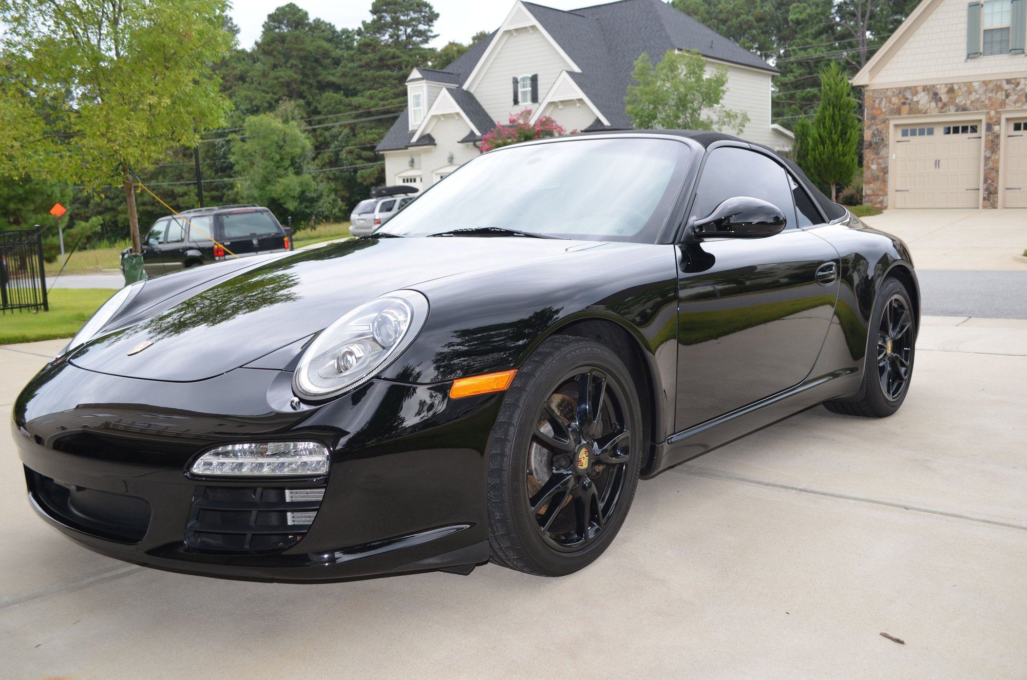

Thanks! I seem to recall you mentioning your spacers were RSS. I almost went with those from Sharkwerks though these from FVD were a tad cheaper and had another reference on kudos from FVD. I'll be sure to let you know how this turns out and send pics.
Robbie did actually start on the wheels today and they emailed me a few pics and they look pretty fantastic. They will definitely pop against the black.

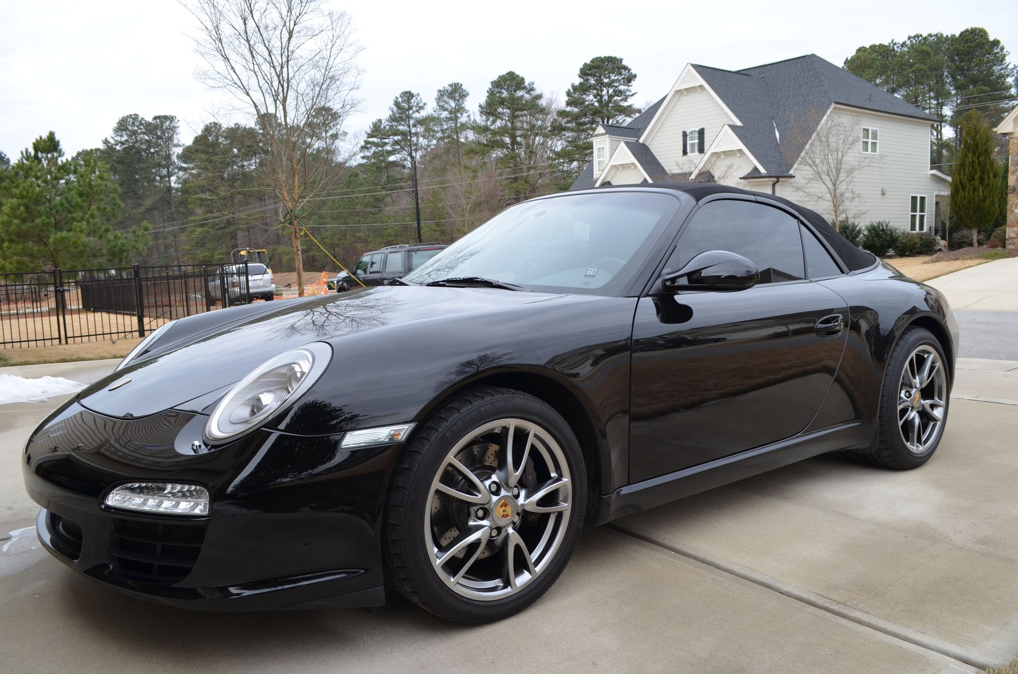

I ended up with 7 in the front and 15 in the rear. I still need to lower it which will be a project this summer. Also what you see here is the Carrera IVs were refinished from OEM black to a Chrome Shadow effect to break up the too much black thing and murdered look. Overall, I'm very pleased and can tell a difference from the stock stance and the wheels definitely look nicer.

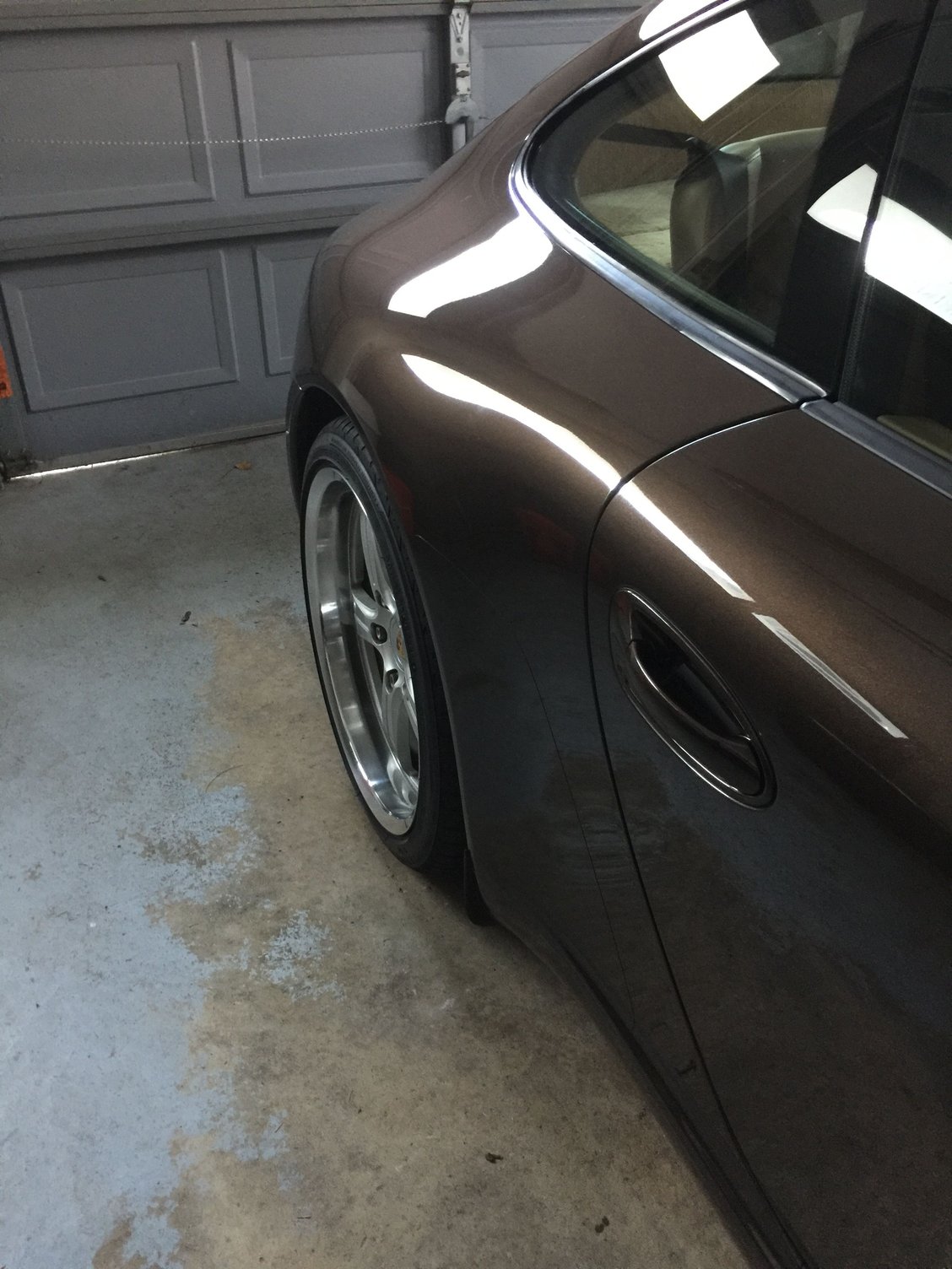

- oem height pasm on my c2s narrow body.
- rear 19x11 +51 wide body (equivalent to oem narrow body +67 with 16mm spacer)
- front 19x8 +42 (oem narrow body +57 with 15mm adaptec spacer)
- oem turbo II wheels
fronts 235/rear 305
I'm happy with the fact that both front/back look flush... though i wasn't thinking and should have bought the black spacer/lug bolt combo DOH!!!
don't forget to apply anti seize!

That chrome shadow choice is a great improvement. It the last few years so many seem to choose to go all black but I think this look is much better. Your spacer choice will set them on the car just right. Tasteful choices!

Thanks SR! I think this will hold me over until I can justify getting some Turbo IIs like Mike (myw).
I have to give credit to Iceter, he is local and has his Carrera IVs done in chrome shadow and seeing those really sold me on the refinishing. They do grow on you, and they look much classier and cleaner than the black on black.
