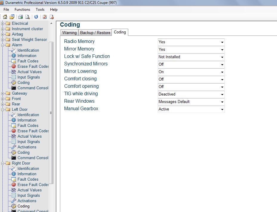

According to the following thread, terminal 15 signals when the ignition switch is turned to the On position. This makes sense since I've seen it mentioned that you can program the doors to lock immediately when the car is started.

i would give the terminal 15 a try (no idea what it is) and see if the car behaves differently at all or not. if it throws a code (or makes no diff) you can easily change it back.
Originally Posted by Bruce In Philly
Please.....
I thought some folks would be interested in seeing what the Durametric coding sections look like. Here are two shots of the coding sections required for comfort windows. Note there are places for door locking.... but they flip back after I set them. Bonus question: Anyone know what "terminal 15" is?
Peace
Bruce in Philly

btw guys has anyone gotten sync mirrors to work? my car does have memory (adaptive seats) and i am wondering if BOTH side mirrors can lower automatically when the car is in reverse.
Old Jun 8, 2015 | 09:56 PM
  #64
Quadcammer's Avatar
Quadcammer
Race Director
Joined: Nov 2006
Posts: 15,863
Likes: 1,632
From: Clifton, NJ
don't think thats an available option.

Anyone figure out the door locking glitch? I got my 997.2 to work for a couple min, then reverted back to not locking automatically.
If you find the answer, PM me.... this is the only feature I really want.
What you experienced is the same thing a tech would experience with the Porsche computer. I watched it happen and the exclamation from the tech. It works once, then reverts (maybe a time issue where the system cycles).
This happens if you don't have sport chrono like me. With Sport Chrono, you get more options in the PCM screens, one of which is the door locking option. Porsche doesn't want us dicking with their marketing schemes.
