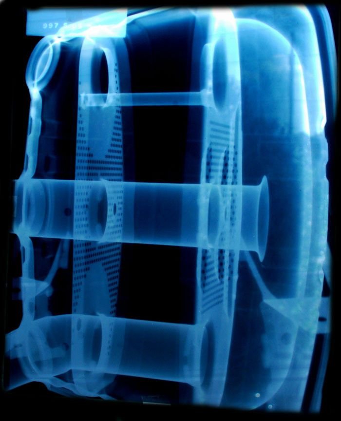

The Gundo/Fister mod flows part of the exhaust directly from the intake to the output pipe, while the PSE always flows all of the exhaust through the muffler regardless of setting. I recently saw the first photo on a UK 911 site showing a broken PSE cut open from a 997.1 (the 997.2 may be a little different but from the outside it appears similar in approach). The extra PSE pipe is on the right, the input is on the left. It's hard to see, but the center output has a long tube sitting close to a mesh, while the reflection to the right of the mesh reveals a simple open hole (maybe 3" or so) in the back internal plate. You can see it better in the second image from an x-ray from a non-PSE muffler which is built similarly but is missing the extra output and the input releases into the back chamber instead of the middle like the PSE.
In my experience the Gundo/Fister mod gives a little more raspiness/rawness in the exhaust note than the PSE while the PSE retains a little more throatiness (which I prefer but the cost premium is certainly high). The end result has similarities in volume but to my ear, the two are noticeably different in tone. I'd also assume the PSE retains a little more back pressure and has less effect on low end torque.
there also appears to be a hack/opening immediately as the inlet pipe enters the muffler

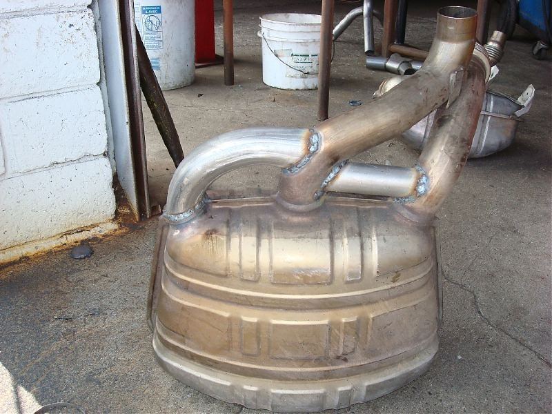

if you have PSE, then you just need to weld together the inlet and outlet pipes (aka the Gundo). If you only have standard exhaust, then weld together the PSE port and also the inlet/outlet pipes.
Something like the attached photo (not mine).
