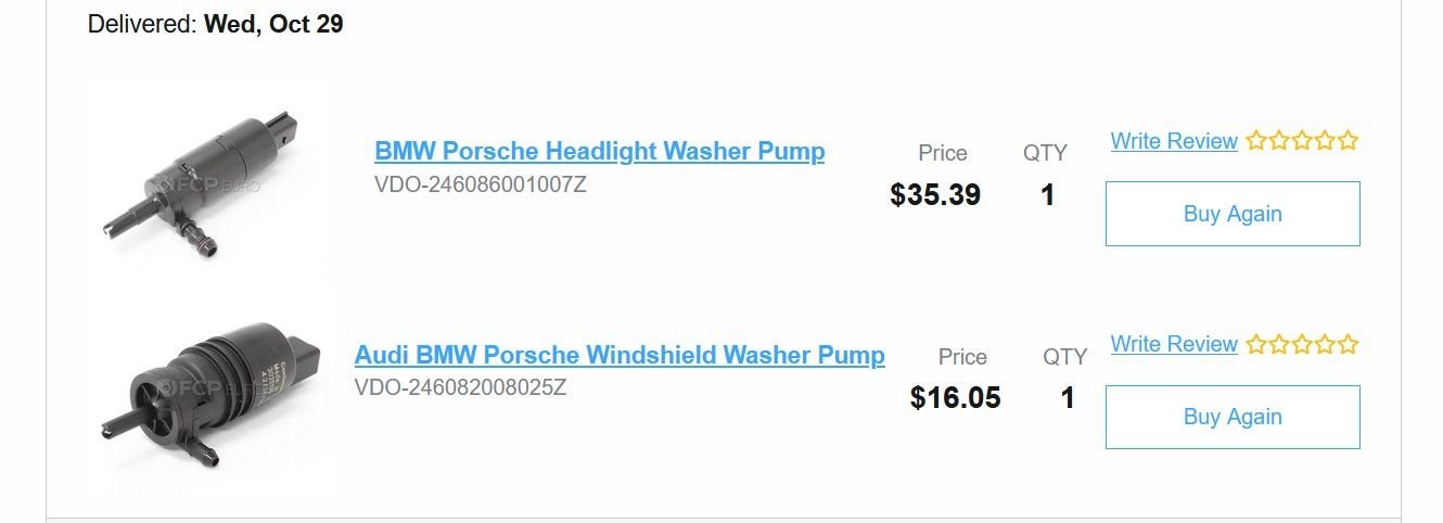

Oops I didn't mean "in" the tank, I meant mounted "on" the tank.
Maybe I have the pump purpose mixed up. But the one leaking for me, was the vertically mounted one. You can just follow the hoses and see where they go. I replaced both because they were so cheap and my car is getting old.
Peace
Bruce in Philly (now Atlanta)
From my order a few months ago...
