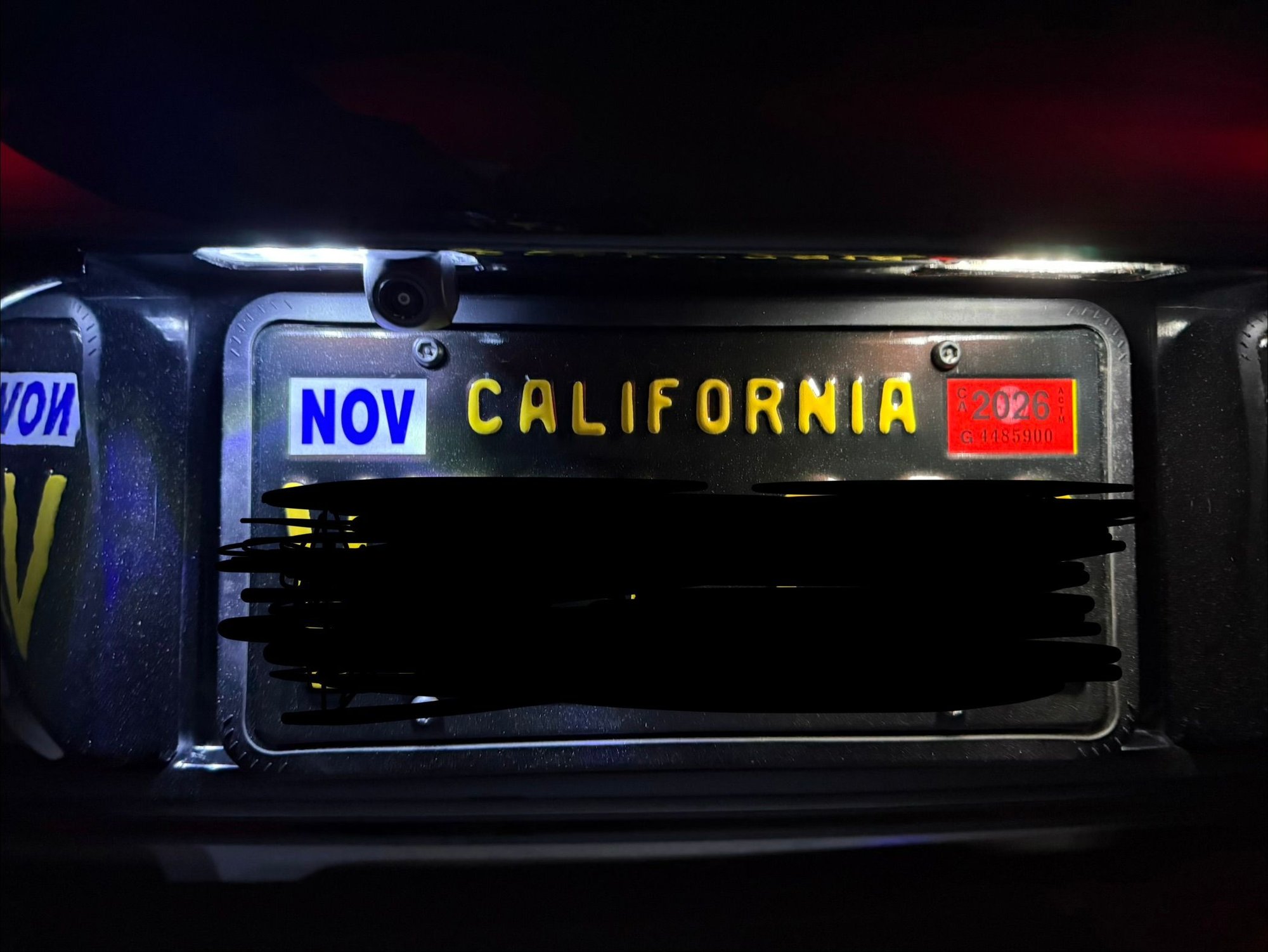

Can folks share what camera models they're using? Looking for recommendations for a license plate mount or another mount where I don't have to drill.
Thanks!
Old Apr 21, 2026 | 02:02 AM
langsamfahren's Avatar
langsamfahren
Joined: Oct 2024
Posts: 259
Likes: 91
From: San Jose, CA
Thanks!
I got this one from AliExpress over a year ago:
https://a.aliexpress.com/_mtE3XqZ
No longer available from this seller but there are similar ones. Picture is good, just needed this RCA video isolator to deal with the noise and picture was clearer after:
https://a.aliexpress.com/_mrGmKZL

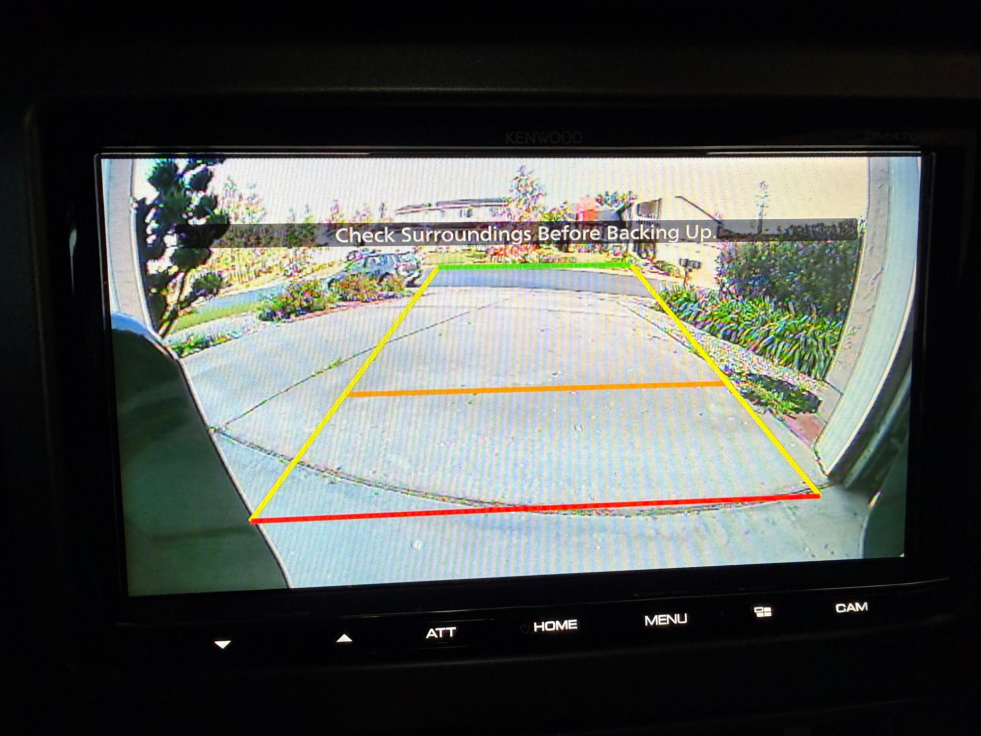

Old Apr 21, 2026 | 02:12 AM
Osubeaver's Avatar
Osubeaver
4th Gear
Joined: Mar 2026
Posts: 4
Likes: 6
Thanks for the tip on the ground loop, I just installed one over the weekend and am getting the lines in the video.
This is the camera I installed
https://a.aliexpress.com/_mqMKLxL
