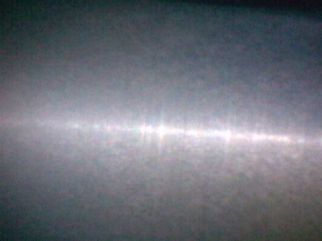

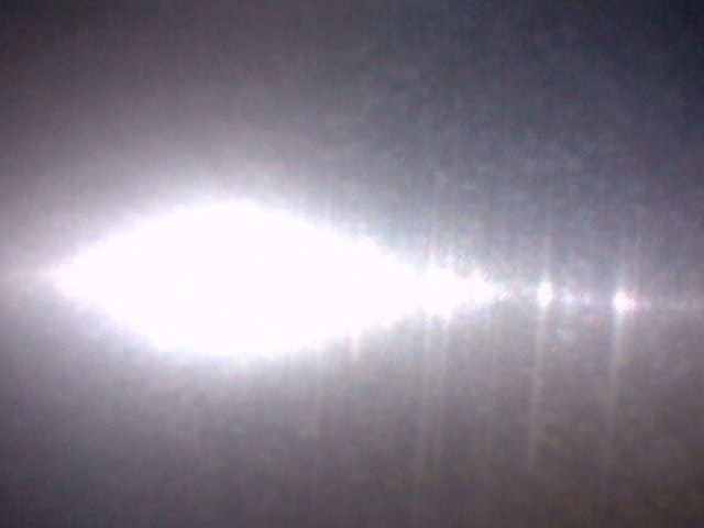

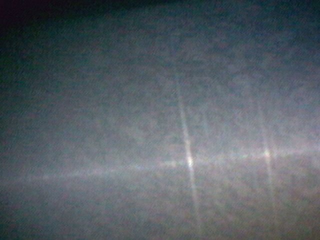

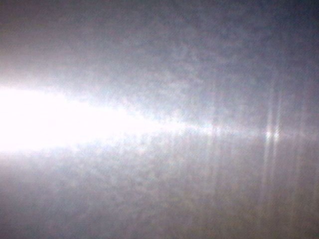

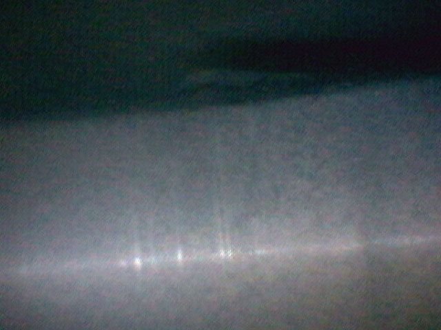

2015 GTS 7MT with 43k miles. I had a PPI done with bore scope at an Indy shop that specializes in Porsche and they sent me the below photos and said they found light bore scoring on all cylinders. I spoke with them on the phone about it and they advised I walk away from the deal. I live in GA but this car is up north in the colder climates.
What are everyone's thoughts?

You should request sharper more focussed photos - I question some of the more pronounced marks in the last 4 photos.
They look "deeper" than normal streaks but the poor photos make it difficultm to determine.
