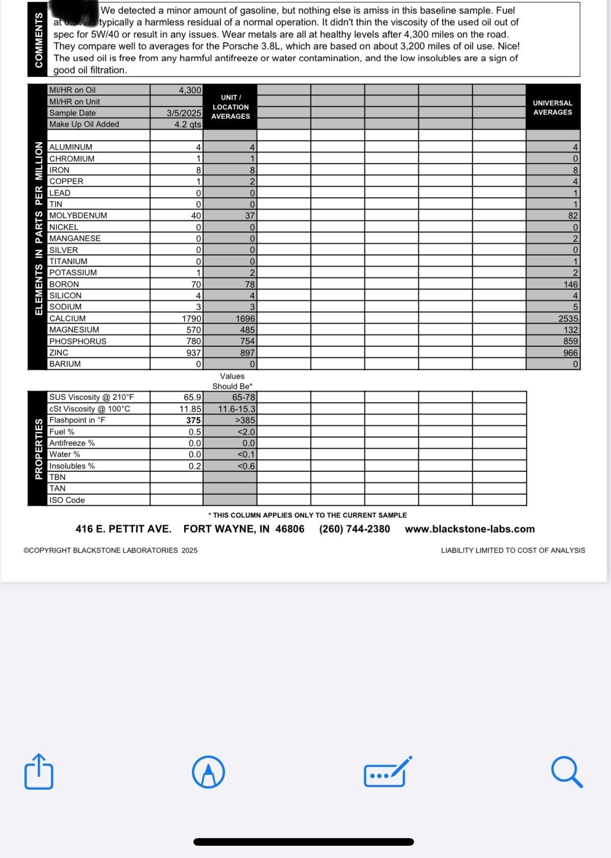

Post the UOA report
Old Mar 31, 2025 | 12:31 PM
M3Cavalry's Avatar
M3Cavalry
Joined: Jun 2013
Posts: 124
Likes: 27
O
OK

Not bad. Iron is a hair high - just keep an eye on that for future samples. LM usually has high iron and copper and Motul higher iron, but your aluminum and copper look fine. Higher zinc & phosphorous content might help with the iron wear.
