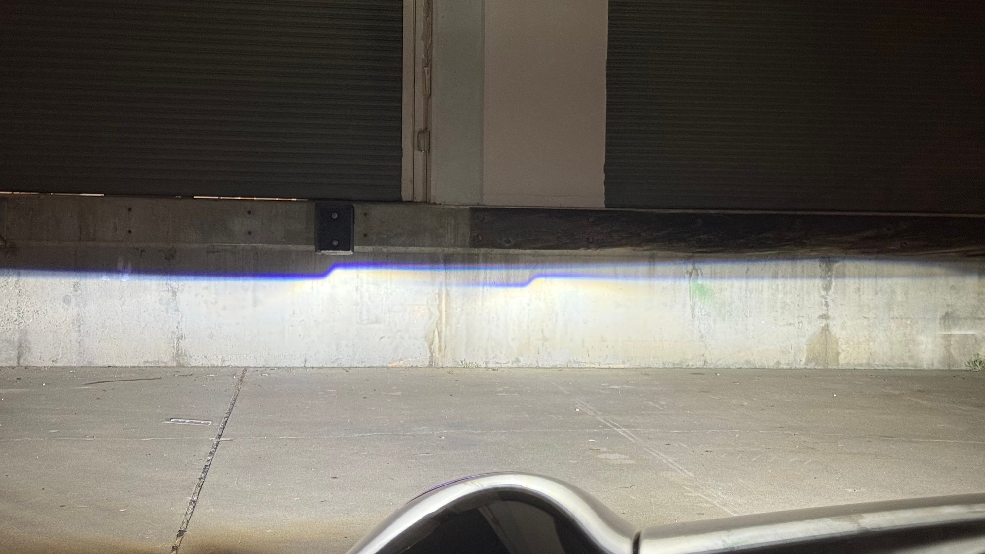

Half vent/half sharing feedback/review of my Morimoto HIDs. Short version, wildly unhappy, the stock headlights are far superior in every way except candela output, and that isn't a deal breaker in this instance. Going with bullets for ease.
- Installation is no different from factory headlights, except for the additional wiring to enable the Daytime Running Lights (DRLs) The wiring however could not be routed as described in the instructions and I had to run them through the aiming adjustment pass throughs.
- You can definitely tell they aren't made in Germany, but not so bad I would say they are made in China.
- Programming the DRLs wasn't difficult, but the headlights immediately generated multiple warnings. (which they mention on a secondary website page, not the primary page, which I felt was disingenuous) Apparently you can use a PIWIS to code it out, which I both don't believe and would be uncomfortable with anyhow. Driving with a flashing light on the dashboard is distracting and prevents me from actually knowing if the brights are on or not (yes, I can the difference if it's dark out).
- The headlight adjustment on one side didn't go as high as I needed and have spent weeks arguing with the company. They basically ignore my points, talk in circles to shirk responsibility and patronize me while claiming they are trying to help resolve my issue. They absolutely don't care about customer satisfaction.
- The headlight output is incredibly sloppy, as shown in the picture. The cutoff is harsh and not parallel, the steps don't align, and the right headlight puts a dark spot right in the middle of the road.
- Pointless gripe, but there is no way to disable the DRLs without opening the frunk.
- Finally, pretty sure they deleted my original review off the website.
Overall, I would say give this company a wide berth, there are options to repair stock headlights (rennlights) and any issues you may run into will be met with scorn. Certainly not worth the $1800 retail (plus tax).

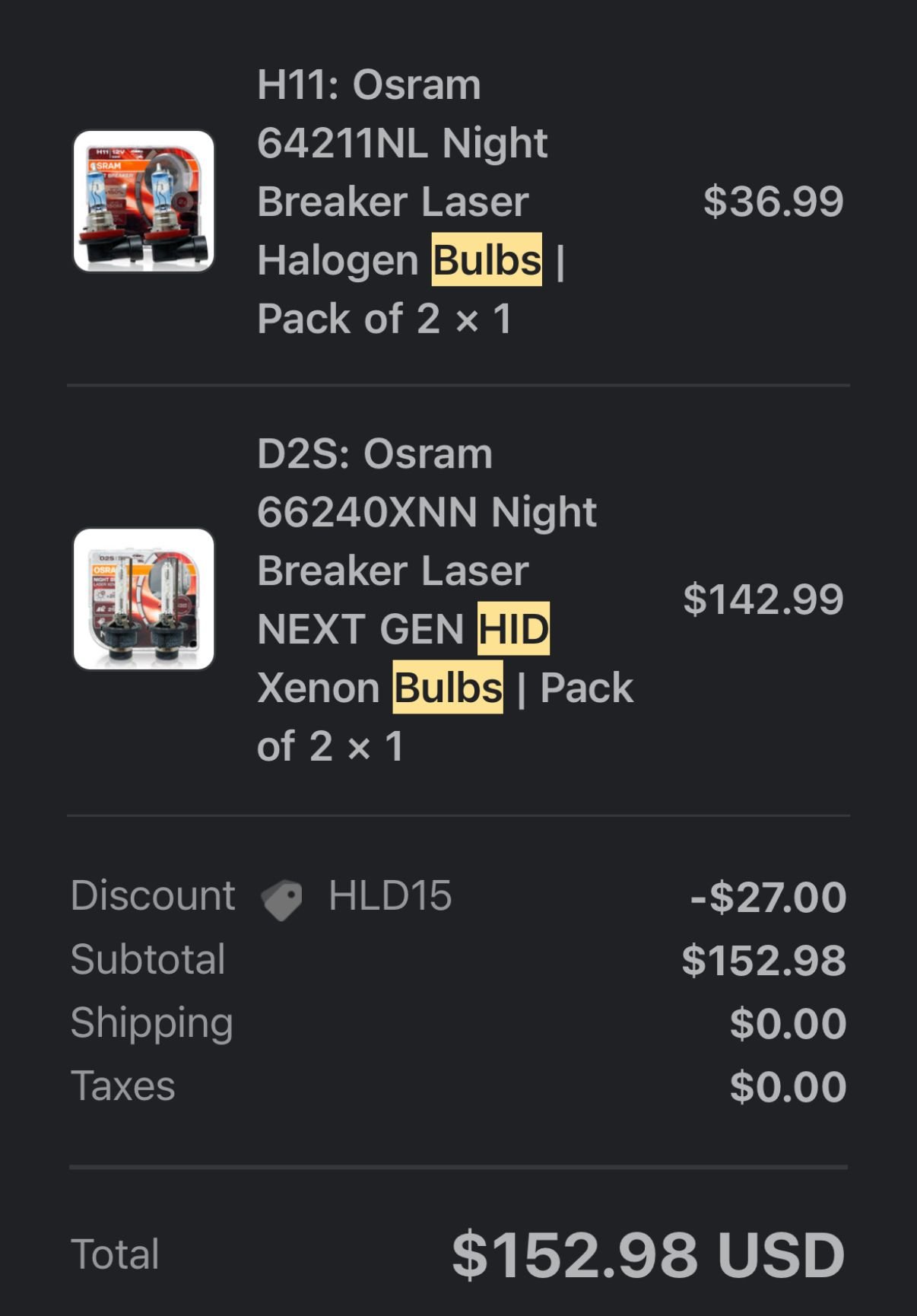

I don’t have experience with Morimotos but I recommend trying to first replace the bulbs. I swapped my dim 2010 997.2 HID
bulbs for Osram Night Breakers and it made a huge difference. Old bubs dim over time and it’s worth $150 to give it a shot.
