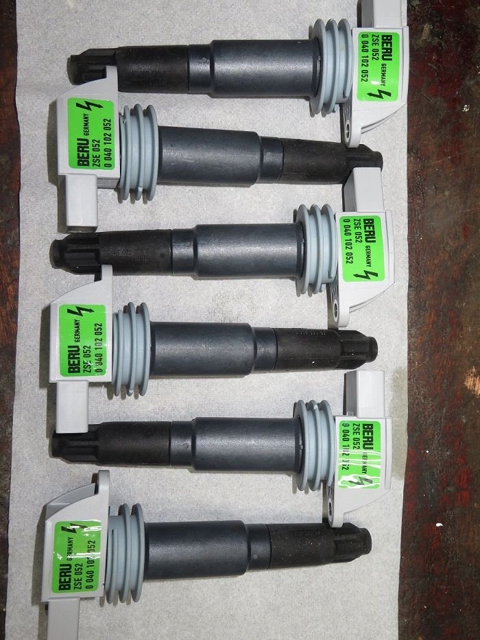

I had more or less the same error codes and changed all plugs and coils. Problem solved!!
A coil pack can produce an internal spark and so producing an Electro Magnetic field. Probably the PDK control unit is susceptible for EM fields. (EMC)
New coils
regards Hans
