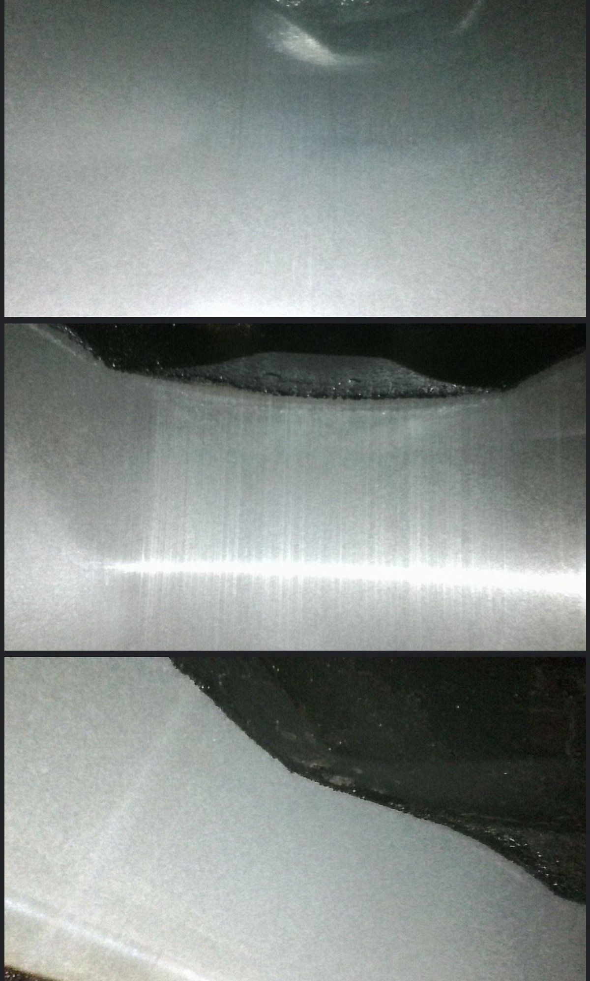

Thank you all for your help and advice, I am glad I got this car bore scoped on bank 2. Cylinder 6 in the middle picture below, that is scored, right?

I would say scuffing by those photos IMO. Plenty of life left. Use a high Moly oil as a preventative measure such as Driven DT40/FR50.
Best bet is to ask @SlakkerRacingDev or @lnengineering for a professional opinion.
This is scoring:
I'd agree with Graufuchs - Looks like scuffing. Nothing too deep.

So you are saying this is not a deal breaker? It’s just a normal wear for a cylinder 6 with 77k miles?

Looks like normal piston ring wear to me, the reflection of the light in the second picture just makes it look more pronounced than it is. You can kinda see it in the other pictures as well. Main thing is no deep grooves or discoloration.

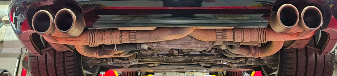

I just noticed driver side tail pipes appear to be a bit more sootier than the passenger side. Do you see what I see? When it comes to bore scoring, is this how tail pipes look with scored bores?
Few things things:
1. Those undersides look oxidized as hell. Is this a car that was driven during salt road winters?
2. Is it Manual Transmission?---->If yes did you get an Over Rev report
3. What are the Cam Deviation numbers?
4.---->As far as the Bore Scope photos you uploaded, that middle photo of cylinder number 6 looks "ok" but those streaks seem to be condensed into a smaller portion of the cylinder. Usually with the BSI I have seen or had done any light streaking is spread out more.

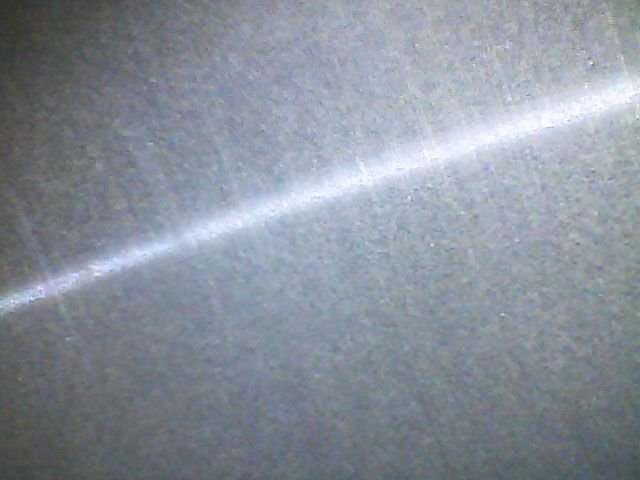

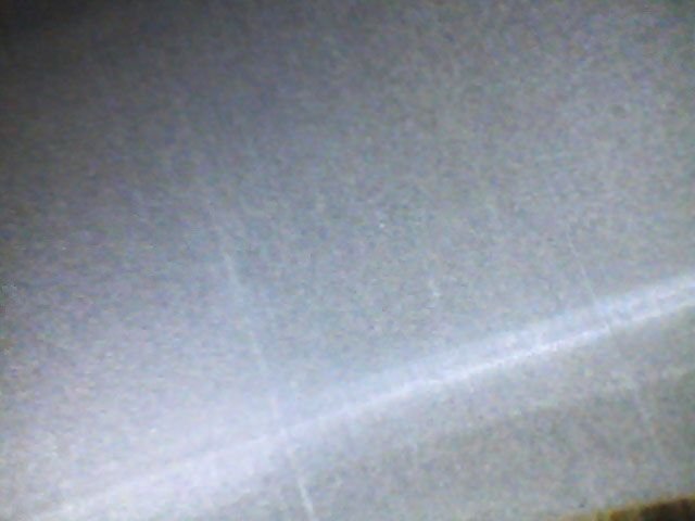

Here's a recent example of what I'm trying to describe - Here are 2 photos of cylinder#6 on my 2006 C4 w/80K miles that I just had PPI's/Bore Scope Inspected 2 weeks ago and purchased in Southern California.
You can see the streaks on cylinder walls are more faint and spread out:
Not that your cyl#6 is a deal breaker but it seems to me a bit more streaked and as long as you are aware - Grind on the seller about that cylinder and chew him down.

The car spent its life in California, Arizona, and Texas. Maybe humidity in Texas is the reason for all that rust?
The car is a manual coupe 997.1 CS, and I didn’t get over rev report.
