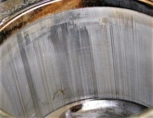

The 5 Bore Scope Inspections I have had performed on 997S cars with 70-90K miles, all had scoring 90-100% of the way up the cylinder wall.
I'll stick to my Spark Plug Hole method for $250.
From Da top:
2 of the engines I had BSI - From Da Top
