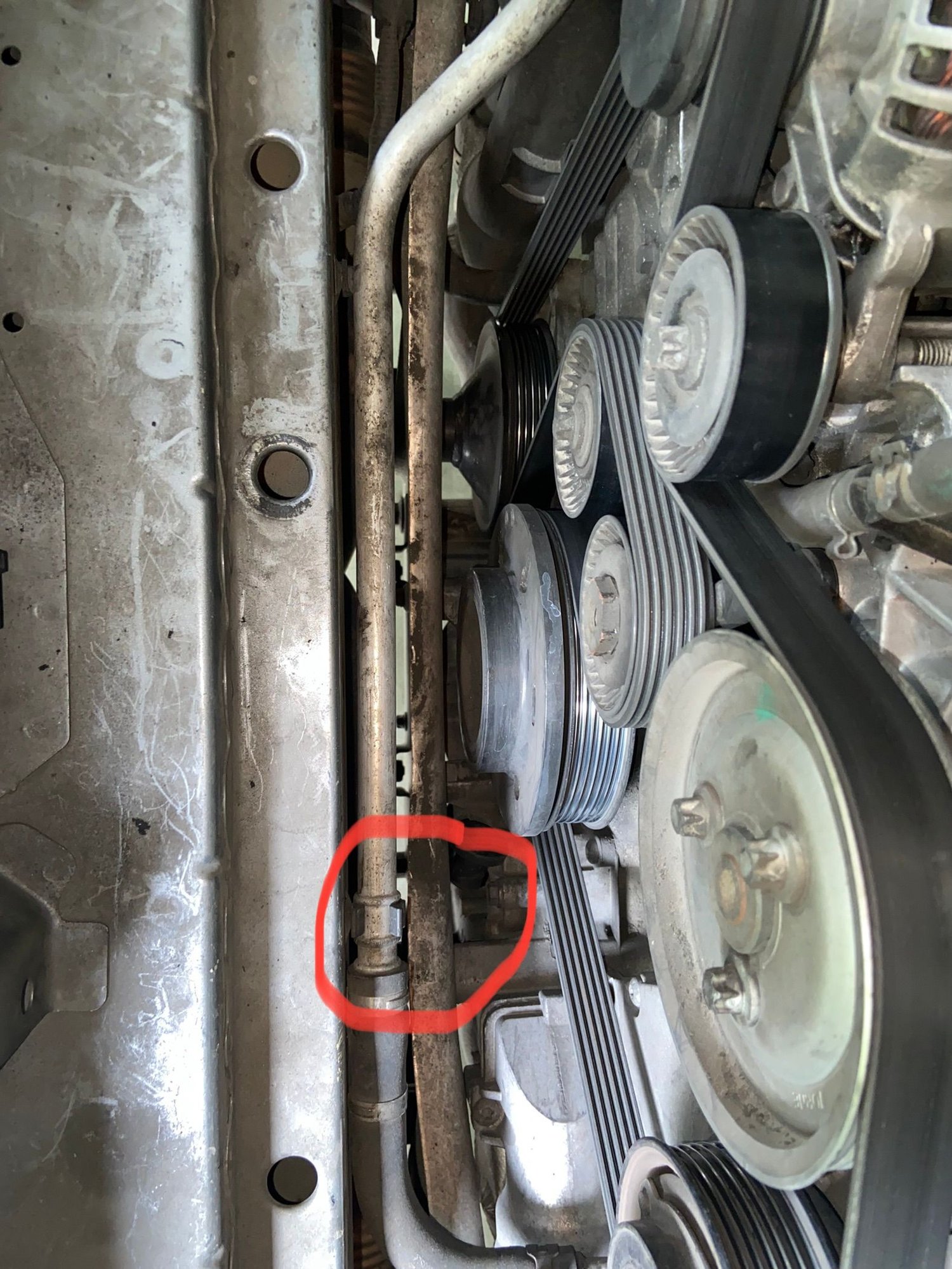

i broke one of the clips that holds one of the pipes on the fuel or exhaust venting system and can’t seem to figure out a part number to replace it. I’ve looked at several parts diagrams online but can’t seem to find anything that matches. I’ve circled the remaining clip in the photo below. Car is a 2006 C2S for référence
Any help would be appreciated

Thanks, but I don’t think that’s it. It looks like a metal clamp that has a plastic bit that inserts into the back of the body. Will see if I can remove the good one and get a better picture

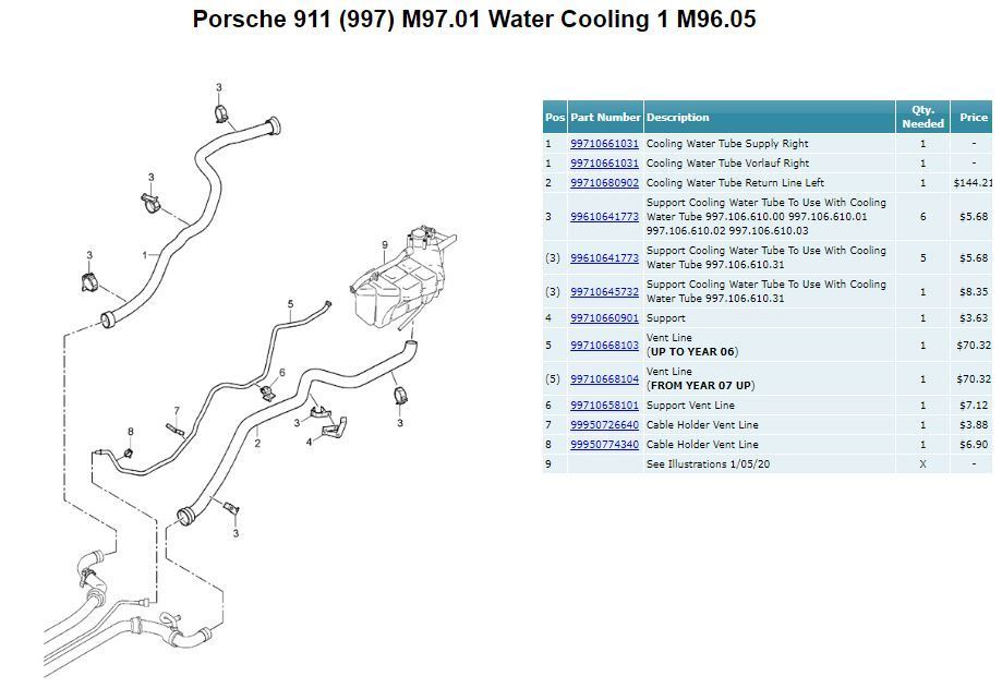

Is it #6?

It could very well be. I’ll order one and see if it’s right when it shows up. Thanks very much for the assist!

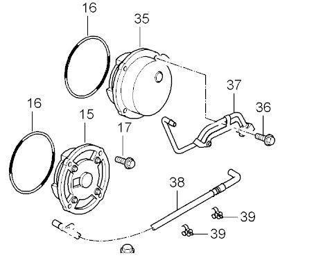

I think it is #39 below. Part number 999 507 968 41.

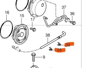

The line that is to be held here is the vacuum line of the brake booster. I had to change it (because I had a crack in the plastic hose due to age). My clips broke as well. Here is the info:
