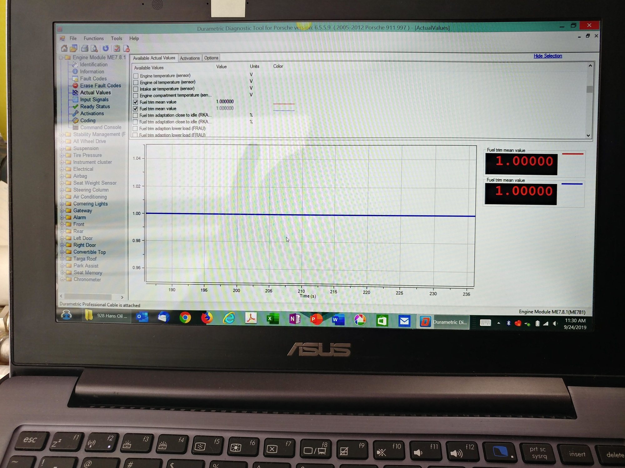

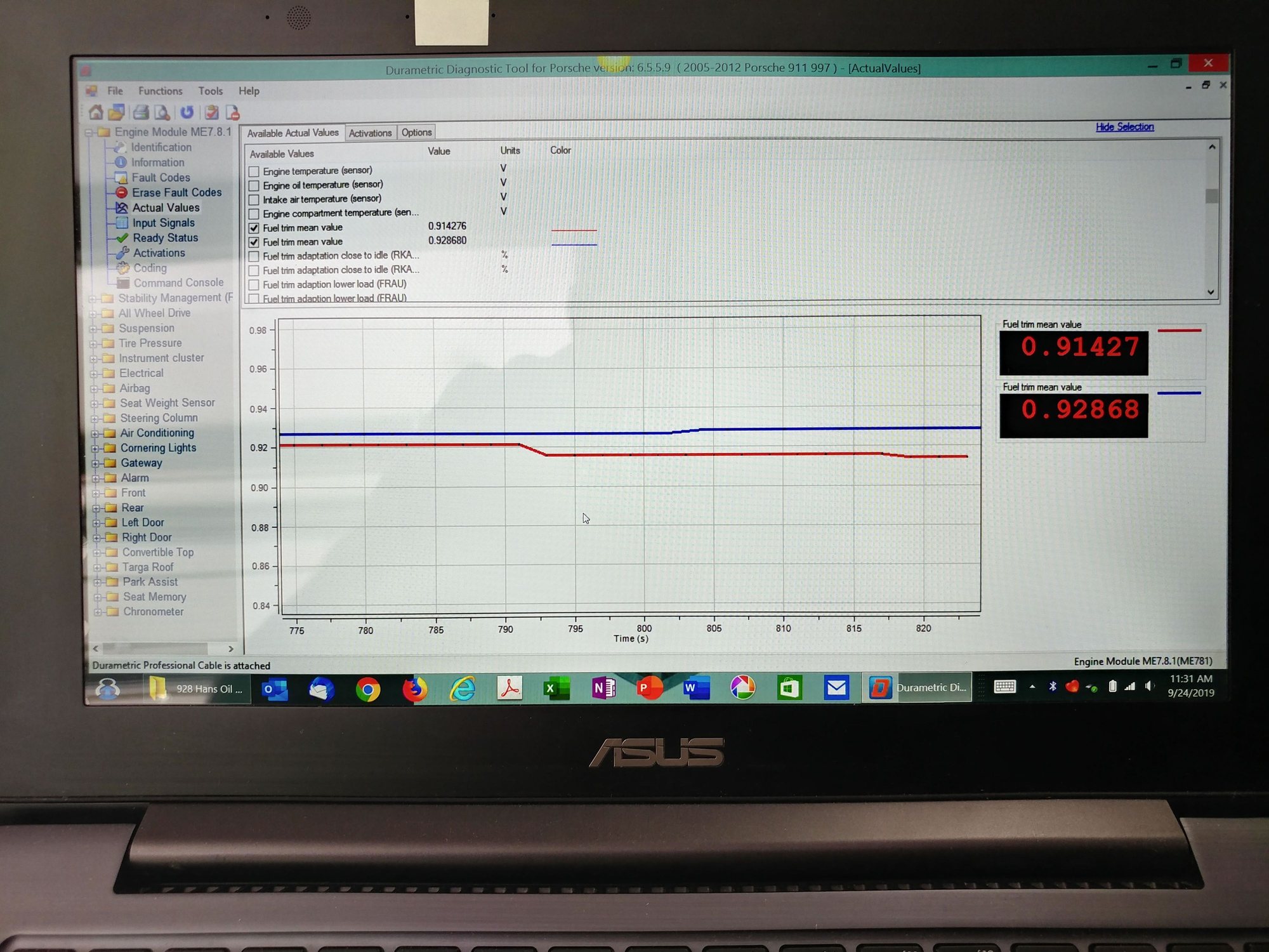

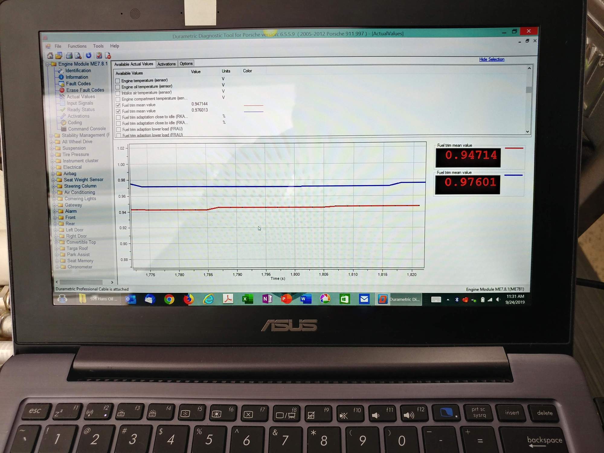

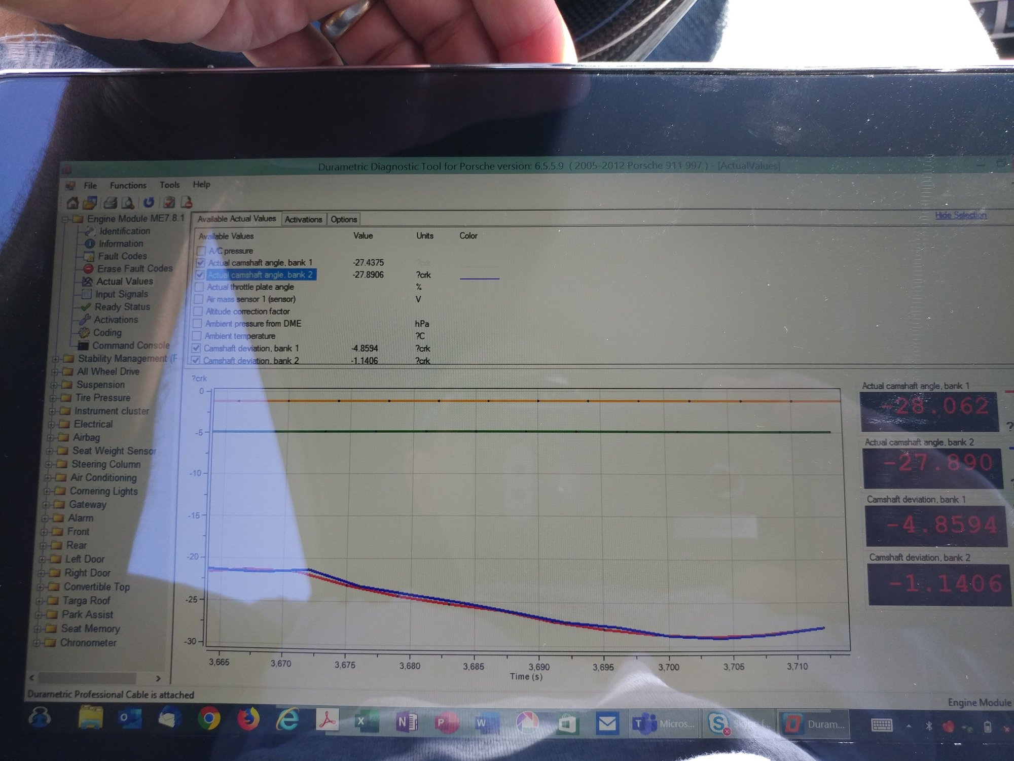

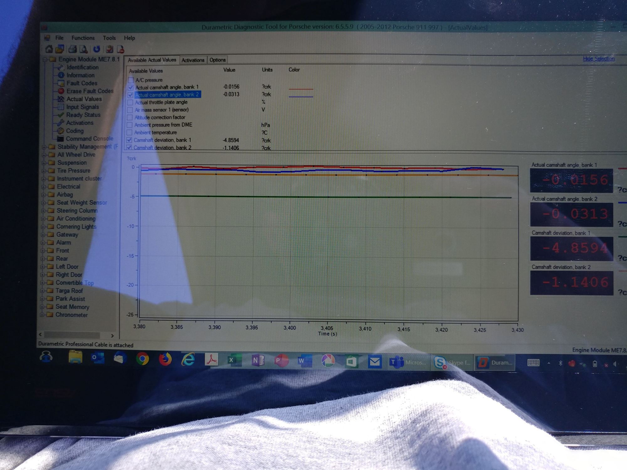

Which bank is which fuel trim numerical value? If running your scan tool in live value mode while you're driving, do they stay at the numbers you've shown here or move up and down. If accelerating hard, they may change momentarily, but should return to 1.0000 even as the acceleration continues as the DME adjusts the fueling. Are the mean values the same at idle as they are when driving? Vacuum leaks are more pronounced at idle then when underway.
What are the bank 1 and bank 2 camshaft deviation readings?
Here's are screenshots from my durametric on fuel trim mean valuess. As you can see, my car is tuned a little rich by RUF because of the supercharger, so my mean values show that fuel is being pulled (numbers below 1.0000) when it's driving and accelerating. Based on my numbers, I'd actually be interested to see what fuel trims on a 997 Turbo look like since my car is actually running a TT DME because of the forced induction.
At idle
Driving 1
Driving 2
At idle
Driving 1
Driving 2
Fuel Trim Mean Value(Short Term Fuel Trim) is 0.95 Bk1 & 0.996 Bk2 at idle and barely moves will accelerating. RKAT (Long Term Fuel Trim) is 0.234% Bk1 & 1.92% Bk2. My understanding based on the Video above by Tony Callas usually the Short Term Fuel Trim is not worry about as it is suppose to be in the range of 0.75 to 1.25 (with 1.0 being ideal). The Long Term Fuel Trim is more important as it can range from -6.0% to +6.0% (with 0 being ideal). Anything within the range of -3.0% to +3.0% should not be worrisome.

Good news that moving the variocam solenoid has made the error go away. If it comes back but on the other bank, you'll know what to change.
I don't quite understand why at idle your car can't hit the 1.0000 fuel trim values, but maybe that's not a big deal. With your numbers being below 1.000, it means the DME is pulling a little fuel from a slightly rich condition.
I think as long as the total deviation between the cams is within 5 degrees you're OK. Mine is 3.72
Interesting to see your Cam deviations....Maybe I am okay after all with roughly a -3.6 to -4.0 deviation on bank 2 when i am at zero on Bank 1.....maybe my Cam timing is okay. I was going to try and check the CAM timing but probably will now hold off unless i see error codes again. As i have replaced all the know culprits for variances in fuel trim (injectors, coils, plugs, MAF, O2 before Cat sensors) I will smoke test the engine as I actually believe i am running slightly too rich and maybe have a leak.
