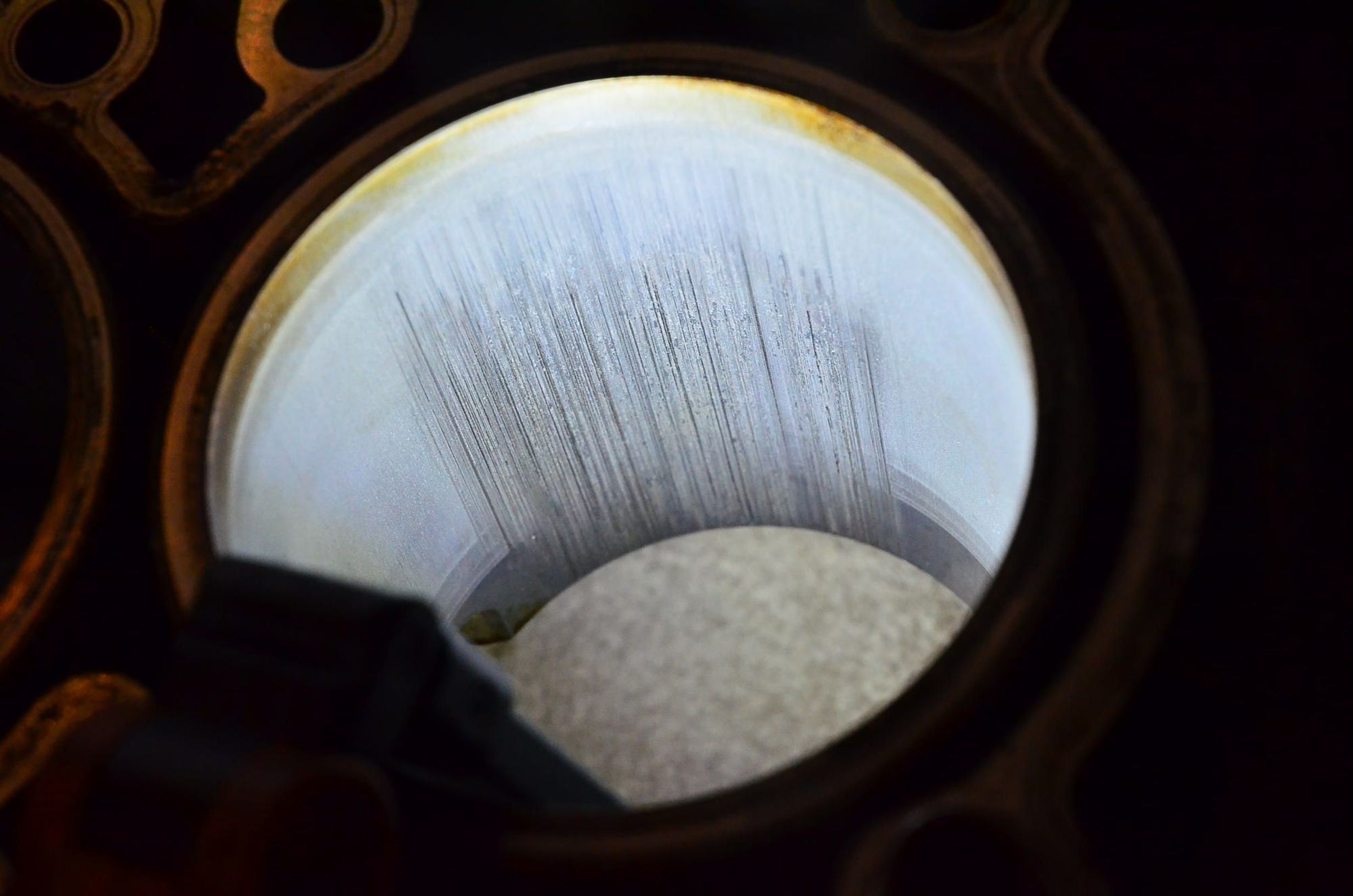

Welcome to the jungle. Here is my number 6. It starts at the very bottom edge of the cylinder bore and finishes at the very top of the cylinders right below the rings. You can definitely see it through the spark plug holes.
Would be interested to know:
Year of your 997.1
Number of miles on it (when you discovered the problem)
Where (geographically) the car has been driven
Stick shift or or Tiptronic
Certainly very regrettable to see the problem with your car.

2006 Carrera S. 3.8, tiptronic. It's the wife's daily mobile.
Got it at 55K miles, it now has 126K miles
It lived its first 55k miles in Idaho, and the rest was in NorCal.Ii found black soots in the last couple years on the left tail pipes. I took the engine out for other service and scoped the car from the spark plug holes and confirmed C4 and C6 had bore scoring. That was May 2022.
I had hoped that i would last another couple years, but it only got another 6,000 miles and between the oil consumption and the ticking noise, it was time for a rebuild. Upon tear down, it was very obvious how serious the problem has become.

Were most of her trips short in duration? What was the OCI? But then maybe it was the first 55k
