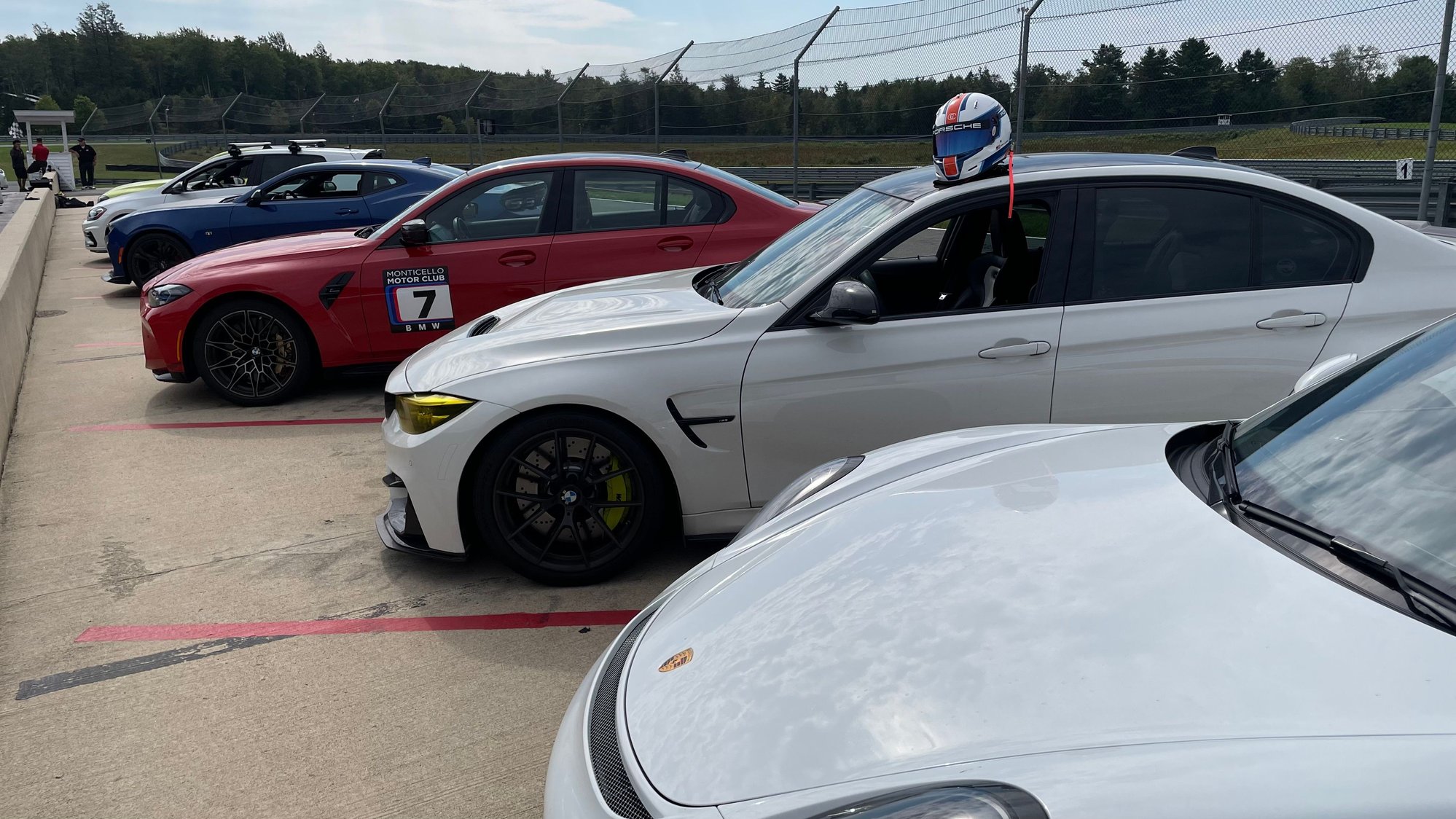

I track my C4s and my other track car is a M3CS
My 997 has a fairly new suspension refresh, so no real issues w it. I found it really fun to track compared to the M3CS. What you’ll miss is the speed of the bmw vs Porsche. You have to go in slower to corners on the 997 especially the 4s but you can get on power much much faster from apex.
since I don’t do many track days my hardest thing to do now is choosing which one to take.
