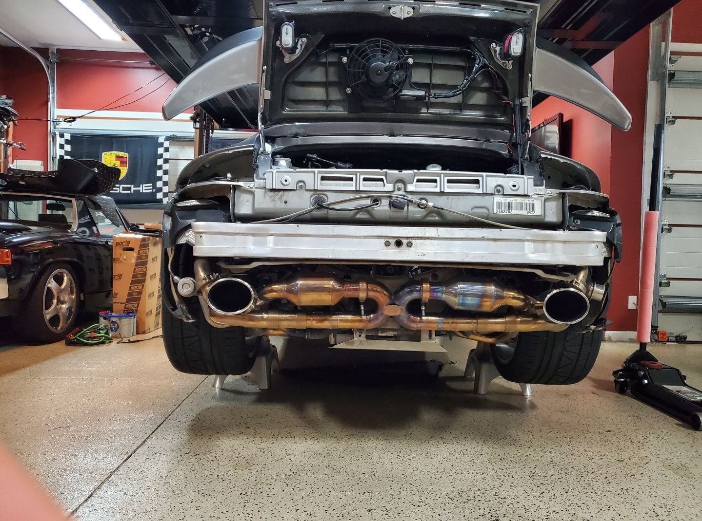

You still jack from the rear:
Jack rear left, insert stand front left. Lower rear left.
Jack rear right. Insert stand front right. Lower rear right.

This is when Jackpoint Jackstands are awesome. You jack and support from the proper chassis lifting point. Have just my rear up on them currently, but front would work the same way.

I have done this (jack up the car to remove the front bumper). Exactly as ADias said, Jack from the rear. You should be able to get the front high enough to place the stand under it, then repeat on the other side.

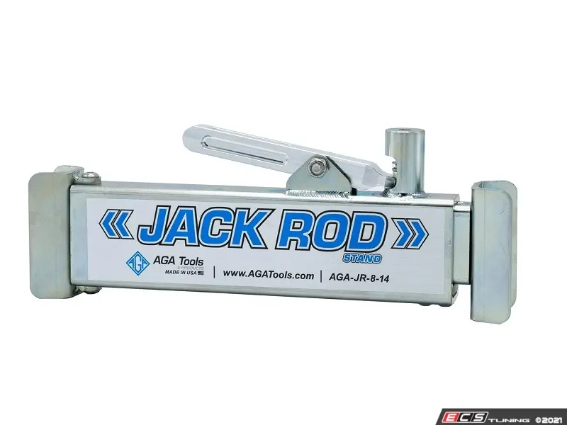

DO NOT USE THE CHEAP CHINESE ALUMINUM RACING JACKS FROM HARBOR FREIGHT ON ANYTHING. I bought a pair of these a few months ago as I figured for garage and driveway work it would be easier than hauling out the big 3-Ton steel jack, but one of the two actually failed on the first use and gently lowered that side of the car back down to the ground. Yes, the release valve was tightly closed. They immediately went back to the store for a refund. Cheap Chinese jacks are fine....until they aren't.
Get 2 quality jacks - Northern Tool sells good ones with a low profile and high lifting height and then this product that has recently been released will allow the jack to safely be used as a jack stand. Might buy a couple of these myself.
https://www.ecstuning.com/b-aga-tool...a-jr-8-14~agt/
Don't mess around under cars without them being properly jacked up and properly supported.
Those are sweet. I had fabricated something like this but it was a fixed (solid) length. These look like a great solution for an on the cheap work solution. But as rileyracing1 stated since ... Quick Jack, or other suitable lift, makes a lot of sense if you're going to be serious over any length of time.
