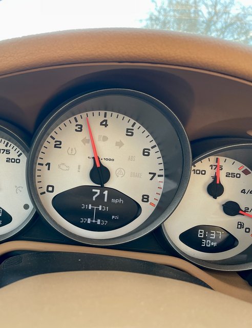

Just because you have the icon on the dash doesn’t mean you have the TPMS option because it was offered as an extra cost option on that model year but not standard equipment until 2007. Check your tire valve stems to see if they have the metal TPMS stems that look like bolts that screw into the wheel like the one in my pic below on my car, or if yours are rubber valve stems or metal that do not have a bolt where it meets the wheel rim.

Also, if you do have it, you will be able to see the tire pressures in your dash like below when you cycle through your dash functions with the stalk on the left side of the steering wheel. If your car did originally have the extra cost feature of the TPMS, there is a chance that the previous owner of your car had it coded out when they installed the Techart wheels, and if that’s the case, you would need to have dealer or someone with a scan tool that could turn the feature back on and then you’d also need to purchase new TPMS sensors to have installed on your wheels. Perhaps you can use your car’s VIN number to see if it was ordered with the TPMS?
