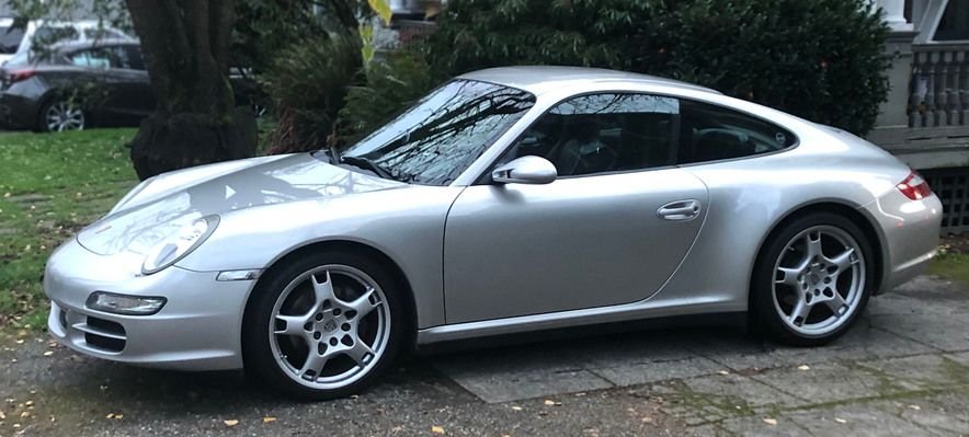

Yes - my C4 Cab 3.6 had excellent Bore Scope Insp.as well and the C4 coupe 3.6 I just bought last week.
I have to tell you when you have the Bore Scope Photos to show to buyer, makes transaction simple and clean. Puts to rest any uncertainty.
4-5 years ago BS Inspection wasn't really a topic and now that the cars are reaching higher miles there are many more crappy stories of high oil consumption, poor running engine/etc due to Bore Scoring related issues.
Like I said above Bore Scope Inspection a must for everyone.
Thanks to fellow member and buddy Kellen, I got the Lobster fork wheels mounted on my car today as well as Bluetooth and new Temp/Fan Switches.
H&R springs getting installed in a couple of weeks. Also having front differential oil changed.
