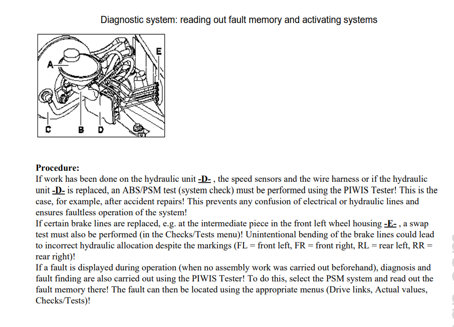

also I found this in manuel yesturday:
To switch the booster I had to completely remove the abs pump, maybe I should have that done. I'll have a shop do it with a piwis and set the abs to the 997s program since I'm using it's brakes and wheels/tires size. And also have the pump running like Petza mentioned.
