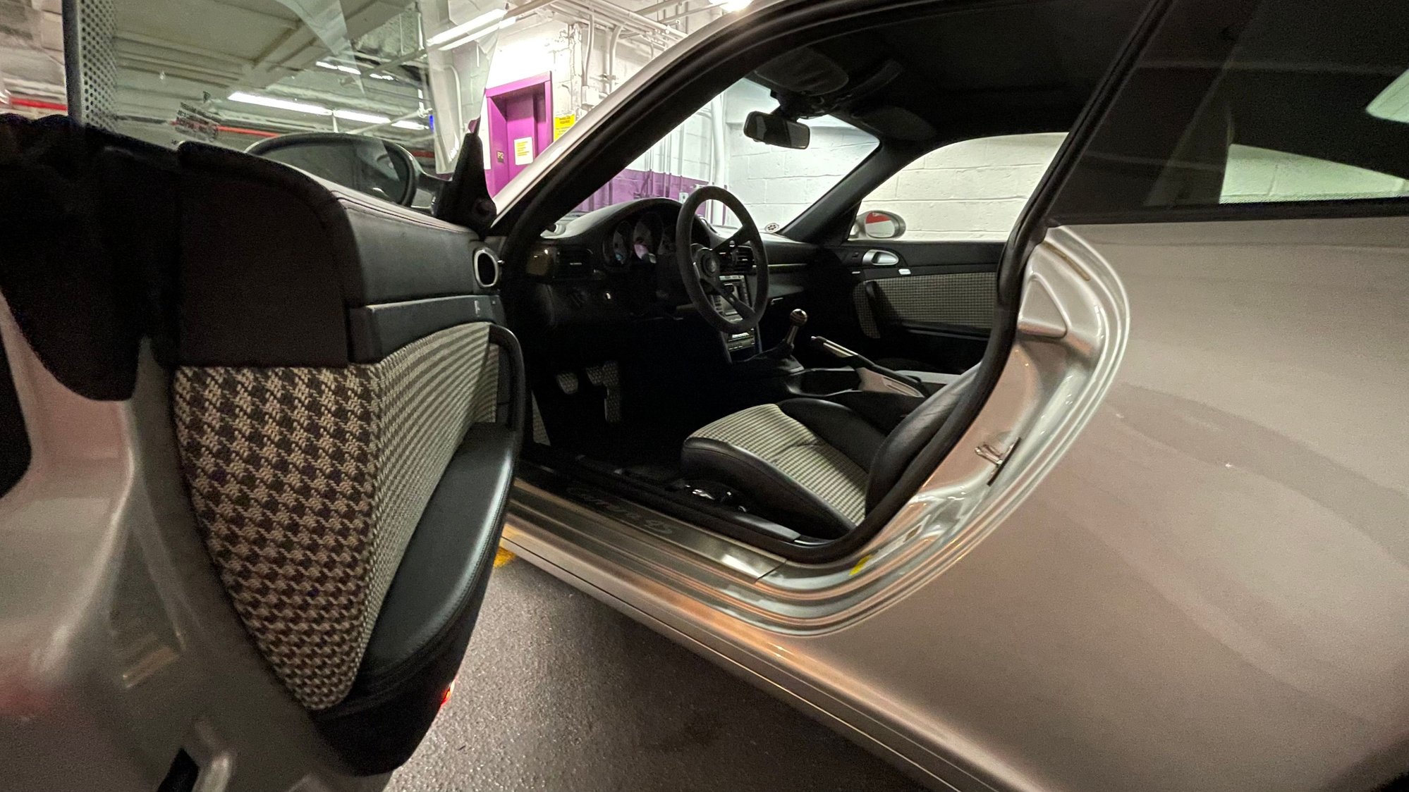

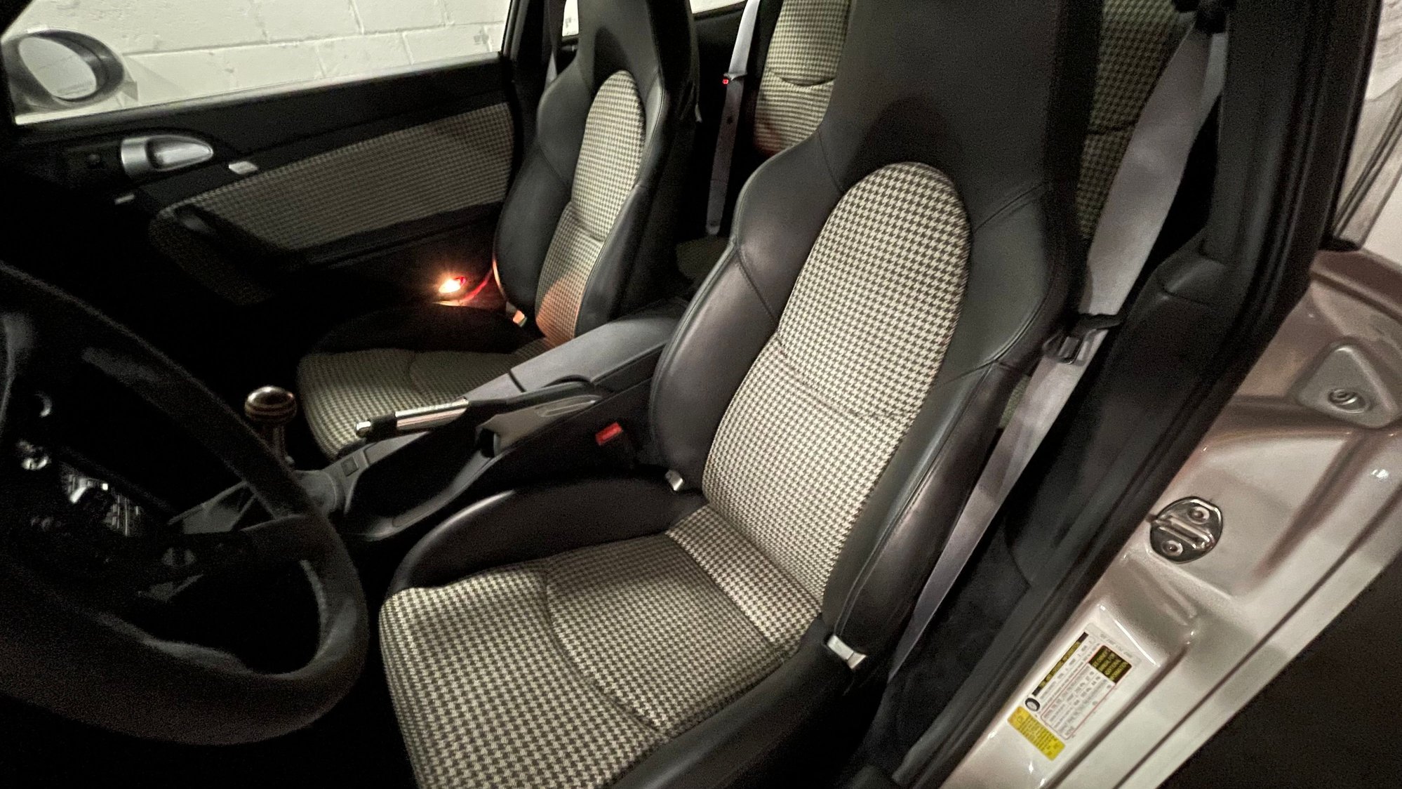

It does come off but my installer thought it wasn’t an easy job as a lot of the components attach to the door card and have to be removed and re-installed.
but the results are amazing in my opinion some pics of mine. I used OEM 911r fabric.

ahh so doable, thats exactly what I am going for. thanks. I'll figure out the removal, just don't need to mess up an air bag I am looking at a foam backed product from relicate.

the 911r fabric has a backing as well.
not sure if the airbag gets messed up but I have no airbag errors after installing
