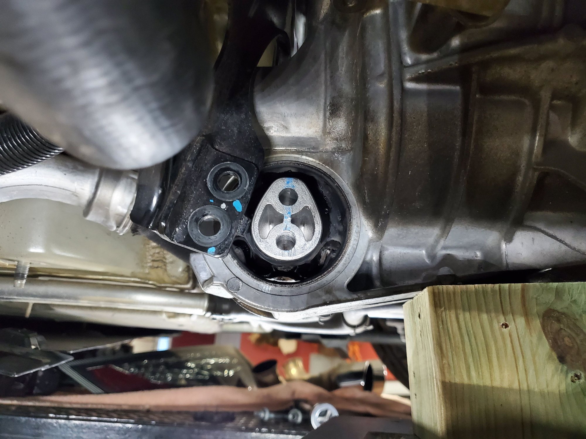

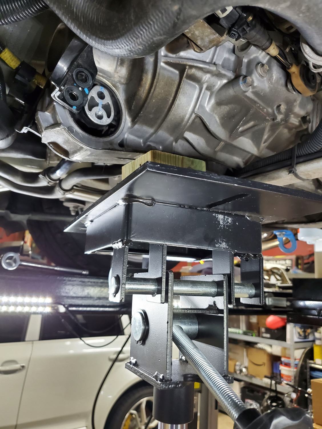

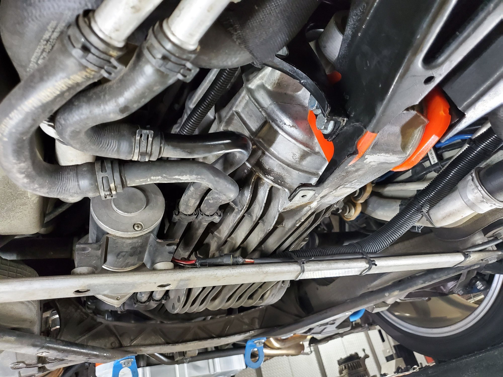

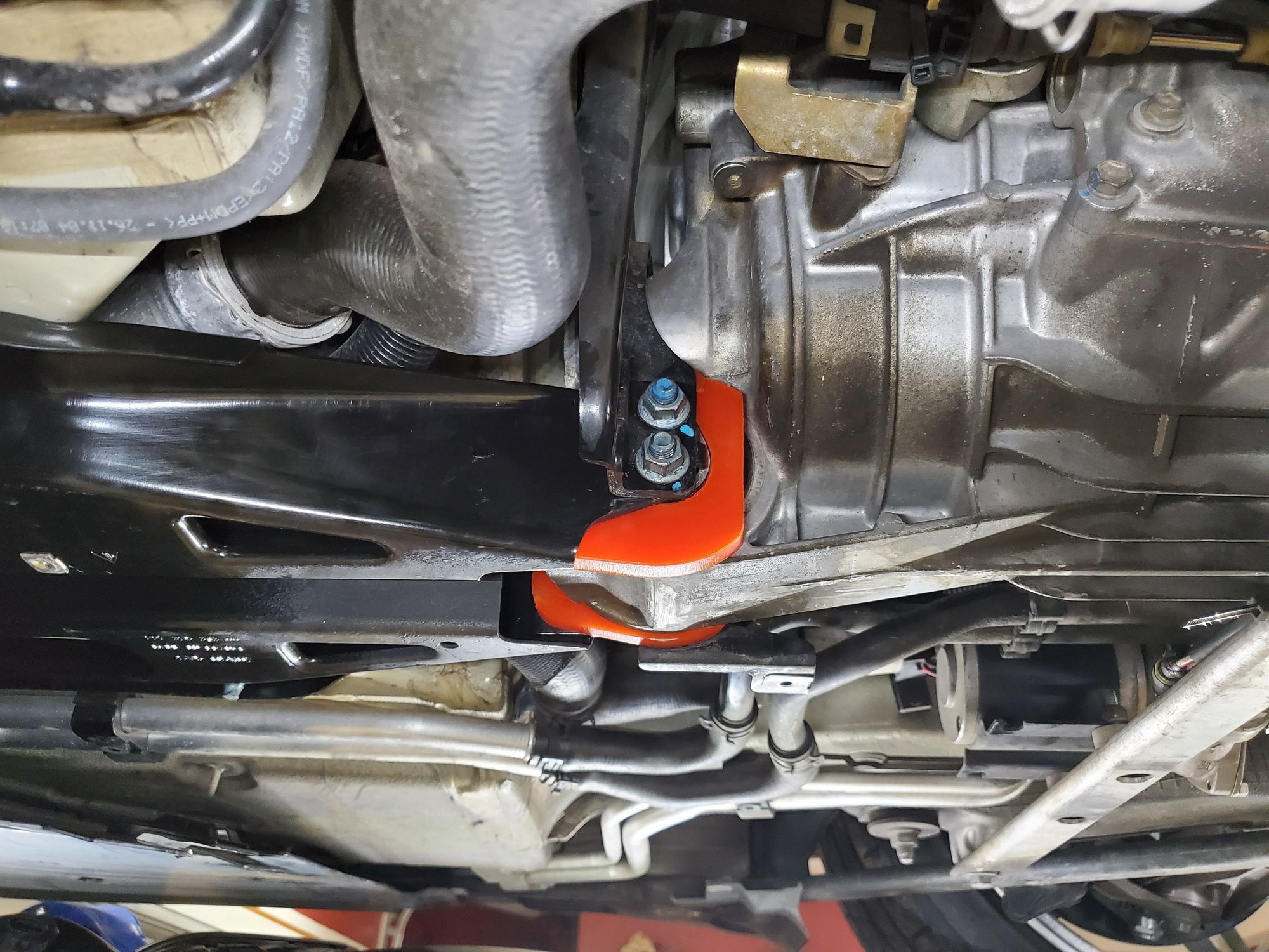

If you catch the transmission mount before it fails, you can use the Function First mount inserts to give it additional rigidity for better component control and to prevent the failure of the OEM mount. The inserts are available in 2 or 3 different stiffnesses. Transmissions tend to have and transmit more NVH to the chassis than motor mounts do, so when I did them, I went with the orange soft versions and have not detected any additional NVH. I think maybe Wayne went with the stiff black ones and believe he's happy too, so maybe not much difference in which you choose.
Inspect the OEM mount for any cracks or tears in the rubber surround
Hi lift trans jack with a lift makes this pretty essy
FF inserts instslled
