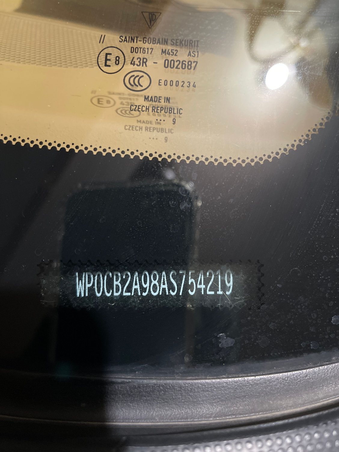

My OEM windshield has Czech Republic stamped on it!
Not German after all

There is nothing really special about Porsche.... however an installer didn't set the glass in deep enough... nor sure how that was possible, but he did. The bigger issue is the glass... and that is the Saint Gobain maker and then the Porsche P logo. BTW, my windshield... third one... is exactly marked as yours. No more crap Chinese wavy glass for me... ever.
Peace
Bruce in Philly

usually, no matter who replaces the windshield, they all get them from porsche, because no other mfg is licensed to make the windshield. Sekurit is usually the stamp, but Pinkington is owned by Sek so they have some stamps on certain models. I think it is a age determination of when the license run out
