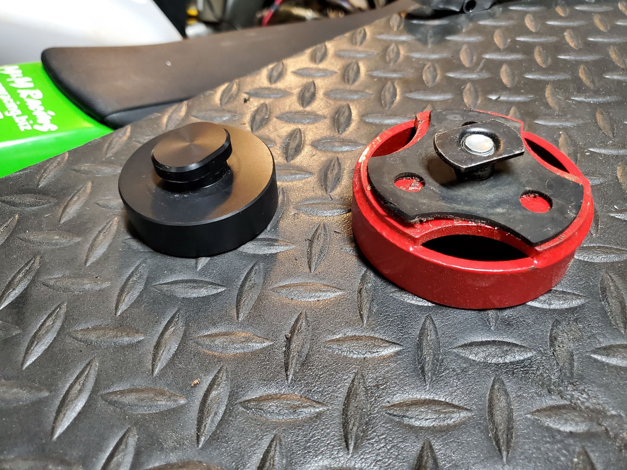

When you jack up a 997, you should have something that locks into those holes in the jackpoints to prevent this like these. They go into the oval holes and turn 90 degrees to lock into them

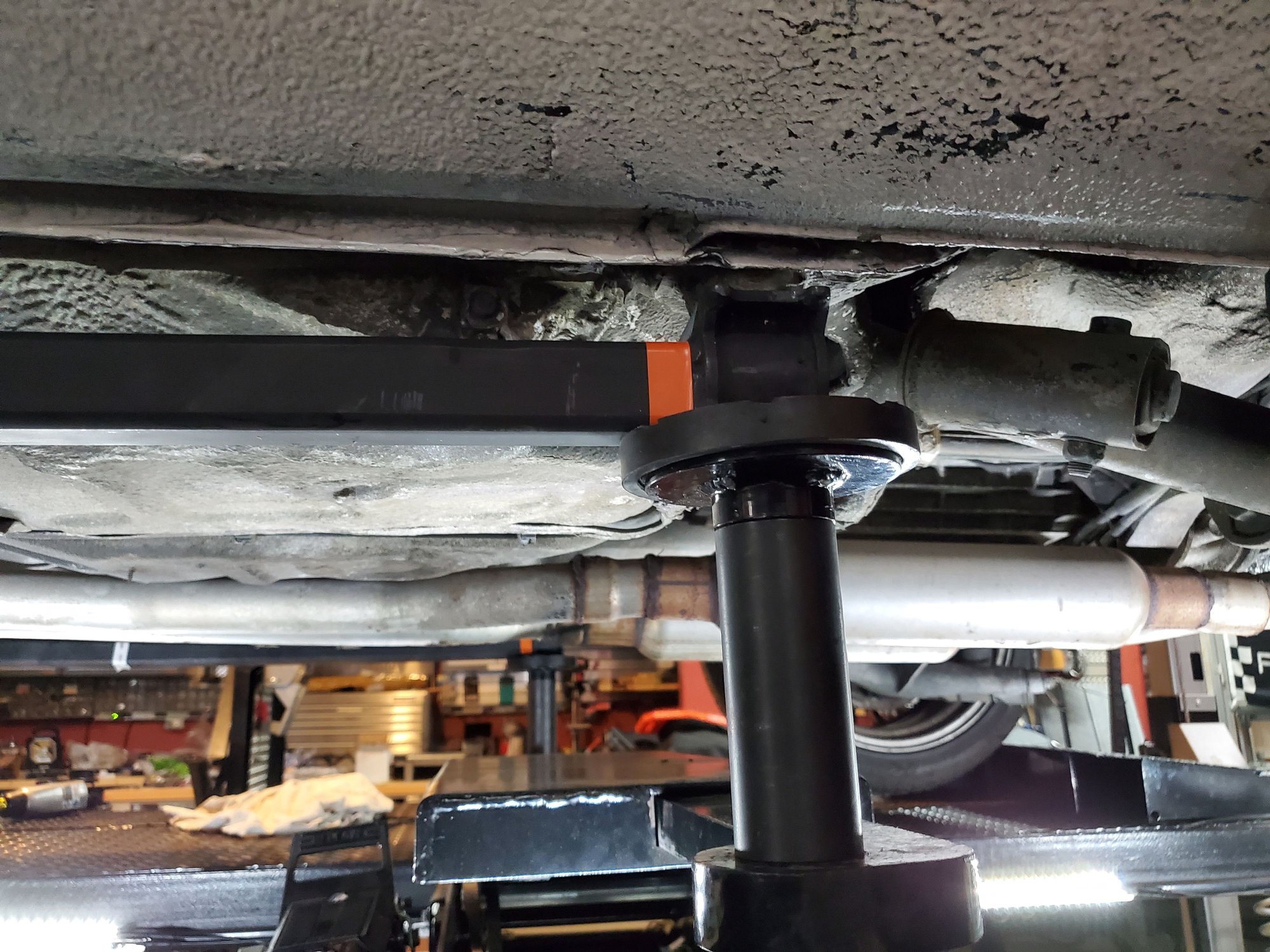

Also, you should not be using saddle jacks unless also using them with lift bars. If you've never heard of lift bars, check them out as they make the car easy to get into the air and you can jack up a whole side without twisting the chassis at all. You jack from the center (white stripe) of the bar and them place the jack stands at the ends. I have some under my 928 in this pic on the bridge Jack's on the 4-poat lift. The top side has pins that go into the jackpoints holes.
