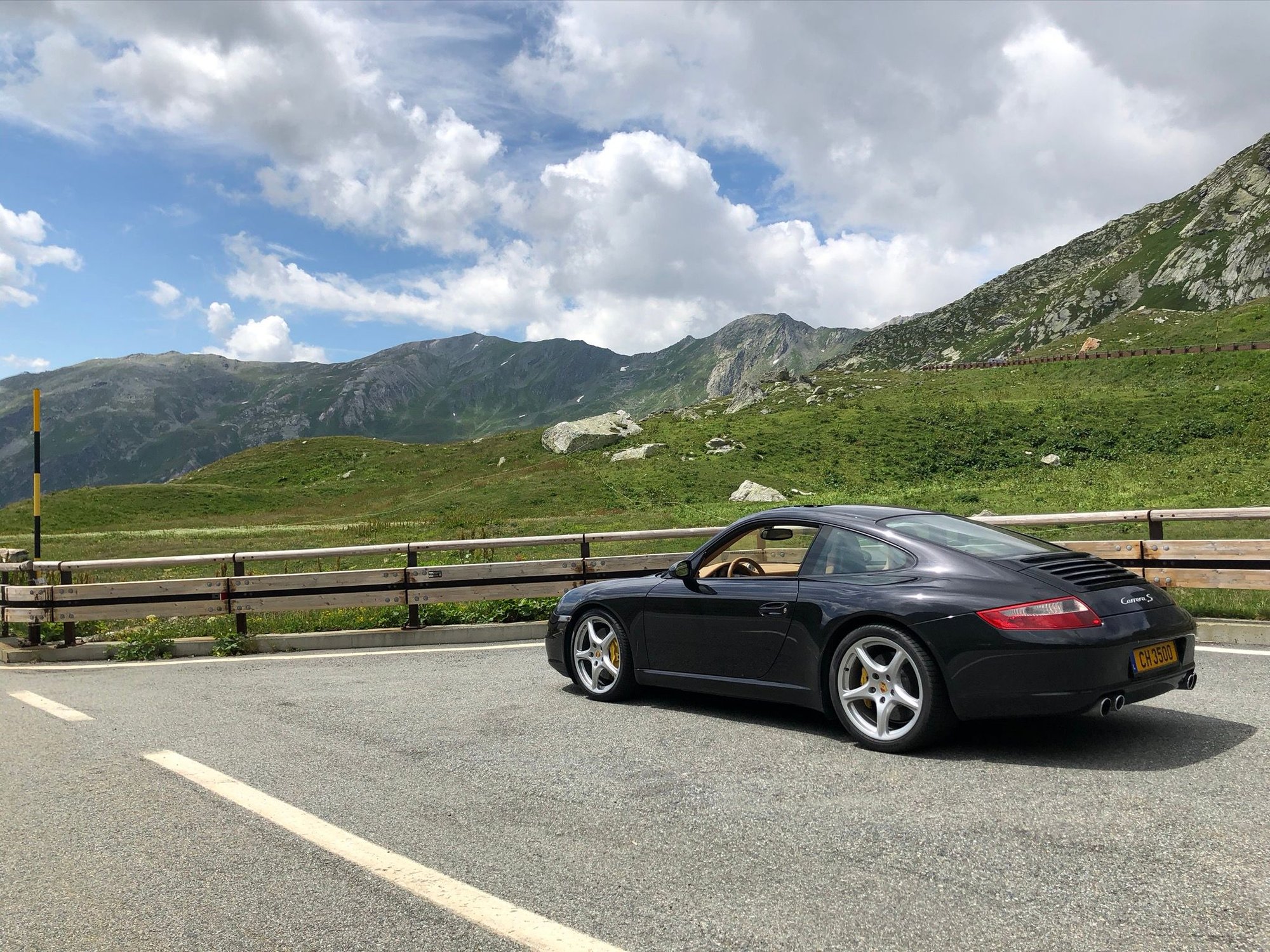

Hello,
I have a 997.1S X51 with rebuilt engine (8000 miles on it). Brand new clutch too, manual transmission with short shift. There’s a creaking sound coming from the rear when I lift my foot from the throttle (to change gears), noticeable only above 3k rpms. Sound doesnt go away when engine is warm.
Only happens when letting go of throttle above 3k. Nothing to do with the clutch.
will take it to my dealer, but anything you guys think?
Thanks! (Pic below for science)
