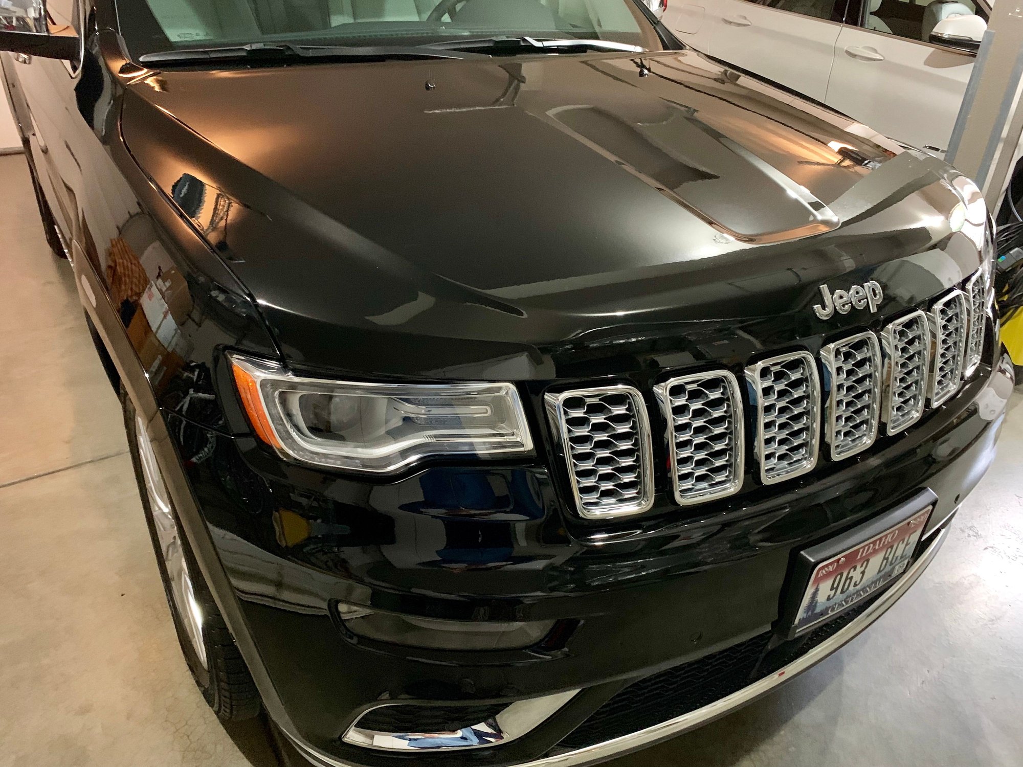

With a ceramic coating, the end result is 90% dependent on the extent and quality of the prep work. And on a black finish, it is even more the case as it shows everything. With the clarity and high gloss associated with a ceramic coating, any scratches or swirl marks become even more apparent. Time devoted to getting the paint right prior to the ceramic application is time well invested.
I've done my 911 and also my Jeep. The Jeep being black was more of a challenge...

Looks sweet Robert!!

Great advice. I'd like to think that whoever is doing the prep work would be honest enough to say whether or not the prep work was successful enough to make the ceramic coating worthwhile rather than making the car look worse. Your Jeep looks amazing though.

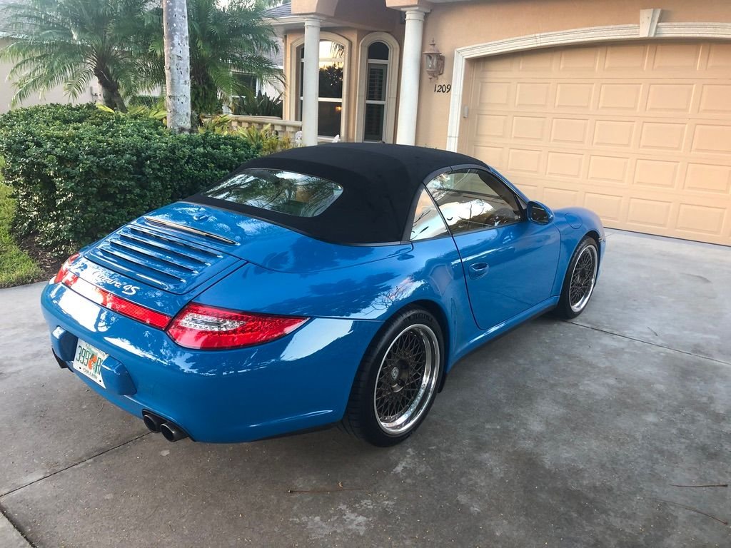

Tom, I'm more interested in how you keep your cab top so black and new looking. Mine's not bad at all, but yours really pops!

Thanks for the kind words....I do nothing! It was outside (no garage) in NJ for 4 years in the snow and then I moved to FL and a garage and have her for another 6 years......my detail guy did treat it with something when I had the ceramic done....I noticed a difference too so I'll ask him and tell you! Happy new year!

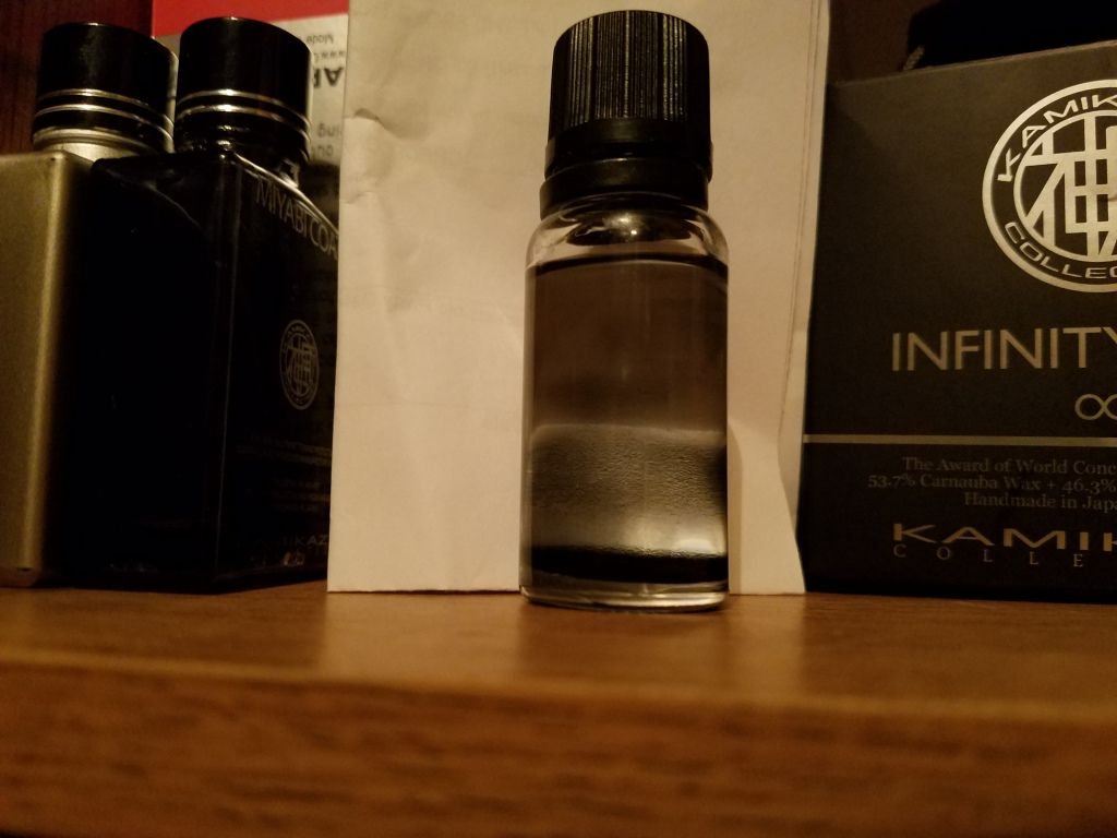

Just be sure to shake those graphene products before use as that stuff (reduced graphene oxide) will settle out:
