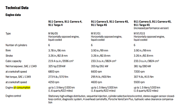

A lot of people think Porsche says it’s 1 quart per 600 miles, but that’s not true according to the below in the owners manual. Porsche actually says burning 1.6 qts per 622 miles is acceptable. That works out to 1 quart per 389 miles! I bet a lot of folks who don’t read these forums are running around burning a good amount of oil and have scoring already but are not worried because their owners manual says it’s normal, and these engines will still last well over 100k miles. I think there are also a lot of folks who read these forums who are rebuilding their engines a little prematurely because they found a little scoring. If you’re gonna spend $25-30k on a rebuild, why not wait until your engine fails though is my question.
This topic is an evergreen, and of course the maximal oil consumption in the user manual is not what you want in your own car.
But below is a page from the actual Porsche workshop manual showing that they expect a healthy engine to consume no more than 500cc per 1000km, or 0.85 quarts per 1000 miles. So this is 3 times less than what they state in the user manual.....
(It also shows that a healthy engine should have 5 bar oil pressure at 5K rpm at operating temperature, again better than the coy 3.5 bar in the user manual.)
But from all I've seen, including the poll in this forum, the scatter of oil usage is enormous and 1 quart per 2500 miles would not have raised any red flags for the original engine. Probably, with such low miles, one would have waited for everything to brake in properly.
The more important criterion is whether the oil usage changes in time, and do you get sooty pipes. Weird, hope it works out for you.

Thing is most owners will not have access or try to look at what the shop manual says is normal and instead will rely on what’s in their user manual. But I agree, if I saw an oil burn rate of up to 1 qt per 389 miles, I certainly wouldn’t see that as within acceptable specs. Whatever Porsche deems acceptable is moot I think, as what they put in their manual is what they are telling owners is acceptable whether or not it really is.
