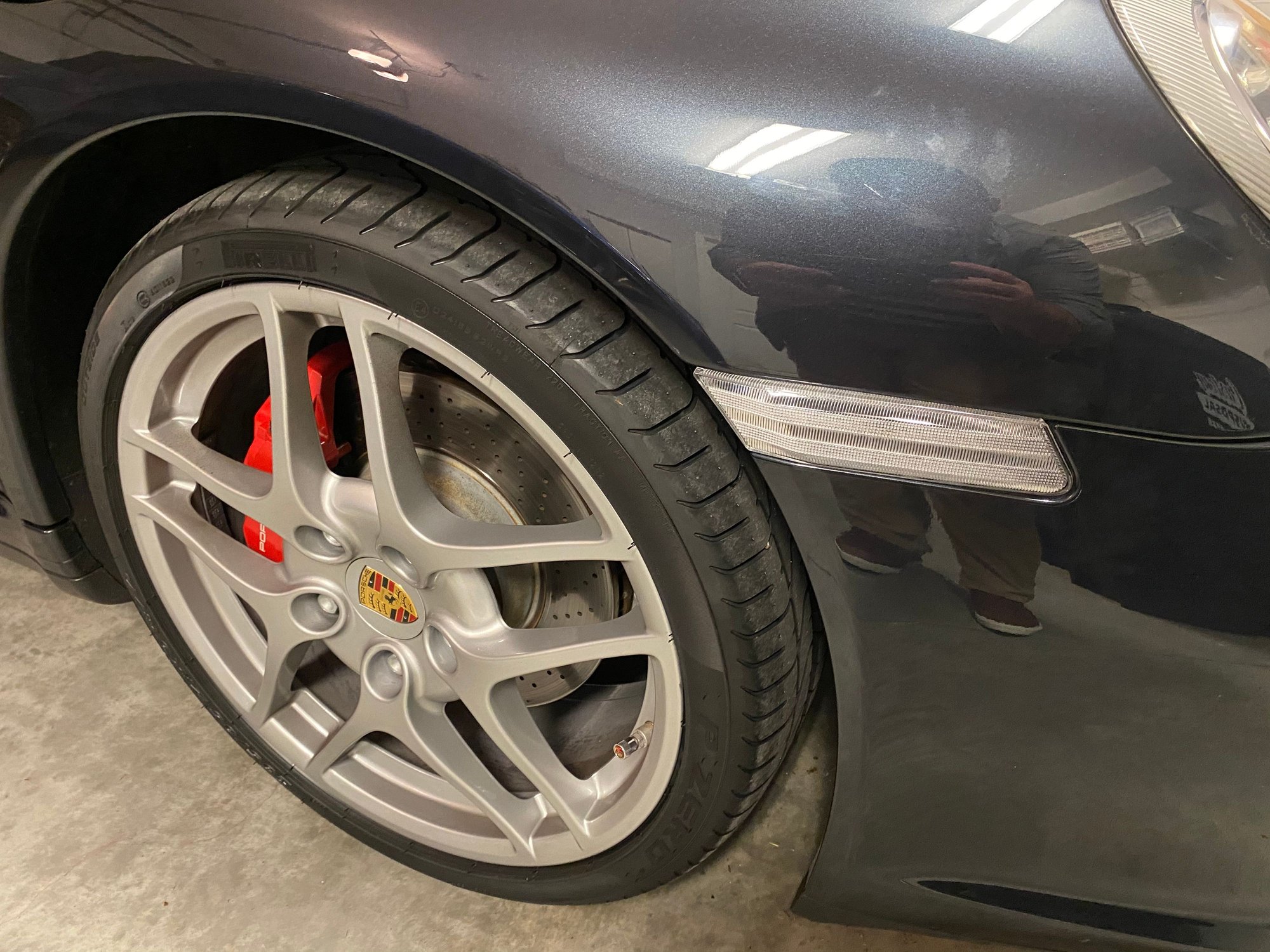

Greetings. I know this has been done many times before but I wanted to share my upgrade. I swapped the euro clear markets for a clear set with an amber light bar. I know some would rather smoked markers with little to no light but I typically like clear lenses especially on darker cars for a little pop. Anyways here are a few pics of the quick and easy process. $53 on eBay with canbus so no light errors.
Stock euro corner with yellow bulb. Yuck

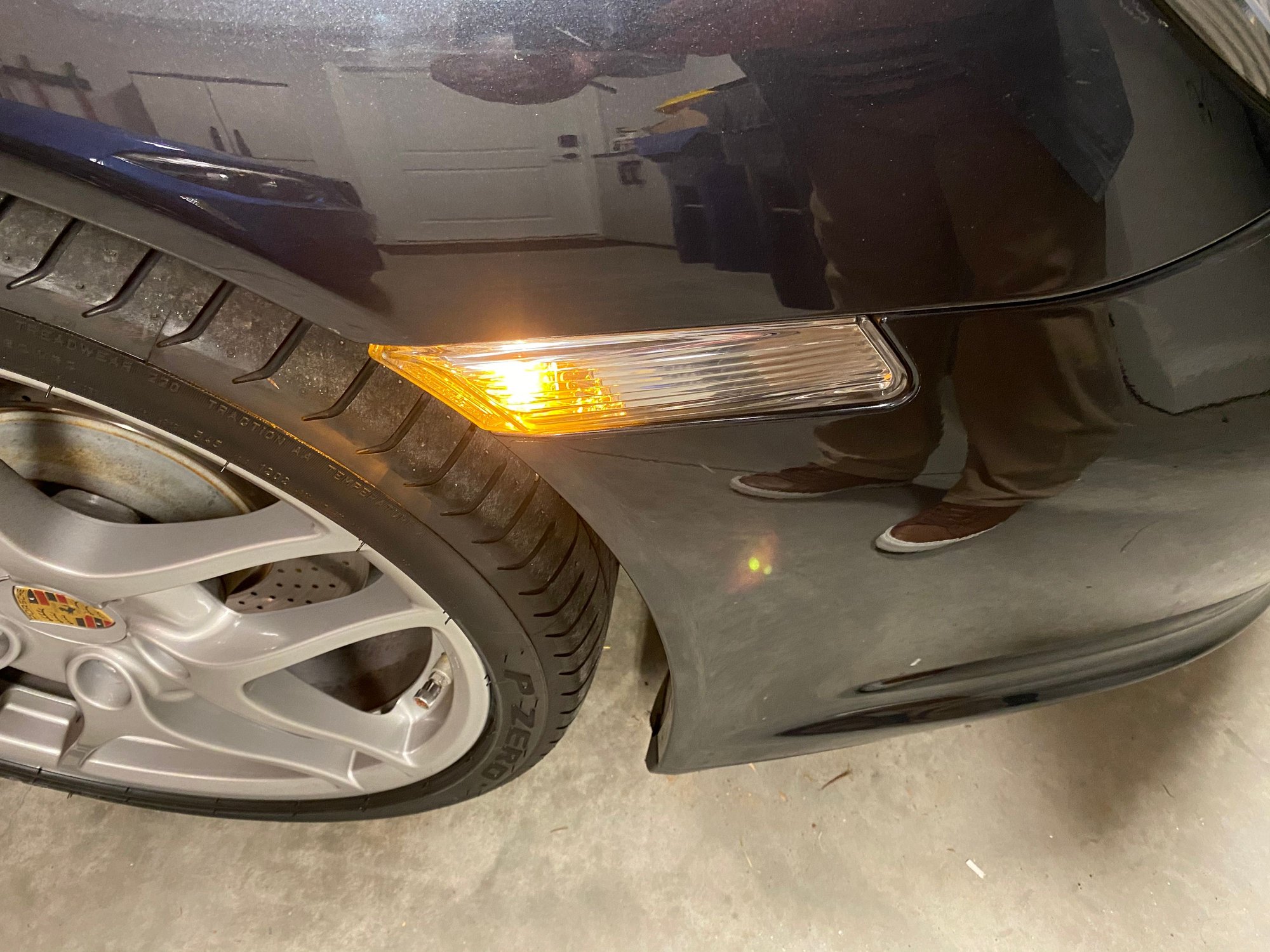

Euro side market lit.

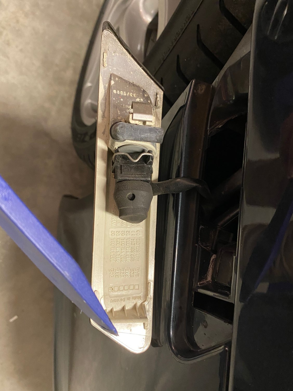

I used a plastic trim tool to spring the lense toward the wheel well to pop them out. Removed the bulb by twist and turning and then released the connection by pushing down the metal lock bar.

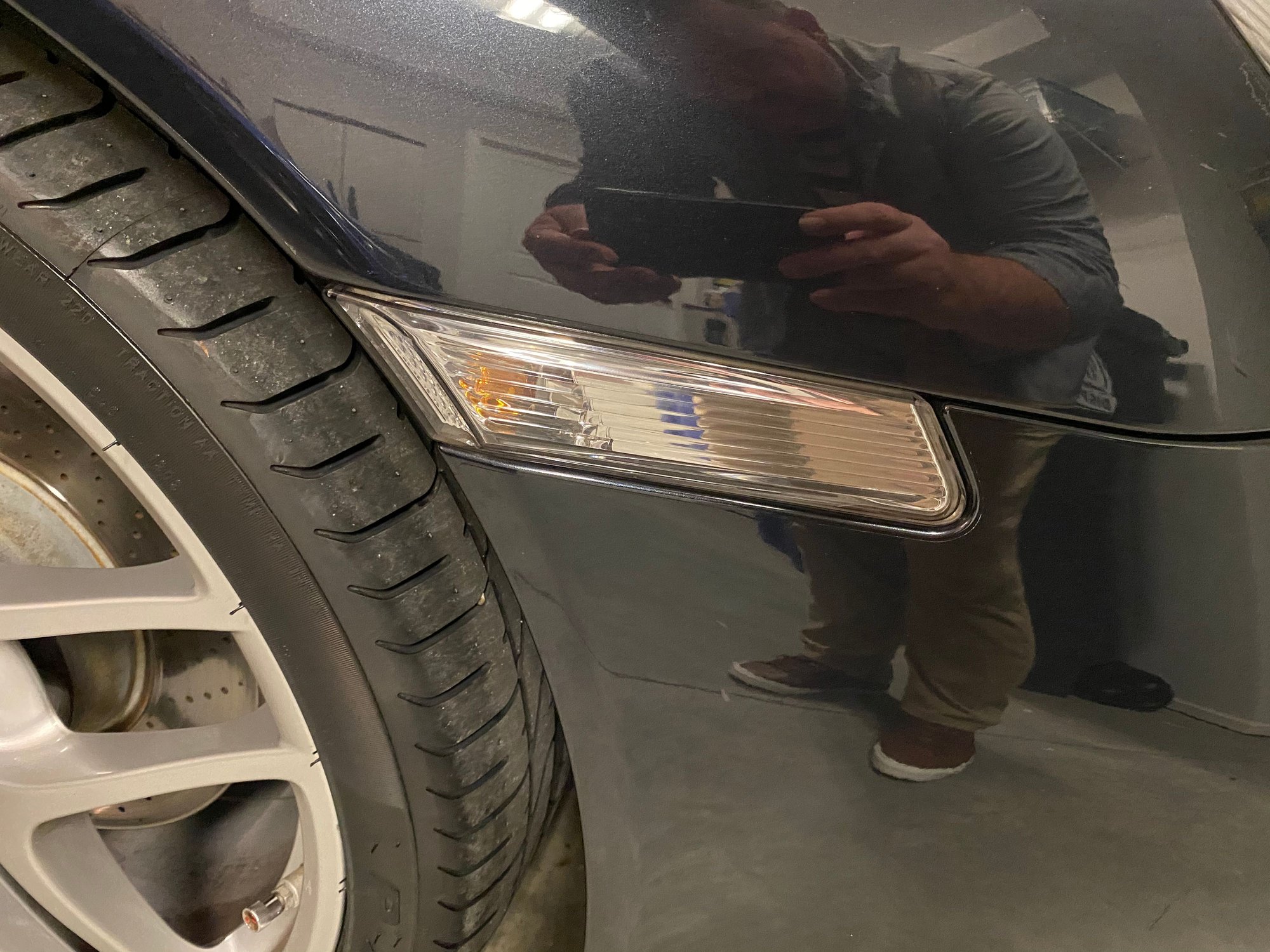

New led unit!

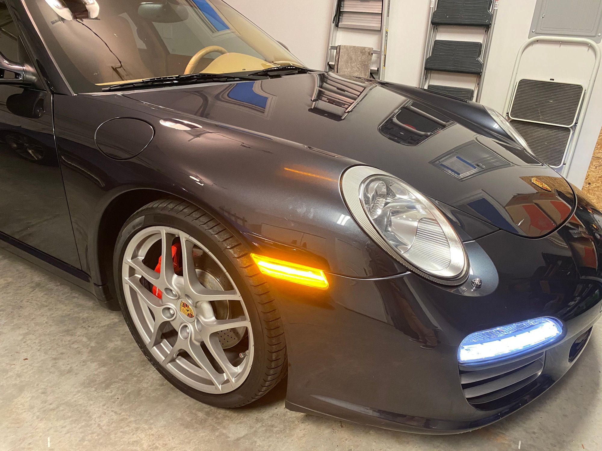

Led unit lit. It is bright but not as bright as the photo makes it look. Much better IMO.

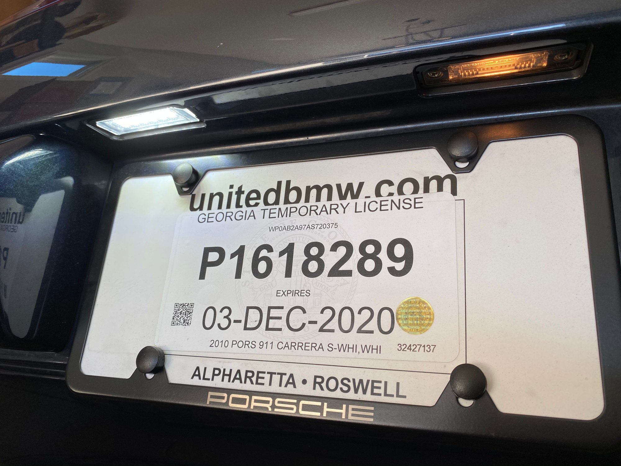

These have a canbus so no errors on your dash. I installed the license plate led lights as well and they had can bus as well. LED on the left.
