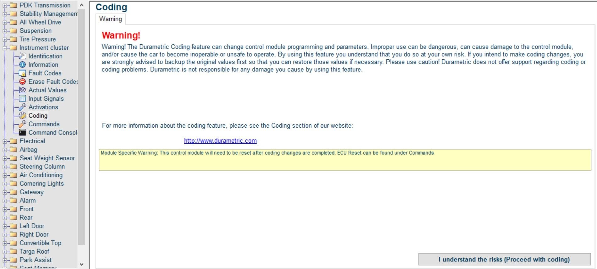

So apparently for any Coding changes in 'Instrument Cluster' to take effect, the ECU has to be reset by clicking the Reset ECU button.
My only question is, whether this is a safe action to take, and I won't be bricking the ECU i.e. car?
Changes I want to make, in the Cluster, Key and Key 2
- middle display to show Radio info
- set units, time etc.
Thanks in advance for your insights, advice

Always capture a backup of the current setup and save it to the PC before you make any coding changes. I can't answer your specific question, but in my 997.1 I've never had to do that to implement a coding change and I've done a few, like comfort windows up and down with the key button, side markers as blinkers, enable multi-function steering wheel, etc.

Yeah, Instrument Custer has this additional requirement. When it opens the main page on the right where you click to go to coding there is a text box that says that ECU needs to be reset
