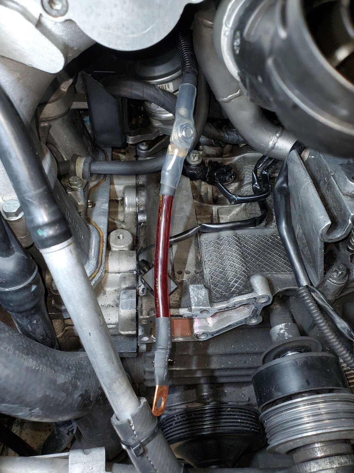

Here is what the knock sensors looks like. One right behind the alternator (alternator removed) and the other right behind the AOS (A/C compressor removed)

Code is P1384 Knock Sensor 1. This is on a PDK. I only use high octane gas. It started out as an occasional alert, but now happens about 10 minutes into the drive after heavy acceleration, although the car is running fine. Appreciate the pictures. As unique as it sounds it is starting to sound like a faulty sensor. Do you know what 1 vs 2 is?, behind alternator vs. behind AOS?

Your engine is different than mine (I have an 05 .1 vs your .2) so your knock sensors could be in a different place. But Knock sensor 1 I'm assuming is on Bank 1 which would the the driver's side one.
