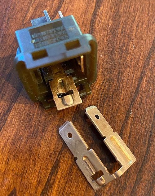

I searched around - common suggestion is to simply replace the brake light switch. I removed the switch, and found it was very simple to fix. Most likely the electrical contacts just need cleaned with some steel wool or sandpaper and is as good as new.
General steps to fix:
Switch is right behind brake pedal (circled below). Twist the switch 90 degrees, and pull out of mount:
Here is what the switch looks like hanging down after pulling from it's mounting location. Unplug from the wiring harness:
Once you have the switch out, you'll see it opens up pretty easily - small flat head screwdriver or knife and you can pry it open. Inside is a spring you can set aside. Once open, push the plunger in all the way and it'll expose the electrical contacts that are the friction/contact points and clean them (I used steel wool). I also bent out the contacts a bit to try to improve friction. This will be more clear when you have the switch apart in hand and see how it works - it's a simple mechanism:
On the other side of the switch, you can pull the pins out - clean them as well and put back in.
That fixed it for me! Hope this info is helpful if you run across the same problem.
