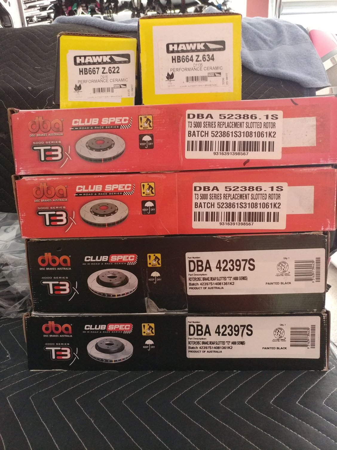

If you'll be pushing the car hard or doing track days, slotted rotors are better than drilled. Drilled rotors have a tendency to crack and have fracture lines go between the holes. Slotted rotors still sweep water away from the pad contact surface and keep the pad material fresh. This is what's on my wife's 05 C2S with Hawk Ceramic pads. Rotors are dba - Disc Brakes Australia from Ken at KNS Brakes
Rear 1-piece slotted
2-piece Front
Part #s - these front part #s were only for the replacement rotor rings as I already had the hats. You'd need the complete 2 piece rotor the first time and then subsequent changes you can just buy new rings
