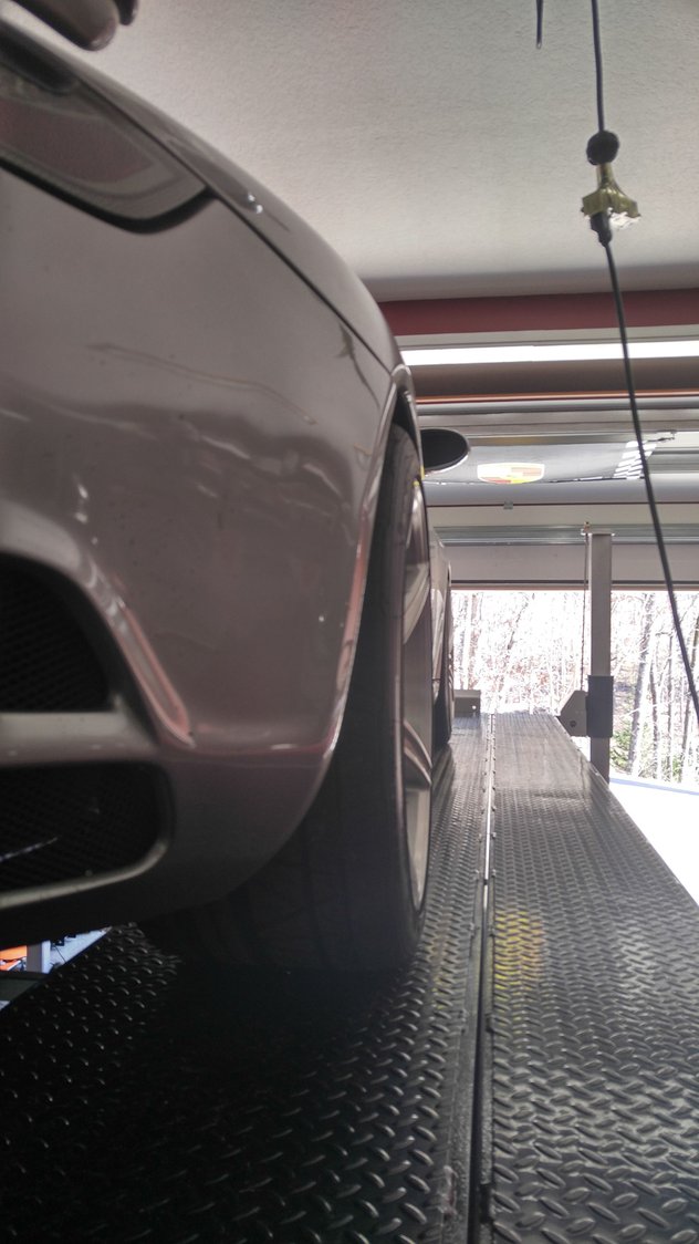

As you know, I also have a NB C2S. The Champion wheels I had on the car had a 62mm rear offset.
Champion RS171 Wheel Specs
Front - 19" x 8.5" with 53mm offset
Rear - 19" x 11.5" with 62mm
The ones you're looking at are a 44. That's 18mm or just about 3/4" further out than this.
These ADV1 wheels were 1/2 narrower in the rear (11" vs 11.5") so 1/4" inside and outside, and with a 52mm offset they are 8mm less aggressive than the ones you were looking at, so the ones you're considering would be 14mm further out than these. I did not like this look at all and pulled them off after about 2 weeks.
Model ADV05 Mv1 SL (forged 1 piece lightweight)
19x8.5 with 42mm offset
19x11 with 52mm offset
Look past the fronts (which were even worse) to the rears.
Conclusion - no, those won't fit well.
Also, personal opinion of course, but that deep fish wheel with polished lip looks very late 80s to me and the 997 is too modern looking for that look.
BTW, my Champions in picture #1 are for sale, but in there polished and clear powdercoated state.
Old ad is here with pics - https://rennlist.com/forums/parts-ma...ls-for-nb.html
