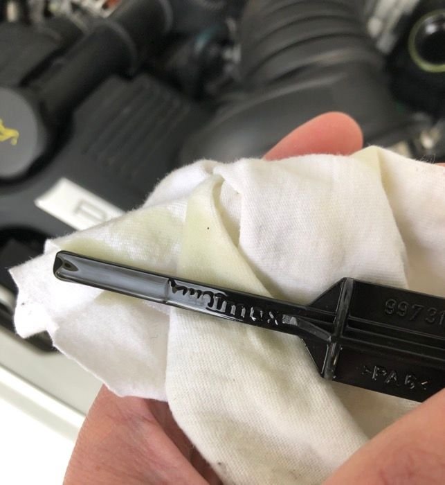

I am new here, i just recently picked up an '07 C2S and have noticed at low speed (when pulling into and out of garage) that there is a LOT of groaning noise from the front end of the car.
I suspect power steering as i don't really hear it at speed and i don't feel anything through the wheel (as i imagine i would if it were binding shock strut bushings).
After doing some searching on this forum and the general interwebs it seems like LOW fluid level could cause this noise due to air in the system.
So, i did a check. Stone cold (engine off for over 24hrs) and started the engine up, let idle for 20-30 seconds, then shut off, and checked level of PS fluid.
Both times, i got a fluid level that was above the indicator, both for cold and hot (meaning overfilled) ... see below photo.

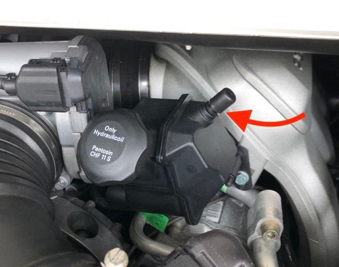

  3. How best to remove excess PS fluid from reservoir ? (i assume it has something to do with this 'port' on the upper right of the res)

dollar store turkey baster. My overfilled tool of choice.
even a straw, with your thumb overt the end? dip in, thumb over end, lift out, release in a cup, repeat.

Hah, okay, so right down into the fill opening... no need for the side-port to draw fluid out.
I've got a turkey baster that can be deployed on this ... thanks

Pulled about 3/4 cup of PS fluid out to where it read properly on dipstick... PO must not have understood how to properly fill.
Now the noise is gone !
Cheers !
