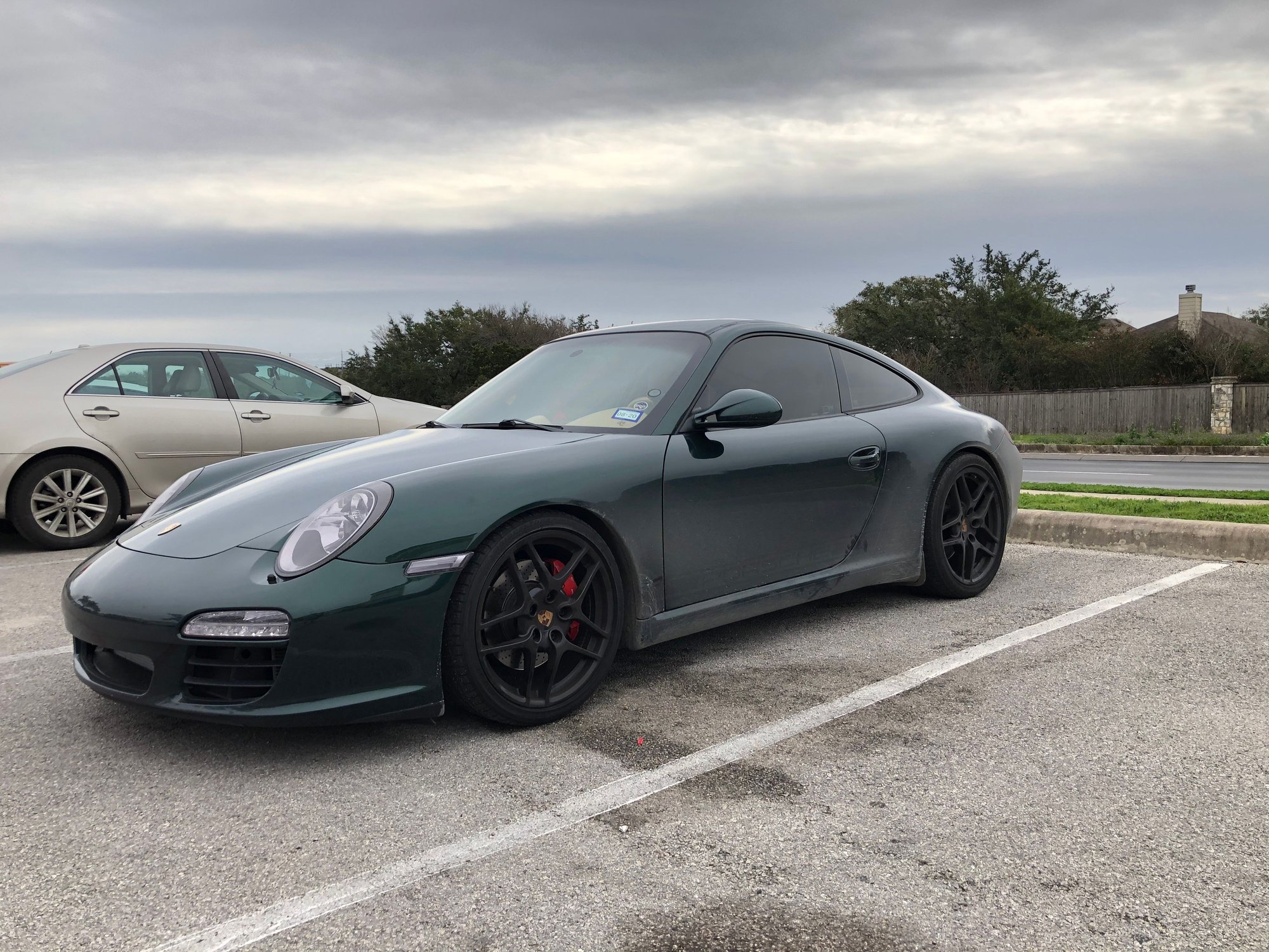

Here’s a reference photo of my car as it sits now. Gap is ~1 finger width all around. I didn’t want to go any lower than that because I wanted to ensure alignment would remain within OEM spec, and I’m running spacers (+7mm front / +15mm rear) and didn’t wanna risk any rubbing.
