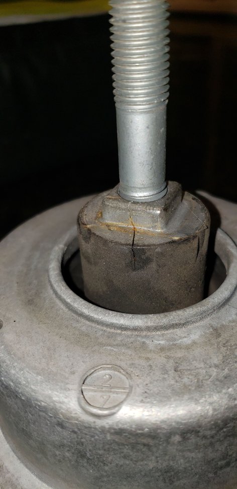

My current 997 is a convertible and I used the coupe mounts. Exact same dimensions and fit same with original mount.
I am glad that I did not wait for Porsche to get the cab mount. Mine actually cracked and it can let go anytime.
