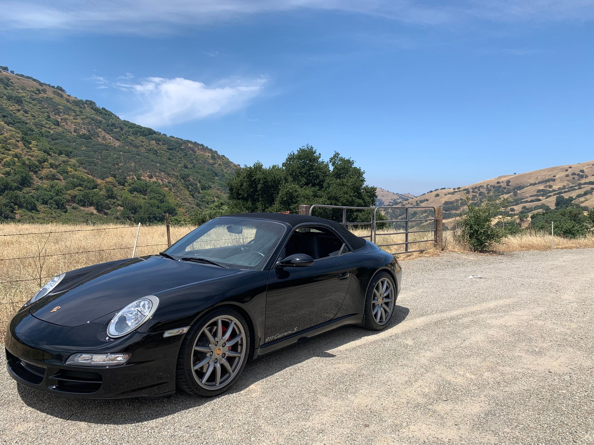

I got the RSS motor mounts this afternoon thanks to amazon prime.
This morning I took a drive to Livermore down Mines rd to get a baseline before the RSS mounts. This is also the 1st time down this this road with the DSC controller on my car with Eibach springs. I’ve had the DSC controller about 3 weeks driving in normal conditions where I’ve noticed it’s smoother overall. The DSC really sines on tight curvy roads. So much more control, balance, and grip in corners and stability in straights. Feels like the car has been transformed, impressive. Car has more capability than I, where as before It felt like I was hitting some of the limits. Can’t wait to get back out there.
Back to the RSS mounts. Installed and went on a drive through city and residential streets, I can notice some new sounds, tones, and rumbling under certain RPMs and throttle position. BUT, I have to pay attention to notice it. It’s subtle difference in NVH. I can hear a winding down sound after revving to 6k, and some gruntness when taking off from a start. I was looking for more sportiness and generally that’s what it’s done. Nothing extreme at all.
In terms of driving feel I can’t notice much yet. Maybe it feels more tight and firm, but hard to judge on this drive. I’ll see if there is a improvement in what already felt good on my next drive in the twisties. So far so good 👍🏼
